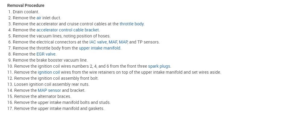

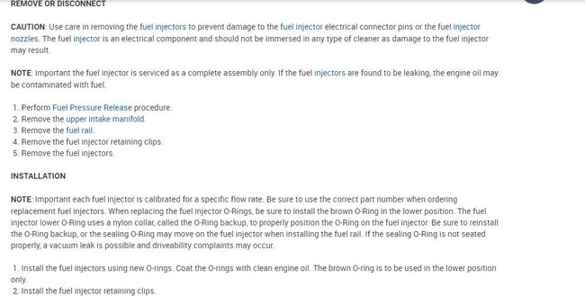

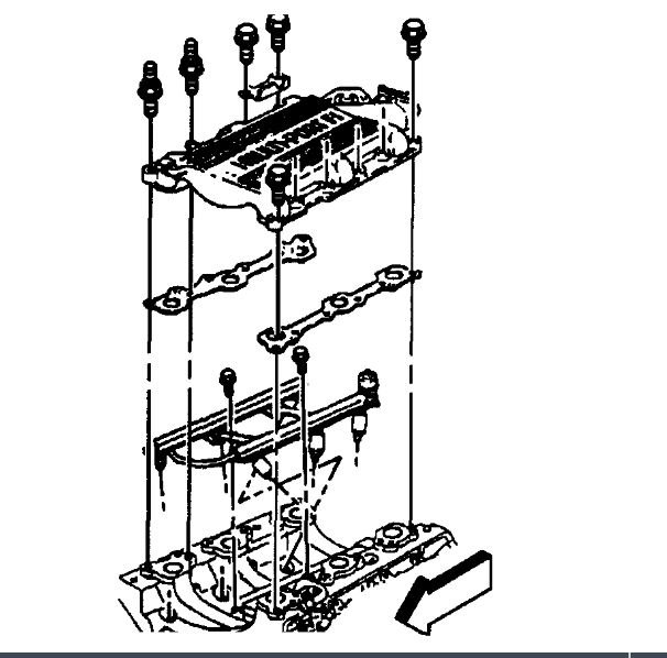

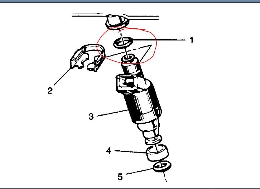

I would remove the fuel rail completely and change the o-rings. The o-rings that need to be replaced are where the injectors meet the rail, not at the intake manifold. Fuel will not leak from there.
I attached pictures and the one where I circled the o-rings is the ones you need to replace.
Jan 20, 2020 at 4:31 AM

I did that. I got all new ones and they are squirting out everywhere all over the bottom part of the manifold.
Jan 20, 2020 at 2:57 PM
MICHAEL LECONA III
  • 18 POSTS
But yeah, it leaks from the top where you circle it.
Jan 20, 2020 at 2:59 PM

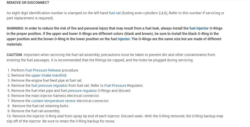

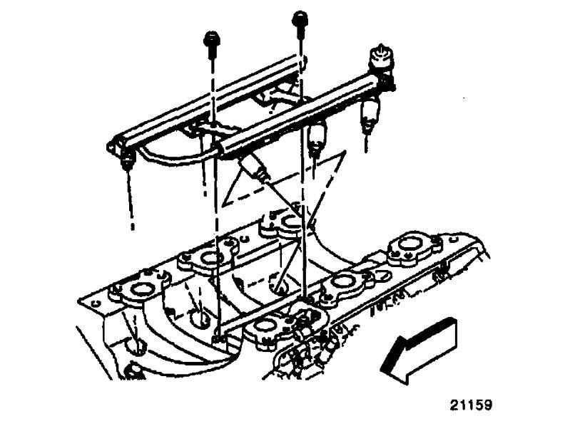

Okay, that is what I thought.
You need to remove the fuel rail from the car and do this on a bench. You remove the clip that is shown in the picture and the injector will come out.
When installing the new o-ring, use Vaseline to lubricate the o-ring so it does not get damaged when you push it up and in. Then reinstall the clip to hold it.

No, I think you may have damaged the o-rings if you did not lube them and make sure they were seated.

Okay, so you do not have it apart. Remove the rail and get a new set of o rings and let me know what you see.
If you can, upload some pictures of what you see.
