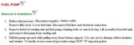

How do I find it? What does it look like?
Friday, June 26th, 2009 AT 3:11 PM
BLUELIGHTNIN6
MECHANIC
16,542 POSTS
It is located inside of fuel tank. Perform operations below to replace it. .
