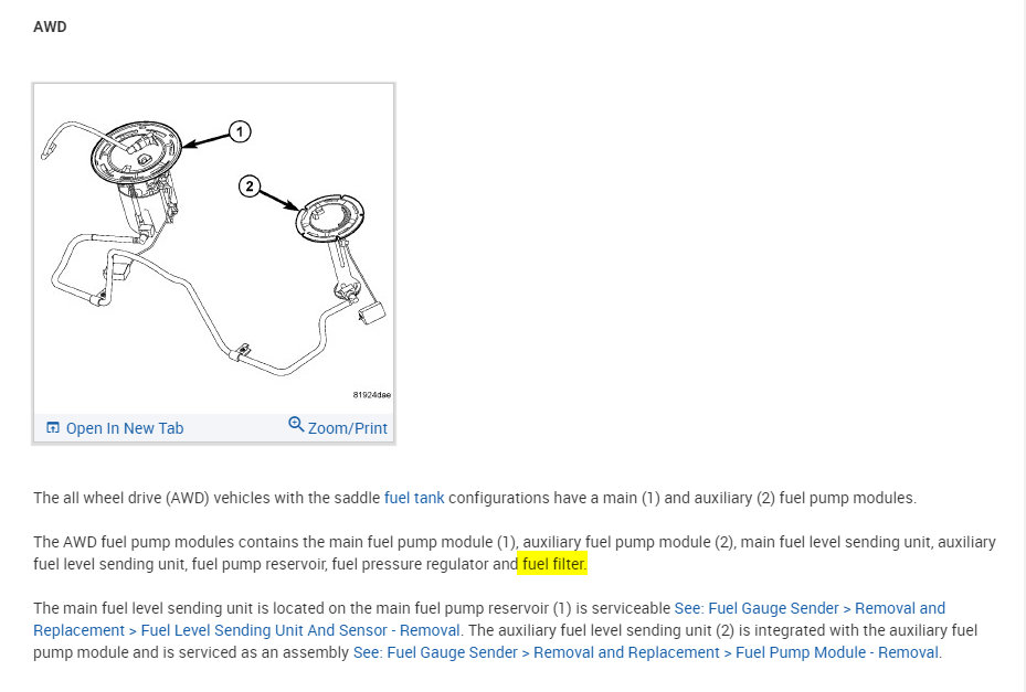

I put fuel injector cleaner in my gas tank and filled it like you’re supposed to and now it won’ start. I have changed the fuel pump, all spark plugs and have checked the battery and cables and they’re all good. I need to know the location of the fuel filter because i have no idea where it is. also please help me figure out why it won’t start. i can’t keep spending money on it all.
Oct 12, 2020 at 5:53 AM
Is there any history to this or did it not start as soon as you put this additive and fuel in it? Were you at the fuel station when you put it in and fill it up and then it would not start or was there some time that went by?
Next can you tell us what product you used? Can you get a picture of it so we are sure we know what you put in there?
As for the fuel filter, that is part of the fuel pump and it does not need to be replaced unless there is another issue.
Lastly here is a guide that will get us started on this issue but let's answer all these questions first. Thanks

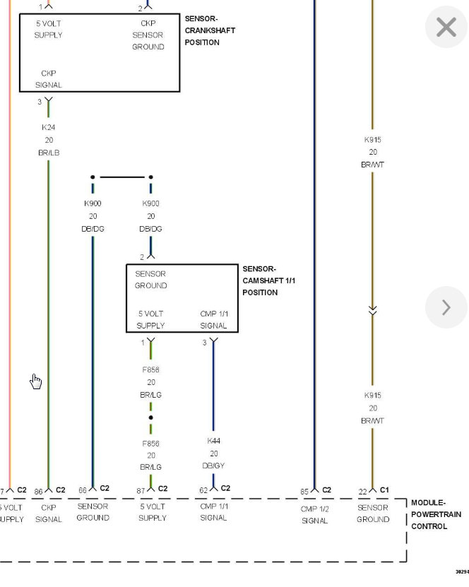

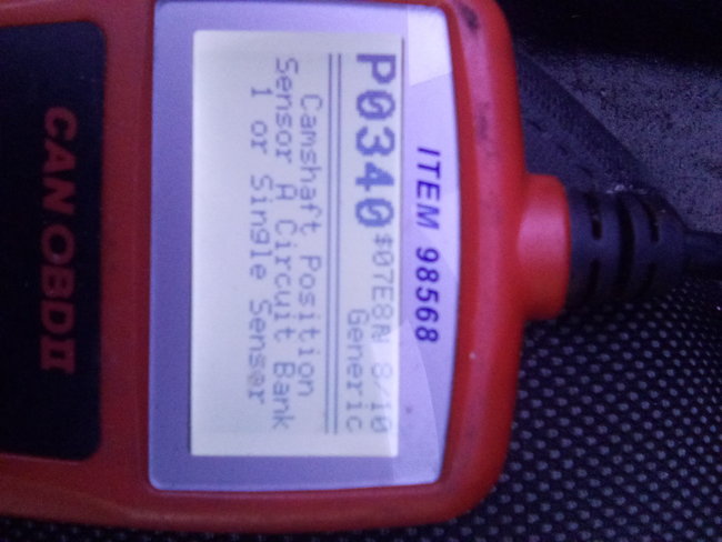

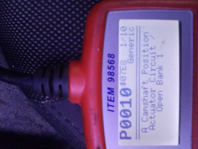

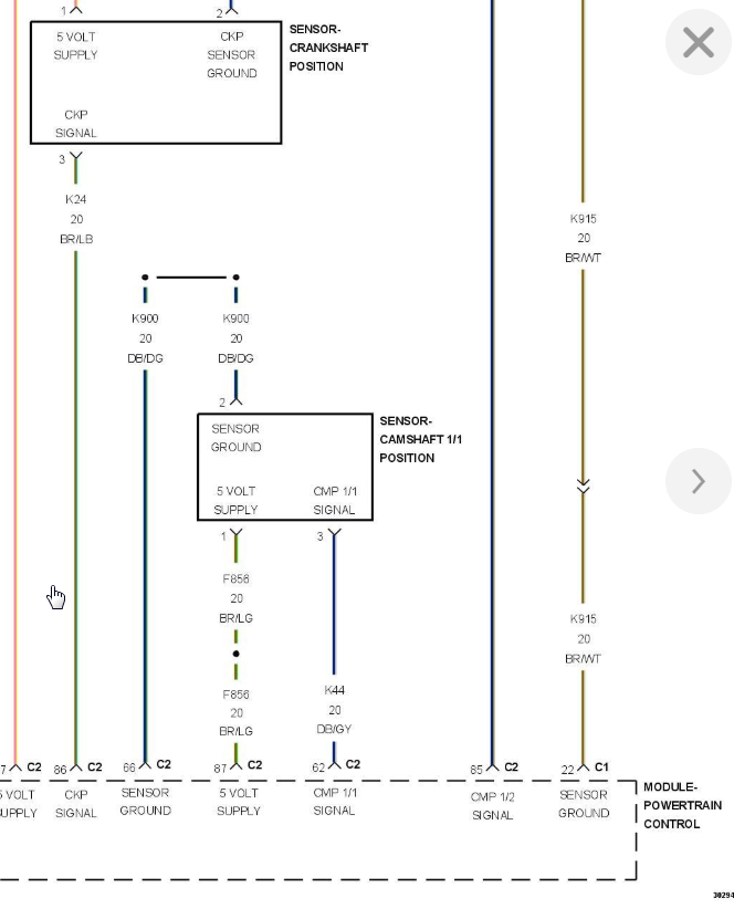

AMY1977

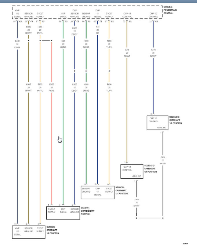

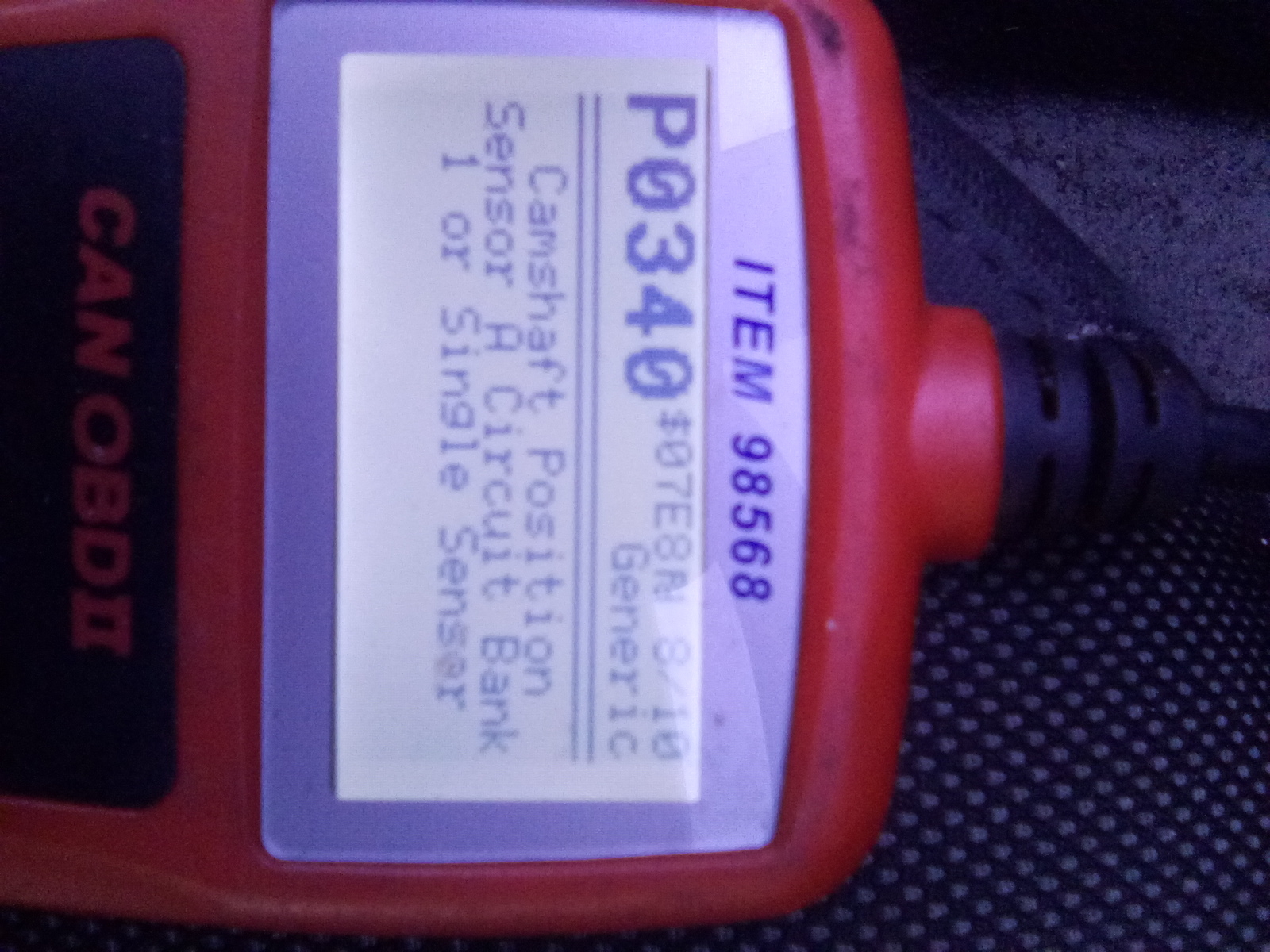

I was driving home from work at about 60 MPH car started losing power gauges flipped back and forth. Reminded me of diesel that ran out of the fuel. pulled over car shut off, will not start but cranks. All fuses are good
I've changed both cam sensors, crank position sensor and spark plugs car is getting fuel but no spark at the coil packs. Timing chain is very tight.
I must add car was running great this was a sudden break down with no warning. also cam sensor on B side was melted to bolt that holds it in. Wiring connector didn't show any damage and is receiving power by a test light.
Jan 25, 2021 at 5:39 AM (Merged)

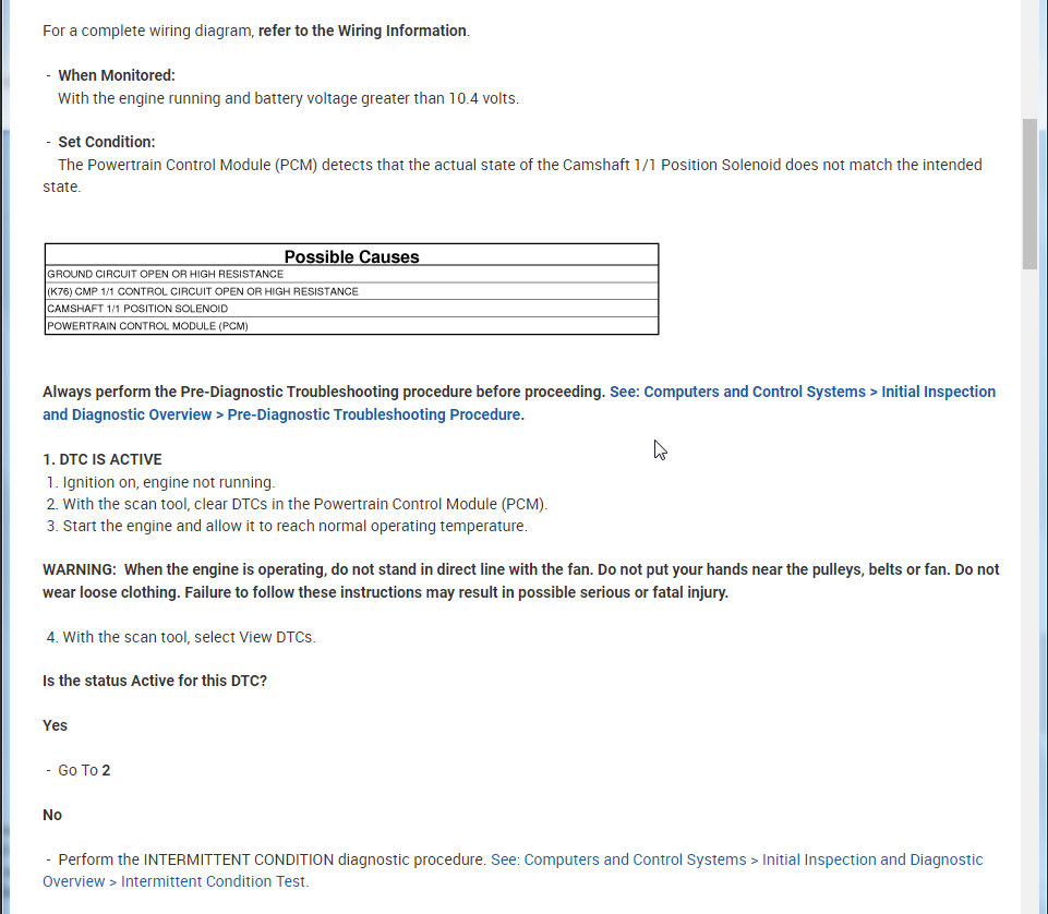

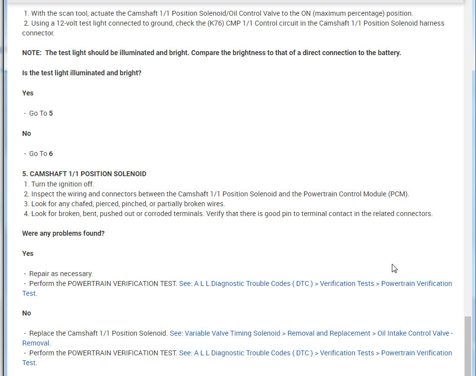

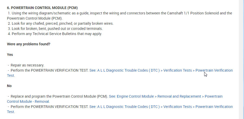

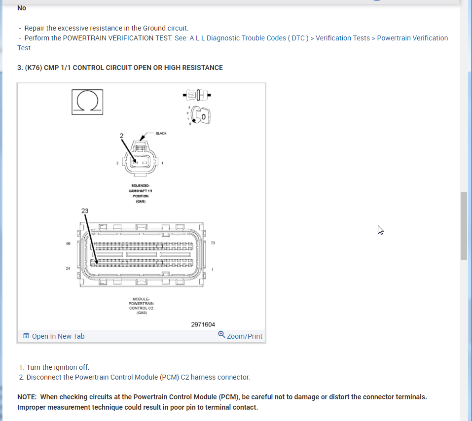

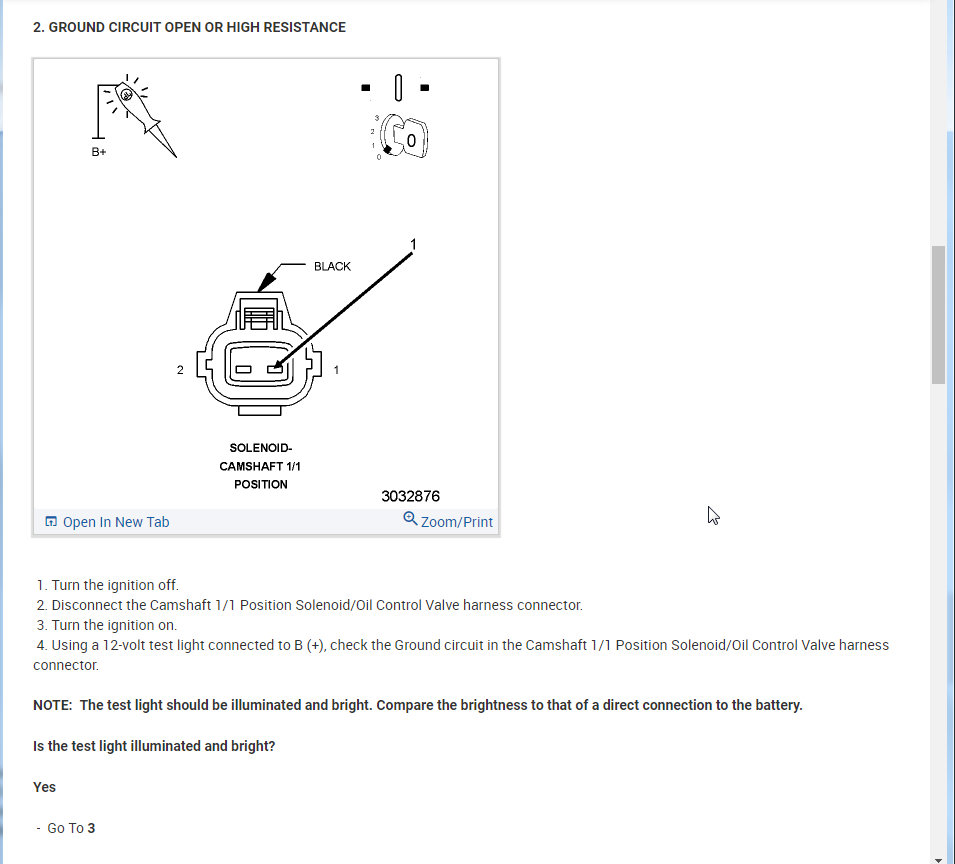

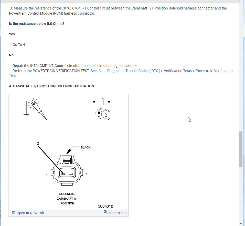

More then likely you have a wiring issue as both cam codes are pointing to that.
So let's start with the P0010 code which I attached the info below on what we need to do.
Here is a guide that will help with this type of testing:
The fact that you found an issue on one of the sensors I suspect we have more damage there we just have not found it yet.
Let's run through this testing and we can go from there.

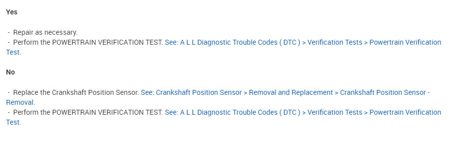

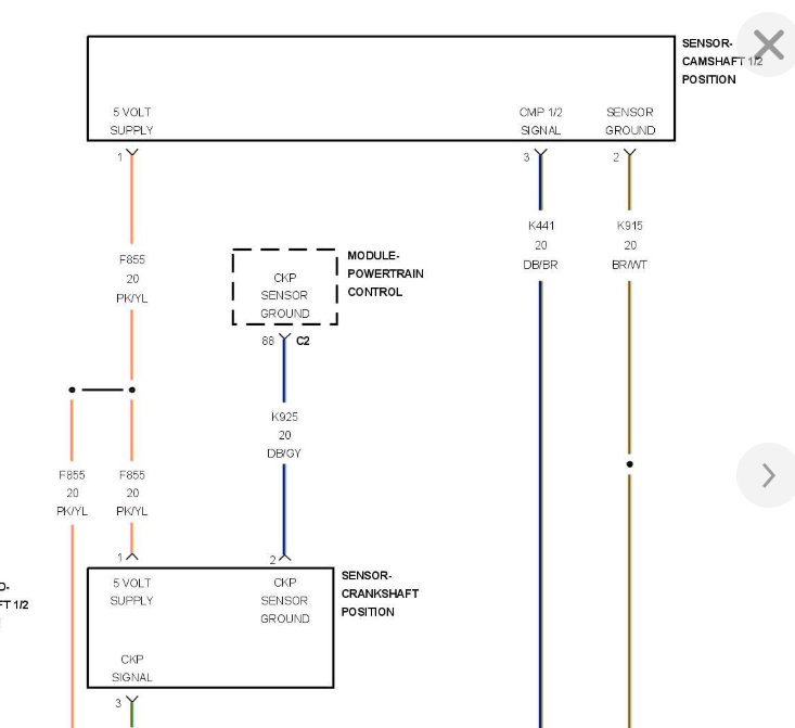

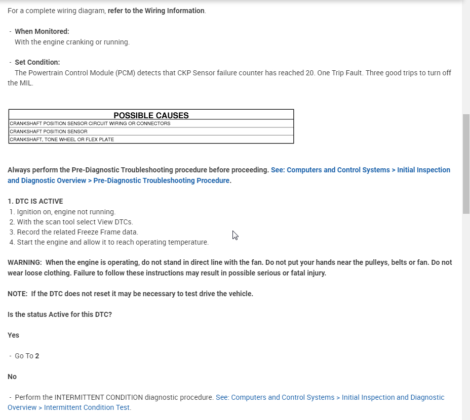

CURTISCHUNN
  • 5 POSTS

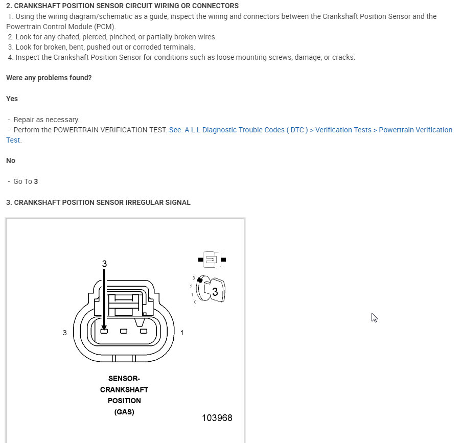

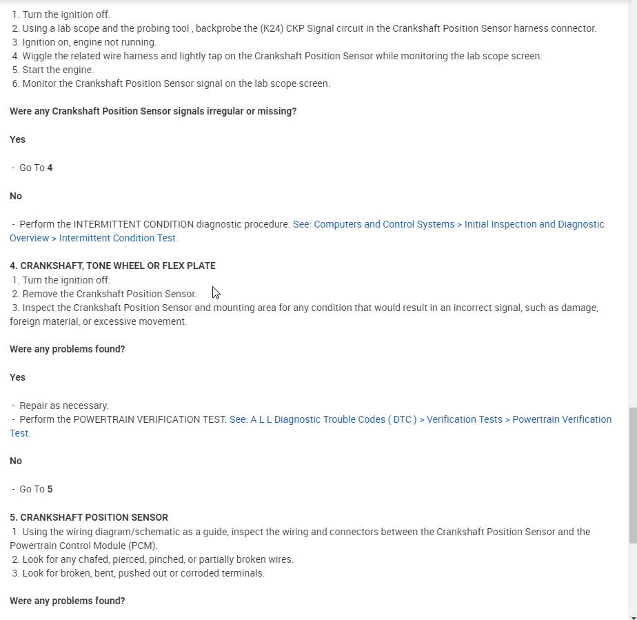

Car stalled but was able to drive 2 miles back to home. MIL was on with P0339. I purchased a crank sensor and car would not start so i put old sensor back in. car would crank but stalled again so i purchased a third sensor. car ran for two days then it would not start in mornings but would start in evenings (not making this up). now it will not start, some times MIL is on with P0339 and later same day without starting MIL would be off, still will not start.what is my chance of three bad sensors?
Jan 25, 2021 at 5:40 AM (Merged)
It is unlikely that you got three bad sensors. The starting in the evening and not morning makes me think you have a wiring issue. In the morning there is more humidity and moisture in the air so compromised wiring will not carry and good signal. I attached the testing for this but if it were me, I would run new wires from the PCM to the CKP sensor. You should be able to get a new connector for both the sensor and PCM so that you can replace the entire circuits. Just use the connector pigtails and then connect a new wire between the crank sensor and PCM on the two circuit (PIN 2 and 3 on the CKP). Then just run a new wire to the 5 volt source and you will be good to go.
http://connectors.dcctools.com/home.htm
The only other logical cause would be a tone wheel that is cracked but again this would not care if there is moisture or not so it would not be as intermittent. It is worth checking but my money would be on the wiring.
Let me know what you find. Thanks
