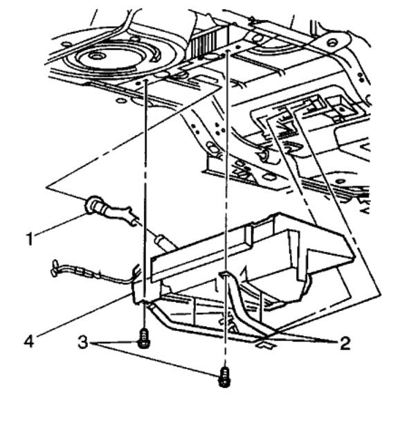

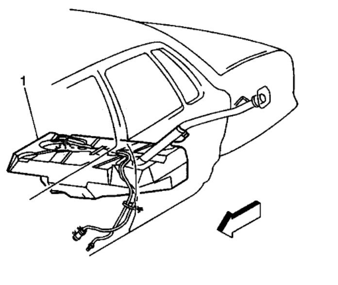

Car sputters and stops running when gas pedal is pressed. Can hear fuel moving around when driving.
Jun 27, 2017 at 10:57 AM
  • 55,770 POSTS
It sounds like you have a fuel pump that is going out. Here is a test you can do to confirm.
and can rent a fuel gauge from the auto parts store for free if you don't have one.
https://www.2carpros.com/articles/how-to-replace-an-electric-fuel-pump
Please run this test and get back to us we are interested to see what it is.
Here is what its like to change the pump on your car (below)
