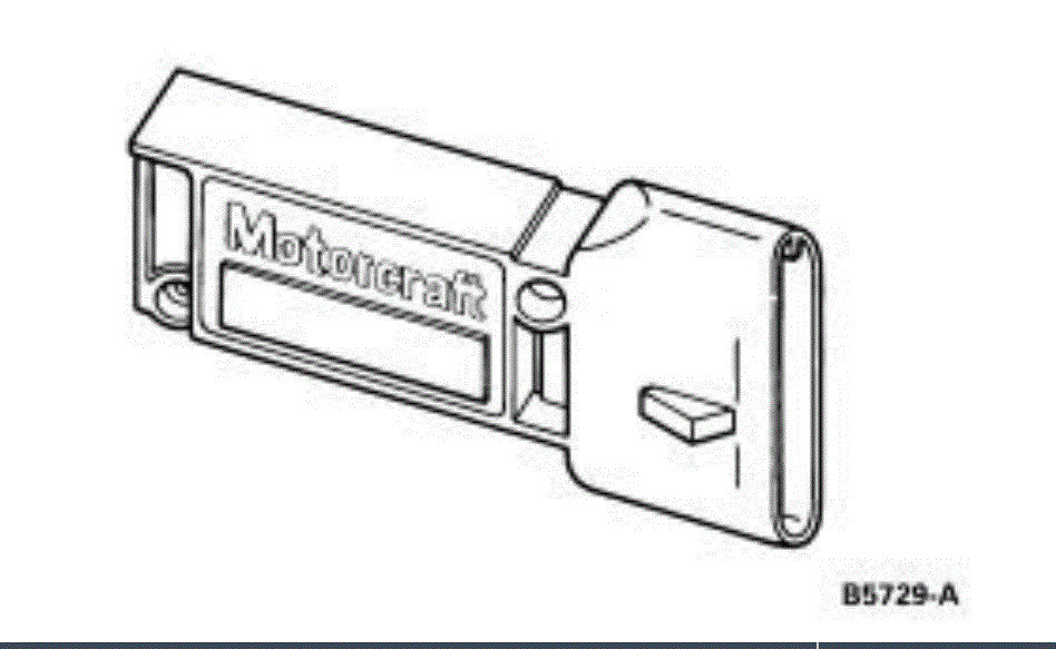

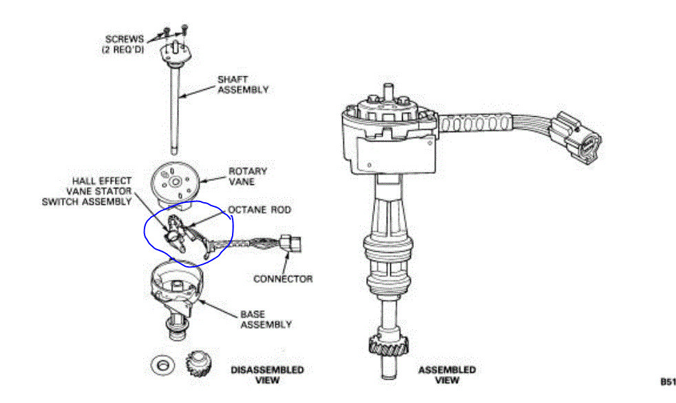

I would suspect the ignition module or the pick up coil in the distributor.
Removal
1. Remove two screws retaining ignition control module heatsink assembly to left fender apron.
2. Disconnect harness connector from ignition control module .
3. Remove two screws retaining ignition control module to heatsink and remove ignition control module .

Is there a way to test or do you just wing it? inni mini mini mo it which one. would you try first? lol

Do you have spark at the plugs? If you do not, then you need a coil. The module and pickup are working.
