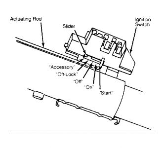

I think it's probably the ignition switch .. ford have for a long time had a fault with these ? I don't know if this description will help it's describing the removal on a 85 model .. my manuals don't go back any further i'm afraid ?? hope it helps
Removal (Bronco, Econoline/Club Wagon, "F" Pickup)
Disconnect battery ground. Remove steering column shroud and lower column. Disconnect switch wiring at multiple plug. Remove nuts securing switch to steering column. Lift switch vertically to disengage actuator, and remove switch.
Fig. 2: Rod-Actuated Ignition Switch
https://www.2carpros.com/forum/automotive_pictures/266999_lock_7.jpg
Installation
With lock cylinder and switch in "LOCK" position, engage actuator rod in switch. Position switch on column and install retaining nuts, but do not tighten. Move switch up and down along column to locate mid-position of rod lash, and tighten retaining nuts.
