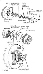

MOMAKO12
  • 1994 FORD EXPLORER
I am following the instructions in the Chilton's manual to replace the front wheel bearings and am having trouble removing the rotor. I can't seem to find the cotter pin
Friday, December 25th, 2020 AT 9:39 AM (Merged)
BMRFIXIT
  • 19,053 POSTS
4x4 has no cotter pin
check the fig. Check out the diagrams (Below). Please let us know if you need anything else to get the problem fixed.

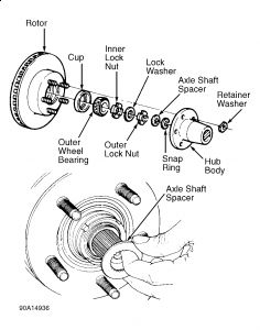

1234BUBBIE
Tires and Wheels problem
1994 Ford Explorer 6 cyl Four Wheel Drive Automatic
how do you replace front wheel bearing?
BMRFIXIT
  • 19,053 POSTS
https://www.2carpros.com/forum/automotive_pictures/99387_Graphic1_259.jpg
https://www.2carpros.com/forum/automotive_pictures/99387_Graphic2_121.jpg
