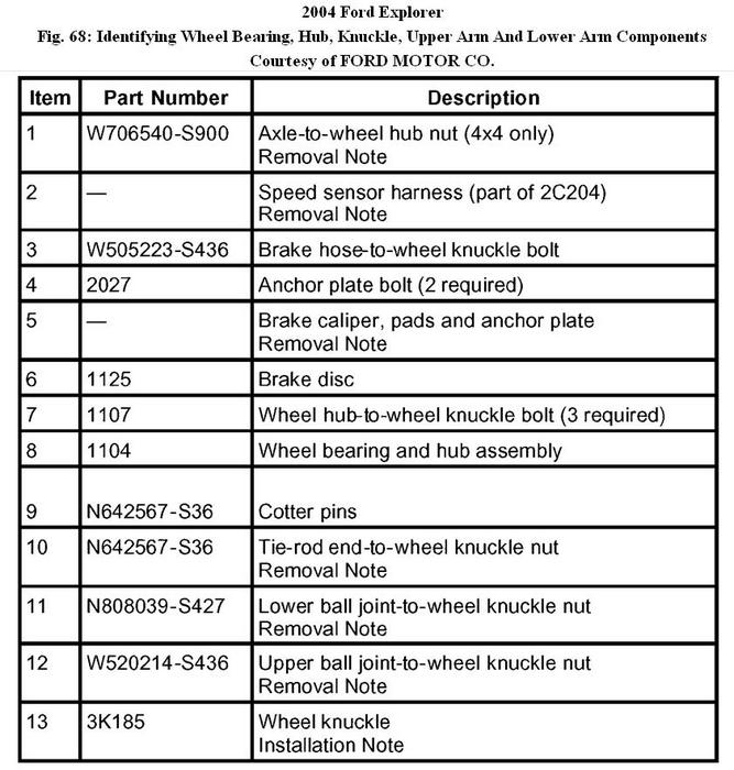

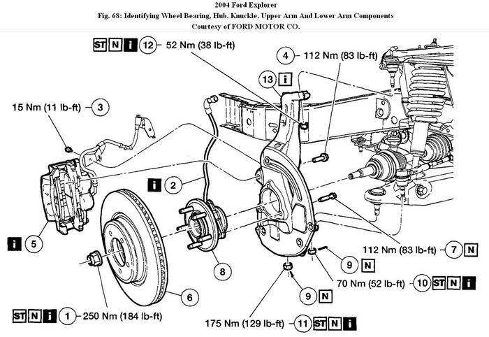

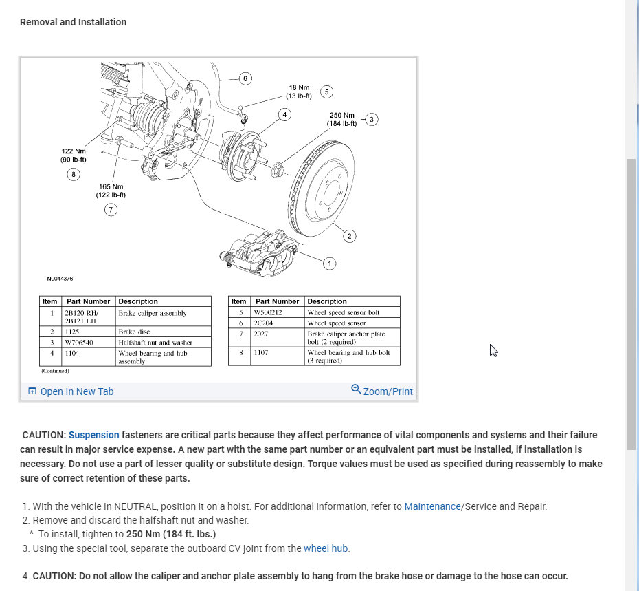

KHLOW2008
  • 41,814 POSTS
Here are the procedures, you decide if it is easy or not.
Removal and Installation

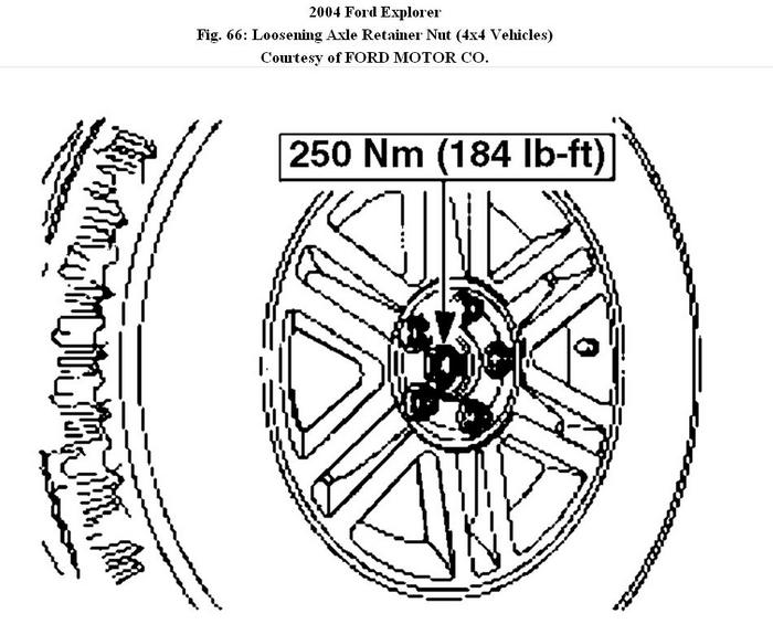

1. On 4x4 vehicles, loosen the axle retainer nut.
Fig. 66: Loosening Axle Retainer Nut (4x4 Vehicles)
NOTE:

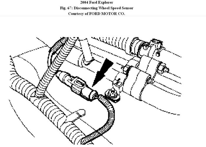

The wheel speed sensor electrical connectors are located in the engine compartment secured to the fender aprons.
Fig. 67: Disconnecting Wheel Speed Sensor
2. Disconnect the wheel speed sensor.
3. Remove the wheel and tire assembly.
4. To remove wheel bearings, carry out steps 1 to 8.
5. Remove the components in the order indicated in the following illustration and table.
Fig. 68: Identifying Wheel Bearing, Hub, Knuckle, Upper Arm And Lower Arm Components
To install, reverse the removal procedure.

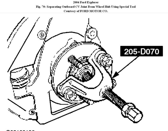

Item 1: Axle-to-Wheel Hub Nut Removal Note
1. Remove the nut and, using the special tool, separate the outboard CV joint from the wheel hub.
Fig. 70: Separating Outboard CV Joint From Wheel Hub Using Special Tool

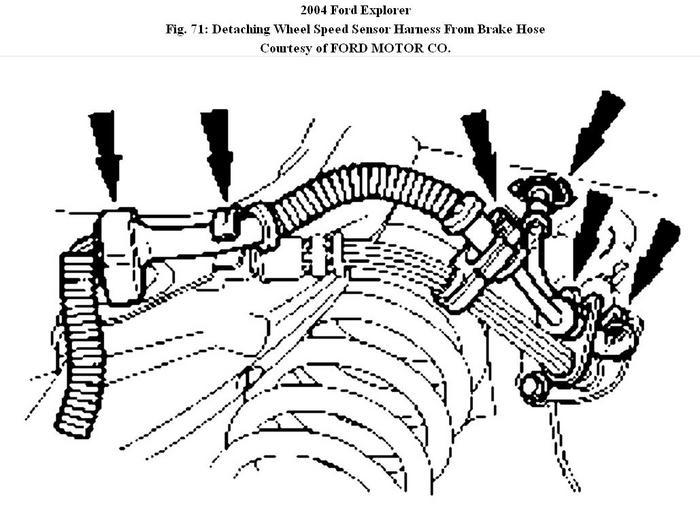

Item 2: Speed Sensor Harness Removal Note
1. Detach the wheel speed sensor harness from the brake hose.
Fig. 71: Detaching Wheel Speed Sensor Harness From Brake Hose

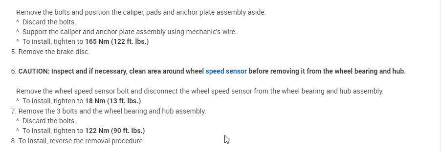

I recently replaced my front wheel bearing (hub assembly and all) part cost $185.00 and took me (not a mechanic at all!!!) about 3 hours.
All I did was:
-remove the wheel
-remove the brake pads
-remove the caliper (two bolts)
-remove a mounting bracket (two bolts)
-remove the hub (three bolts)
*the old bearing took some pounding to get out once the bolts were out, which were the biggest pain. I reccommend heating the bolts because there is lock-tight substance on the threads which made them very difficult to remove.
-clean the space where the old wheel bearing/hub come from
-inserting the new wheel bearing/hub
-put back together.
I am not sure if its the same on your 04' and since you have a 4x4 it may be different. if not, its not too painful to do.
hope this helps

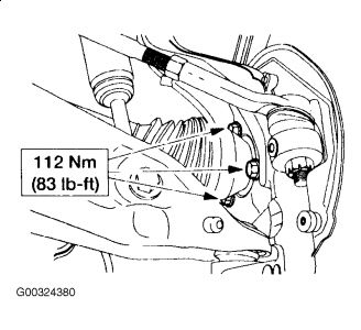

Wheel bearings are not adjustable. The wheel bearings and hubs are serviced as an assembly. Its an easy job the only hard thing would be removing axle nut this is what I have for step by step HUB & BEARING Removal & Installation Remove and discard the axle-to-wheel hub nut. Disconnect the Anti-Lock Brake System (ABS) wheel speed sensor connector located in the engine compartment, secured to the fender aprons. Raise and support vehicle. Remove the wheel and tire assembly. Detach the speed sensor wiring harness from the retainers. Remove the bolts and position the brake caliper and support bracket aside. Do not allow the disc brake caliper to hang suspended from the brake hose. Provide a suitable support. Remove the brake disc. CAUTION:Do not overextend the CV joint and boots when removing the wheel hub. Using the Front Wheel Hub Remover (D93P-1175-B), press the outboard CV joint until it is loose in the hub. See Fig. 1 . Remove the three hub bolts and discard them. See Fig. 2 . Remove the wheel hub and sensor as an assembly. Apply a thin coat of Silicone Sealant (F7AZ-19554-EA) to the wheel hub mounting surfaces before installation. To install, reverse the removal procedure. Install NEW fasteners where necessary. Tighten all nuts and bolts to specification
https://images.2carpros.com/forum/automotive_pictures/99387_Graphic1_414.jpg
https://images.2carpros.com/forum/automotive_pictures/99387_Graphic2_196.jpg

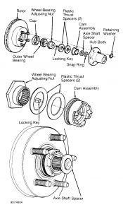

The front wheel bearings I found listed for your vehicle are of the older tapered design. For those, the axle nut must not be tightened as I just described for the bolt-on style. In fact, one of the causes of early failure is over-tightening them. That puts so much force on the rollers that they squeeze the grease out as they rotate. The metal-to-metal contact between the rollers and the "races" they run on leads to rapid wear and often overheating.
Once a bearing becomes noisy, adding grease won't help. Small bumps or indentations have developed on those highly-polished races. The buzzing noise comes from the roller bearings running over those bumps.

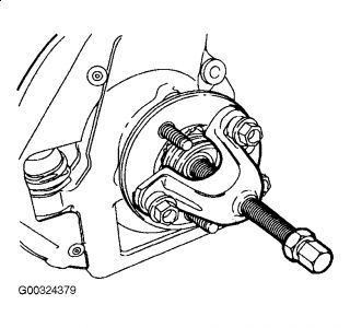

Raise and support vehicle. Remove wheel assembly. Remove and discard hub nut and washer. Remove brake caliper and brake caliper bracket assembly. Remove brake rotor retaining screw (if equipped), and remove brake rotor. Remove 3 brake rotor shield retaining bolts, and remove brake rotor shield. Remove ABS sensor retaining bolt, and disconnect sensor.
Remove 3 wheel hub retaining bolts, and remove wheel hub and bearing assembly. DO NOT over-extend CV joint. Slide hub and bearing assembly off of CV axle shaft splines. CV joint should slip fit into wheel hub and bearing assembly and should not require puller to remove. Remove steering knuckle grease seal. Inspect steering knuckle grease seal, hub and bearing assembly for excessive wear and damage. Replace components as necessary.

Using Bearing Cup Replacer (T80T-4000-P), Knuckle Seal Replacer (T96T-1175-A) and Threaded Drawbar (T77F-1176-A), install seal until it seats against steering knuckle. Connect ABS sensor to wheel hub and position wheel hub assembly onto axle shaft and knuckle. Install hub retaining bolts and tighten to specification. See TORQUE SPECIFICATIONS . Install NEW washer and hub nut, and tighten to specification.

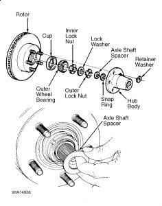

I am following the instructions in the Chilton's manual to replace the front wheel bearings and am having trouble removing the rotor. I can't seem to find the cotter pin
Dec 25, 2020 at 1:39 AM (Merged)
BMRFIXIT
  • 19,053 POSTS
4x4 has no cotter pin check the fig. Check out the diagrams (Below). Please let us know if you need anything else to get the problem fixed.
https://images.2carpros.com/forum/automotive_pictures/99387_explorerw_1.jpg

how do you replace front wheel bearing?
BMRFIXIT
  • 19,053 POSTS
https://images.2carpros.com/forum/automotive_pictures/99387_Graphic1_259.jpg
https://images.2carpros.com/forum/automotive_pictures/99387_Graphic2_121.jpg
