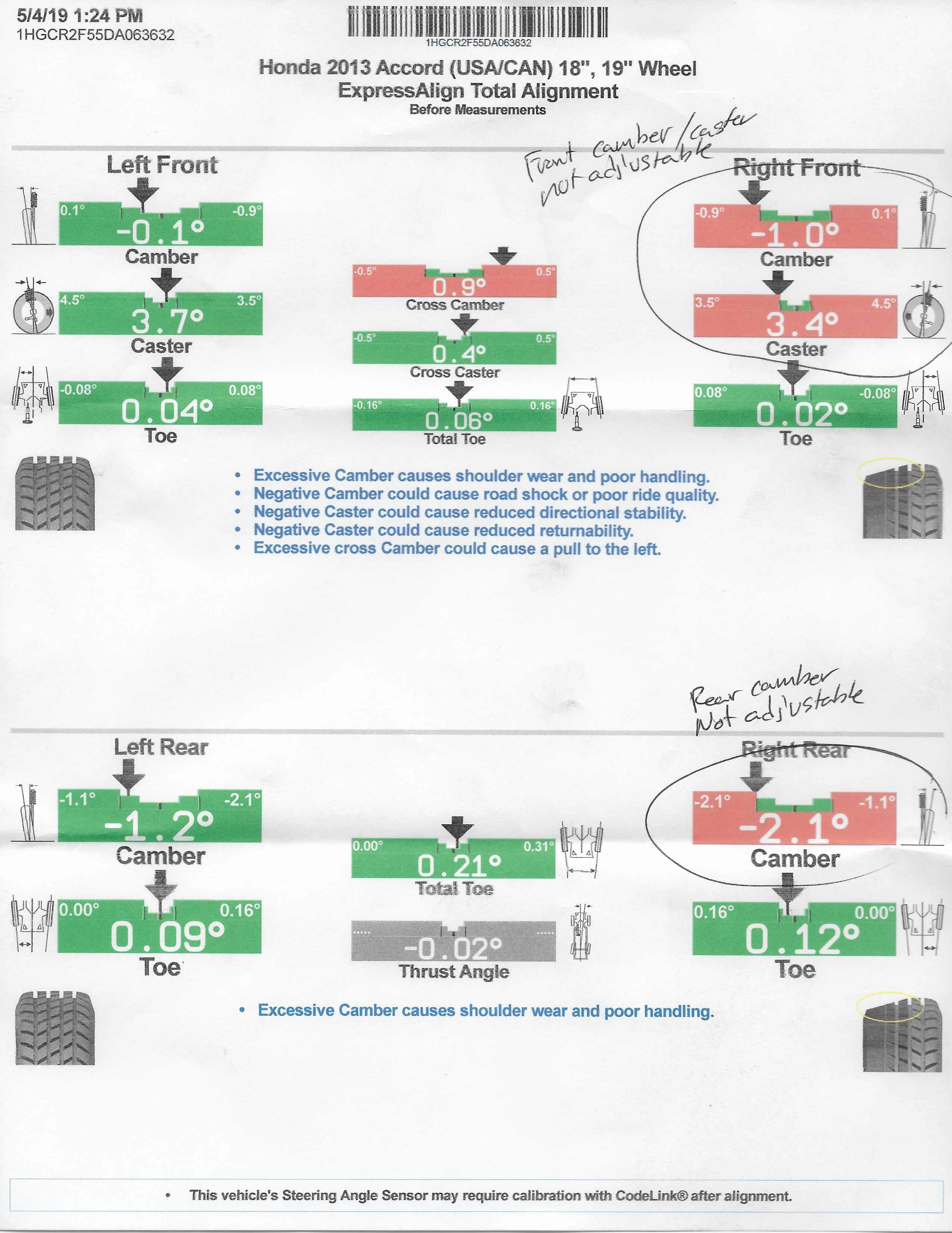

Hi, what parts would I have to replace to make the alignment correct or would a new part fix it? Is this a common problem with Honda? Is there another way to get the alignment to specs? I purchased the car with 12,000 miles on it with no accidents reported. Anything you can tell me to explain this situation. I'm in my sixties so it has not been abused like my cars were when I was young. Thanks for all you help.

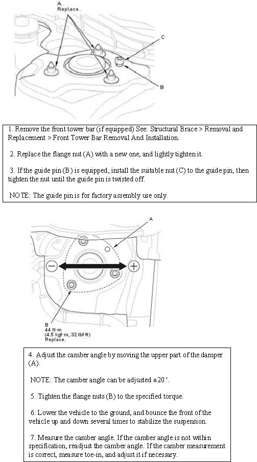

Front camber can be adjusted, but it is a rather tedious procedure that most alignment specialists prefer to avoid. Also, it changes a lesser-known secondary alignment angle called "steering axis inclination", (SAI) on just that side. SAI has no exact specification except that it must be exactly the same on both sides to maintain balanced handling and steering. Many specialists don't want to upset that balance by making the adjustment the way Honda provided.

Thank you for posting the printout. It shows the front wheels call for negative camber, (leaning in on top). That is done for better cornering, at the expense of long tire life. The negative one tenth of a degree camber pull on the left will cause very little pull to the right, but the minus one degree on the right is going to make that tire pull pretty hard to the left. We also like to adjust in roughly one tenth of a degree pull to the left to make up for "road crown". That is when roads lean to the right so water runs off. It makes cars want to drift to the right too. The slight camber pull to the left offsets that drift. In this case the difference it too much and the car is going to pull to the left. The inner edge of the right front tire will wear out faster too.
Caster is a little more forgiving. That has to do with the angle of the strut, as viewed from the side of the car. Look at the rake of a bicycle fork, and how it leans to the rear at the top. When you put weight on the front tire, that angle causes the wheel to squirt out to the front and is what makes it so you can ride no-handed. On cars, caster makes both wheels want to turn very hard toward the center of the car. Connecting both wheels with the steering linkage causes them to offset each other, and the car goes straight. On older rear-wheel-drive cars, unequal caster also caused a pull, but about half as hard as a camber pull. The important thing to understand about front-wheel-drive cars is caster has almost no effect on pulling, so it is rarely adjustable from any manufacturer. Caster also has relatively little effect on tire wear. Caster causes the wheels to lean toward the direction you're turning, but that mostly applies to parking lots where you don't do much high-speed cornering. At highway speeds, we don't turn far enough for caster to influence tire wear.
Rear camber is not adjustable, so as with Fords, "what you got is what you get". Fixing sagged ride height might solve the camber issue, but could just as likely make it worse. The way to know is to watch the numbers on the alignment computer screen while that end if the car is raised and lowered a little to see what changes occur.
Rear toe is adjustable. That is the direction those wheels are steering. The problem is there are two wimpy control arms that hold the bottom of the wheel in place, and one of those is adjustable in length. Making that adjustment shortens or lengthens that arm to turn the wheel a little, but as it does that, it pushes the bottom in or out too, and that affects camber. The high negative right rear camber means the bottom of that wheel is out too far. The non-adjustable control arm needs to be shorter, and the adjustable one needs to be adjusted shorter to match. No two replacement suspension parts are ever exactly the same, so one replacement arm could make the problem worse.
