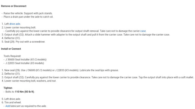

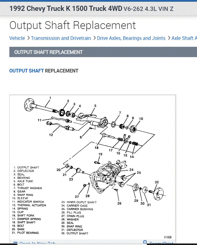

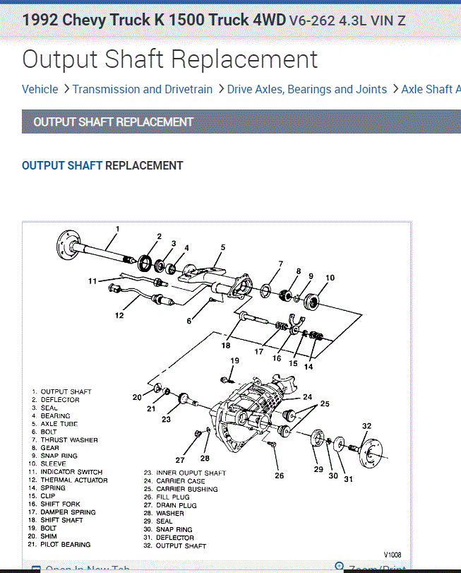

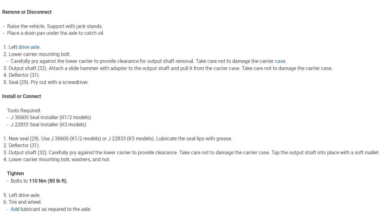

I have replaced the seal, but the output shaft does not want to go back in, it contacts the clip and I am afraid to hit it too hard. I was checking it again. I believe I need to bevel the edge that goes through the c clip.
Jun 3, 2022 at 6:04 AM
  • 110,240 POSTS
You should be able to tap it into place without doing anything to the clip. If you look below, I provided the directions for the removal and replacement of the output shaft.
Take a look through the directions and see if they help. Also, if you are using a rubber mallet, you won't damage it.
