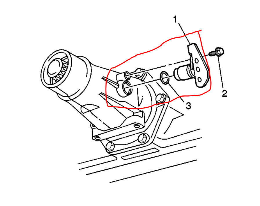

My husband just had to replace his rear differential. It wasn’t having any problem driving before this but now it is only driving in first and second gear. Could it be something simple or do we need a new transmission? Please help.
Oct 19, 2020 at 4:10 AM (Merged)
  • 110,244 POSTS
It is odd that it started only after the differential was replaced. Was it replaced with an exact replacement? In other words, is the gear ratio the same in the new differential?
Since the drive shaft would have been removed, it is possible that by accident, the vehicle speed sensor at the rear of the transmission may have been damaged or disconnected.
Take a look at the picture I attached. It shows the location of the sensor on the transmission. Have him check it. Also, let me know if the speedometer is properly working, and if diagnostic trouble codes have been checked.
I will watch for your reply.

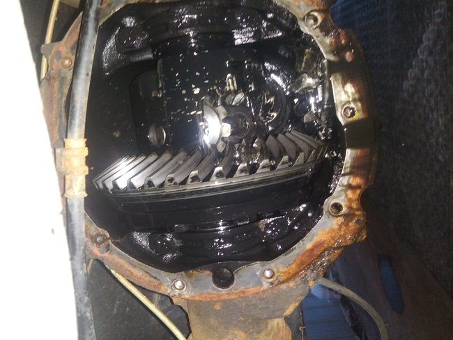

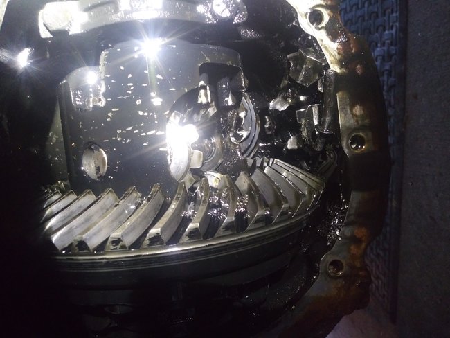

  • 7 POSTS
2 wheel and the gears blew apart.

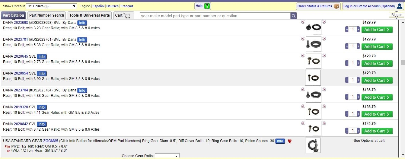

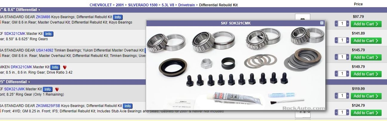

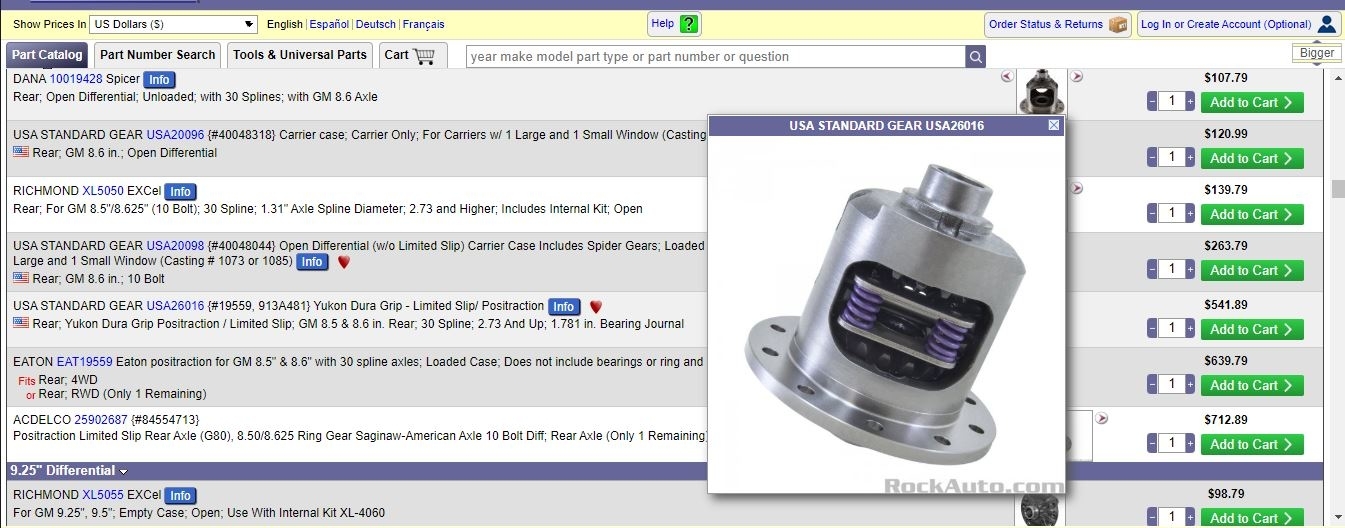

Why do you not just get a new set of gears and a carrier? It would be so much easier to fix what you have than get a used one with no history and possible issues of its own.
I attached the parts for overhauling the unit you have. A posi carrier and a choice of gear ratios.

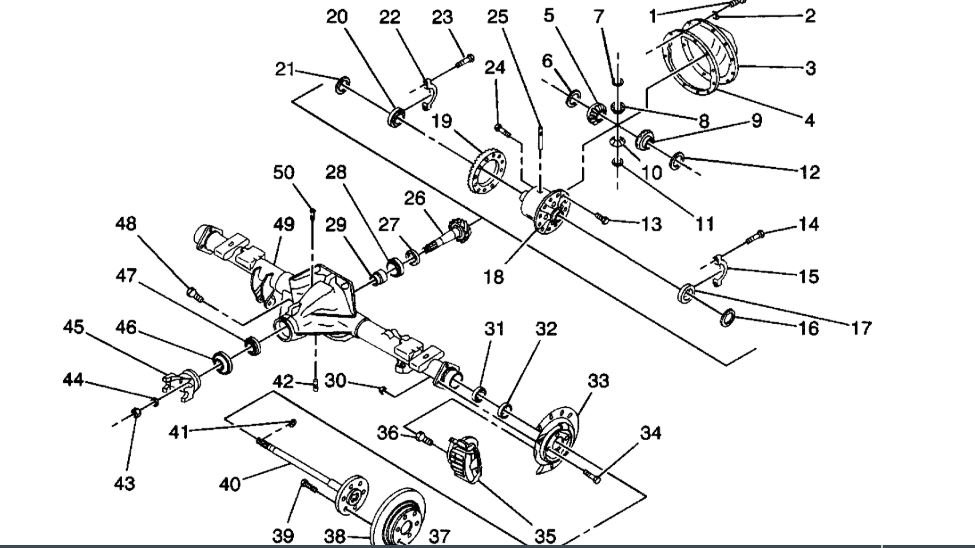

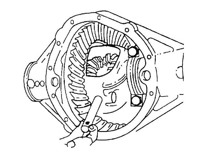

Good evening,
Count the number of bolts on the cover. It should be 10 or 12 bolt.
They have to be the same. If the donor has the same number, then it can be swapped. Make sure you replace the pinion gear as well.
Is your truck a 2 or 4 wheel drive?
https://www.2carpros.com/articles/how-a-differential-works
I attached a exploded diagram for you of the differential.

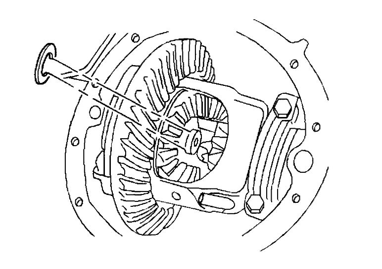

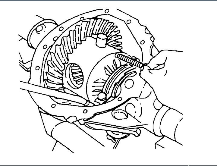

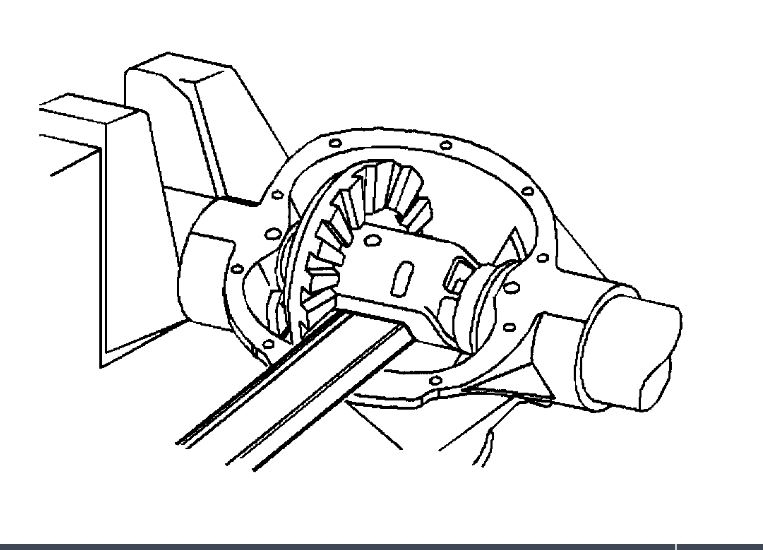

hello i have a question and here it is...im installing a new rear differential carrier into my truck because my old one was shot. i did not take the pinion out and i was told as long as i did that then i didnt need to measure backlash or anything all i had to do was have new side case bearings pressed onto the new assembly and put it back in with the old shims and torque it down and i was told this by a few people so i did this and i put my axles in to turn the differential and it barely turns and it takes alot of strength to turn the axle. i can barely turn the driveshaft as well...help i gotta get this fixed. any ideas? ps everything went back together fine there was no fighting to get it in. the ring gear lines right up with the pinion gear. did i do something wrong? or is it supposed to be really tight cuz my old one wasnt that hard to spin
Oct 19, 2020 at 4:11 AM (Merged)
SCOTTY DEE
  • 592 POSTS
Which rear axle does it have?
• Borg Warner
• Corporate and Eaton
• Dana/Spicer Full Floating Axle
• Timken/Rockwell - 12 Inch Ring Gear
