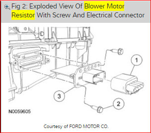

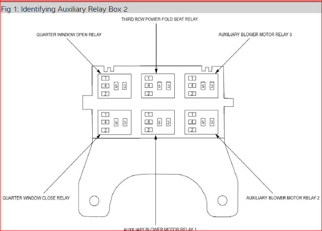

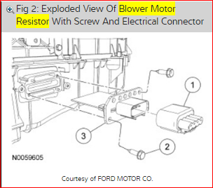

I replaced the blower motor but fan decides to work when it wants to.
Jul 1, 2018 at 5:21 PM
DANNY L
  • 5,648 POSTS
Hello, I am Danny.
It sounds like you are having an issue with either the blower motor relays(2) or the blower motor resistors(2). I have attached a few pictures of what they look like and a tutorial on how to test a relay. If you want to test these yourself I can send you a few test diagrams. Hope this helps and let me know if you have any further questions.
