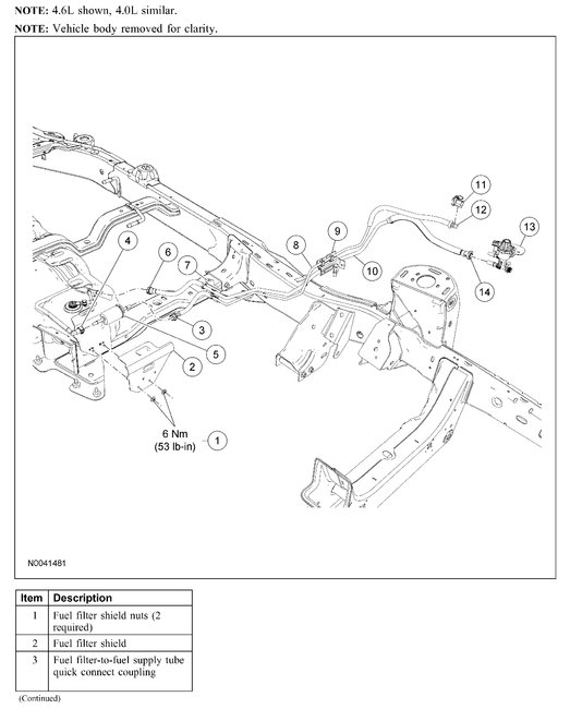

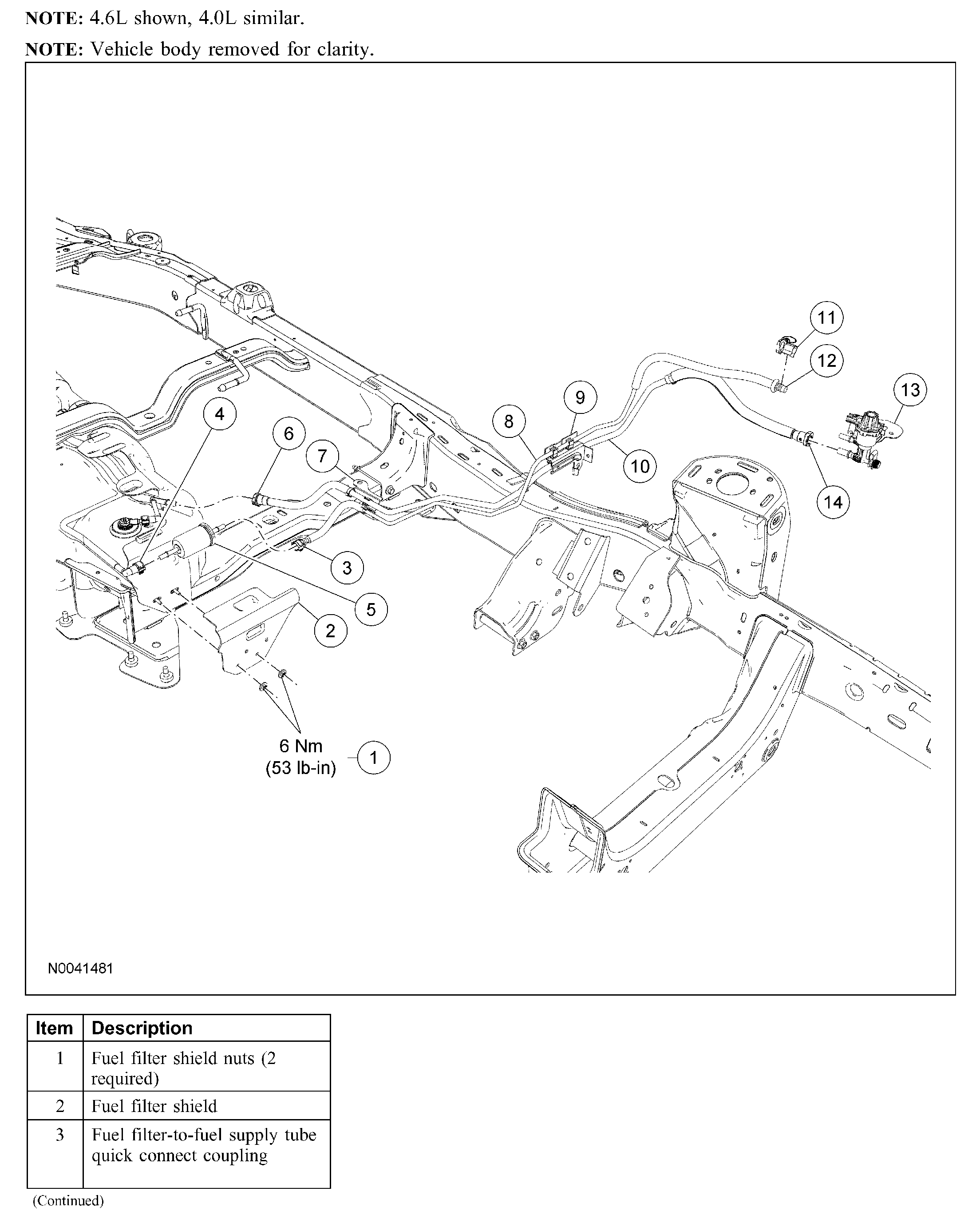

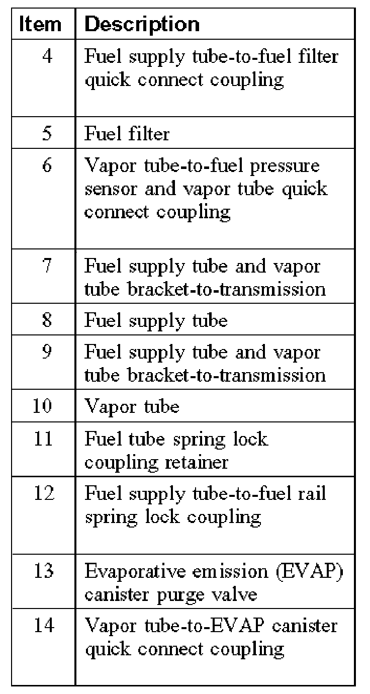

Hi and welcome back.
Ia m glad you got the starting issue repaired. As far as the fuel filter, here are the directions.
Exploded View
Removal and Installation
WARNING:
- Do not smoke or carry lighted tobacco or open flame of any type when working on or near any fuel-related component. Highly flammable mixtures are always present and may be ignited. Failure to follow these instructions may result in personal injury.
- Fuel in the fuel system remains under high pressure even when the engine is not running. Before servicing or disconnecting any of the fuel lines or fuel system components, the fuel system pressure must be relieved to prevent accidental spraying of fuel which can cause a fire hazard. Failure to follow these instructions may result in personal injury.
CAUTION:
- Fuel injection equipment is manufactured to very precise tolerances and fine clearances. It is therefore essential that absolute cleanliness is observed when working with these components. Always install blanking plugs to any open orifices or tubes.
- When reusing liquid or vapor tube connectors, make sure to use compressed air to remove any foreign material from the connector retaining clip area before separating from the tube.
NOTE: During the repair or replacement of fuel-related components, all liquid and vapor fuel openings shall be capped, taped or otherwise appropriately protected to prevent the ingress of dirt or other contamination. All caps, tape and other protective materials shall be removed prior to installation.
1. With the vehicle in NEUTRAL, position it on a hoist.
2. Release the fuel system pressure.
3. Disconnect the battery ground cable.

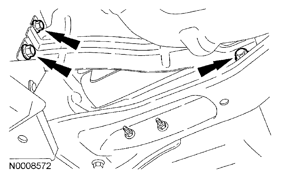

4. Remove the bolts and the fuel filter heat shield.
- To install, tighten to 20 Nm (15 lb-ft).
5. Remove the nuts and the fuel filter shield.
- To install, tighten to 6 Nm (53 lb-in).
6. Disconnect the fuel supply tubes quick connect couplings.
7. Remove the fuel filter.
8. To install, reverse the removal procedure.

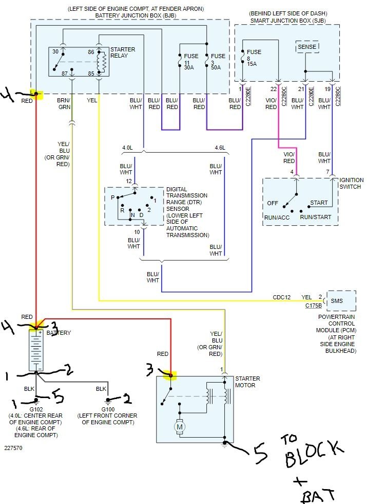

JIM FOSTER2
There is not a click. Almost the same as if the battery was not connected. Most times when I turn the key the first starter effort sounds like a hard effort followed by a quick starter cranking and the engine starts. I will need to check the light dimming and security light question. Thanks
Thursday, December 31st, 2020 AT 8:34 AM (Merged)

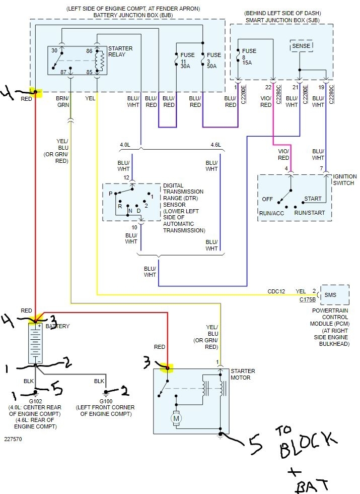

STEVE W.
  • 13,573 POSTS
Okay, that description sounds like a bad connection, Take a close look at the battery connections to the starter and the grounds to the body and block. If you have a multi-meter you can do a voltage drop test at those connections without removing them and see if they are the issue. Start by putting the meter on the battery positive post itself, then measure for voltage to the cable connector, then to the connector on the starter and the post on the starter to that connection. If there is a bad connection or a bad cable you will find a voltage higher than about .25 volts when probing the connections. Do the same on the negative cable. That way you don't need to remove parts that are Okay.
Video examples of the process.
https://www.youtube.com/watch?v=3xjLtg3FLoA&disable_polymer=1
https://www.youtube.com/watch?v=APLic9F7ZsA&disable_polymer=1
In the diagram I drew the points to test with the meter. 1-1 2-2 and so on.
