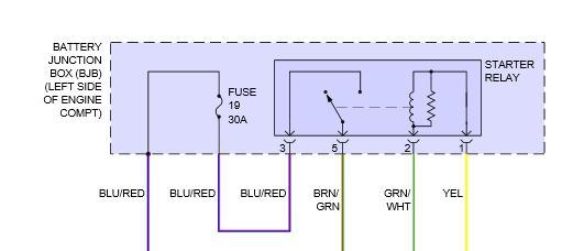

EHUNKIN
Truck wouldn't start in the morning, battery was dead (clicking noise while key was turned), replaced battery and tries to start. Turned over and fired up but died immediately. Was suggested to replace alternator, once this was done I again tried to start the truck...and again it turned over fired up and immediately died.
The onboard system say to "check charging system" . I was told by my "mechanic" friend that it's most likely either the fuel pump or the starter. I'm not sure which I should try next?
FYI: I have checked all fuses and the fuel pump reset switch, and all seem to be operating...
Dec 31, 2020 at 12:34 AM (Merged)
  • 110,244 POSTS
First, if the battery is fully charged, a bad alt will not cause it to shut down until the battery runs dead. As far as the starter, if it is turning the engine over and starting it, then chances are it is fine.
As far as the alt issue, it should be addressed, but I don't think that is the problem here unless the battery is really weak. So, I need you to start by checking fuel pump pressure to see if it is within the manufacturer's specs. Do that and let me know what you find. If you need directions, go to the home page under "Repair and Service" section. There is a video and directions for this process.

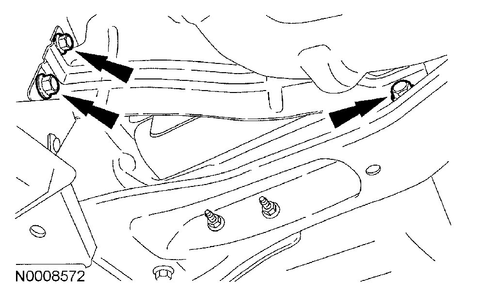

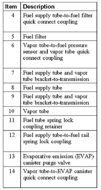

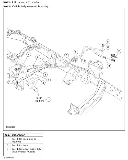

Hi and welcome back.
Ia m glad you got the starting issue repaired. As far as the fuel filter, here are the directions.
Exploded View
Removal and Installation
WARNING:
- Do not smoke or carry lighted tobacco or open flame of any type when working on or near any fuel-related component. Highly flammable mixtures are always present and may be ignited. Failure to follow these instructions may result in personal injury.
- Fuel in the fuel system remains under high pressure even when the engine is not running. Before servicing or disconnecting any of the fuel lines or fuel system components, the fuel system pressure must be relieved to prevent accidental spraying of fuel which can cause a fire hazard. Failure to follow these instructions may result in personal injury.
CAUTION:
- Fuel injection equipment is manufactured to very precise tolerances and fine clearances. It is therefore essential that absolute cleanliness is observed when working with these components. Always install blanking plugs to any open orifices or tubes.
- When reusing liquid or vapor tube connectors, make sure to use compressed air to remove any foreign material from the connector retaining clip area before separating from the tube.
NOTE: During the repair or replacement of fuel-related components, all liquid and vapor fuel openings shall be capped, taped or otherwise appropriately protected to prevent the ingress of dirt or other contamination. All caps, tape and other protective materials shall be removed prior to installation.
1. With the vehicle in NEUTRAL, position it on a hoist.
2. Release the fuel system pressure.
3. Disconnect the battery ground cable.
4. Remove the bolts and the fuel filter heat shield.
- To install, tighten to 20 Nm (15 lb-ft).
5. Remove the nuts and the fuel filter shield.
- To install, tighten to 6 Nm (53 lb-in).
6. Disconnect the fuel supply tubes quick connect couplings.
7. Remove the fuel filter.
8. To install, reverse the removal procedure.

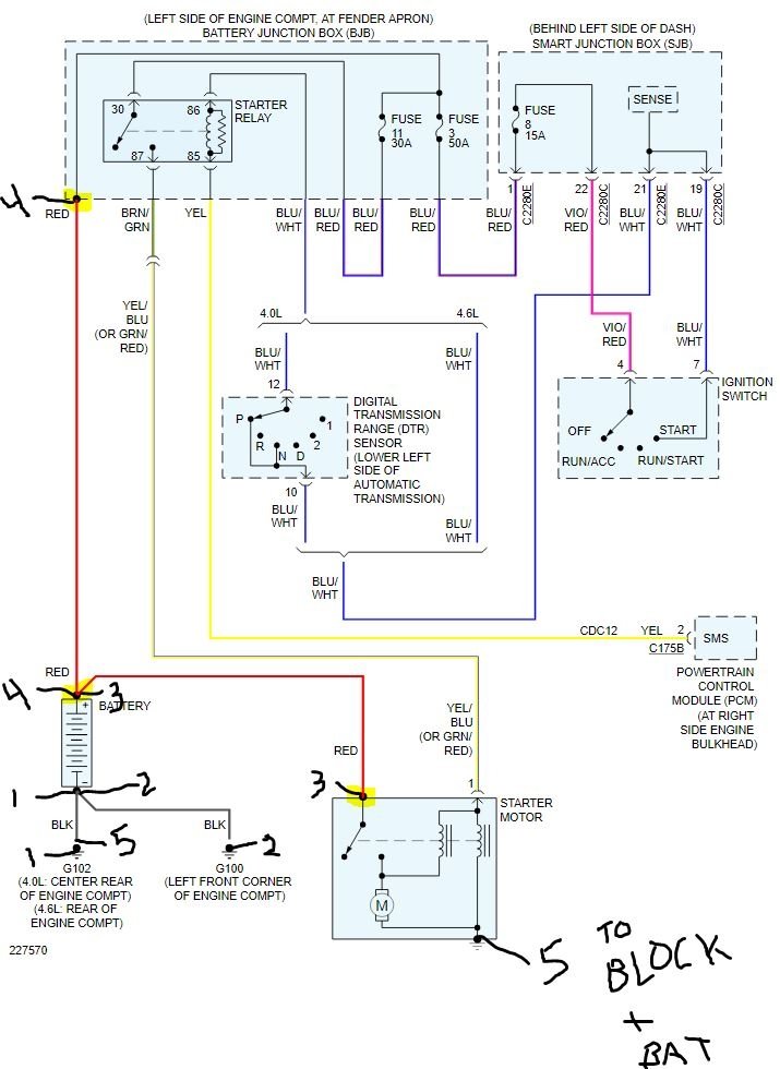

JIM FOSTER2
There is not a click. Almost the same as if the battery was not connected. Most times when I turn the key the first starter effort sounds like a hard effort followed by a quick starter cranking and the engine starts. I will need to check the light dimming and security light question. Thanks
STEVE W.
  • 15,345 POSTS
Okay, that description sounds like a bad connection, Take a close look at the battery connections to the starter and the grounds to the body and block. If you have a multi-meter you can do a voltage drop test at those connections without removing them and see if they are the issue. Start by putting the meter on the battery positive post itself, then measure for voltage to the cable connector, then to the connector on the starter and the post on the starter to that connection. If there is a bad connection or a bad cable you will find a voltage higher than about .25 volts when probing the connections. Do the same on the negative cable. That way you don't need to remove parts that are Okay.
Video examples of the process.
https://www.youtube.com/watch?v=3xjLtg3FLoA&disable_polymer=1
https://www.youtube.com/watch?v=APLic9F7ZsA&disable_polymer=1
In the diagram I drew the points to test with the meter. 1-1 2-2 and so on.

ROGGLE
2006 Ford Explorer. Ran errands, came home. Went to go back out again 30 min later, nothing. No dash lights. Tried to jump it, got dash lights and it seems electronics came on. Tried to turn over but just can't. Need to go to work tomorrow! Any advice?
Dec 31, 2020 at 12:35 AM (Merged)
HMAC300
  • 48,601 POSTS
check fuse 11 &3 undrhood by battery and fuse 8 under dash. also check starter relay underhood by fuses. anyo fhtose will rprevent truck from starting. then check blue/white wire going to start relay and see if igniition switch is sending power to start. if not it's either ignition switch or nuetral switch. there are also two brown to red fusible links at battery junction box, check to make sure they are still good if they burn out power to certain areas of vehicle will be effected.
