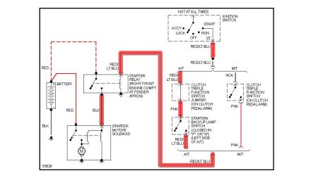

my 93 explorer will not start infact it doesn't crank at all. I hear the fuel pump when I turn the key but nothing else.
Mar 18, 2010 at 12:32 AM
  • 110,248 POSTS
Have a helper turn the key to the start position while you check for voltage to the smaller wire at the starter. It should have 12+ volts. If it does, chances are the starter is bad. These guides can help us fix it

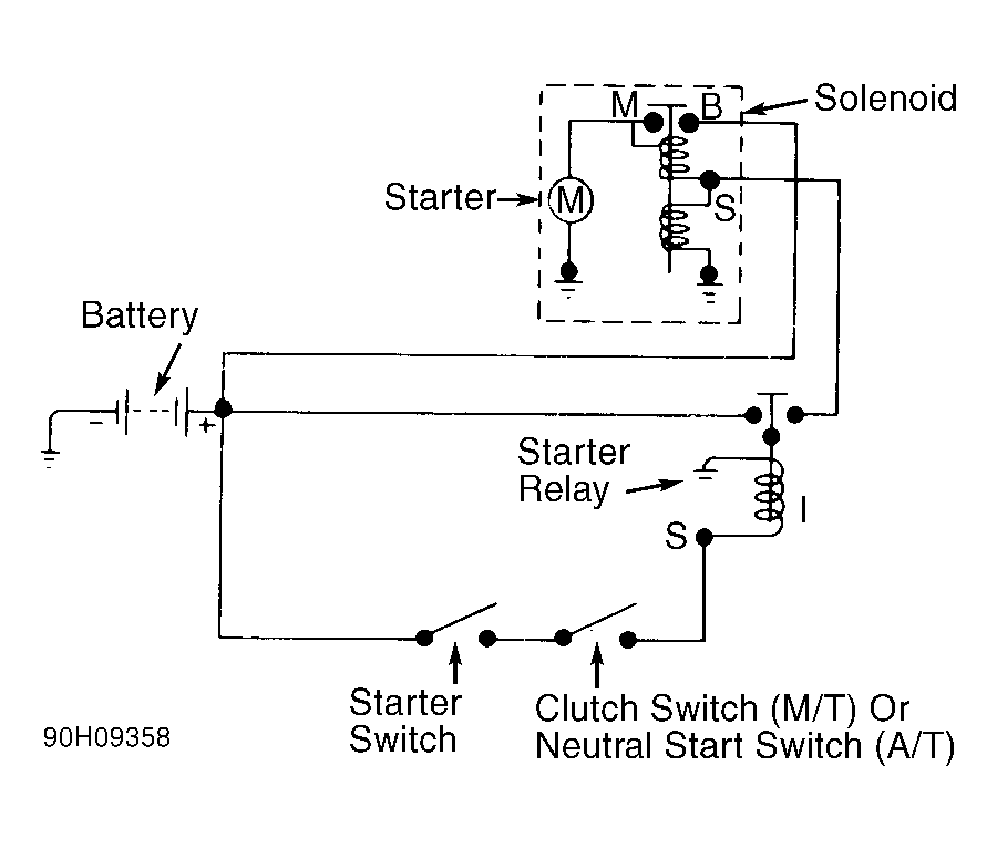

There's three things that commonly happen with Ford starter systems. First check the connections on that starter relay near the battery. The large copper nuts often work loose. Next, measure the voltage on the large cable right at the starter while a helper turns the ignition switch to "crank". If it goes real low, suspect corroded strands of wire under the insulation where you can't see it, right at that end. Third, oil or power steering fluid that gets inside the starter will deteriorate the brushes and make them crumble. If that is the case, the voltage on the large cable will still be there but the motor won't spin.

I pulled the starter assembly off and took it to be tested. It tested okay. Perplexed, I cleaned it up and re-installed it. When I pulled if off, I noticed that the small wire in the bundle that attached to the solenoid was not connected. When I re-installed it, I connected that small wire (it was on a spade terminal), and it started right up.

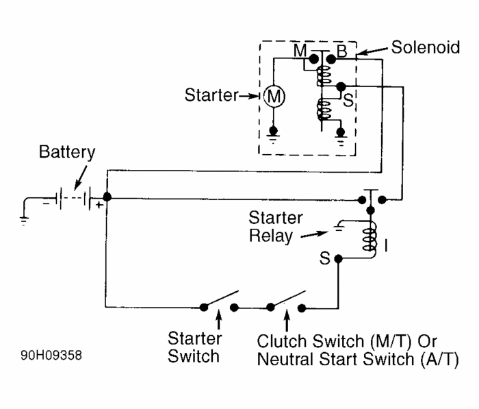

  • 75,988 POSTS
Load test the battery and make sure its cleaned and tight both ends of cables. Could also be a problem with the start circuit-ignition switch, starter relay,starter and back lamp switch, and starter itself.

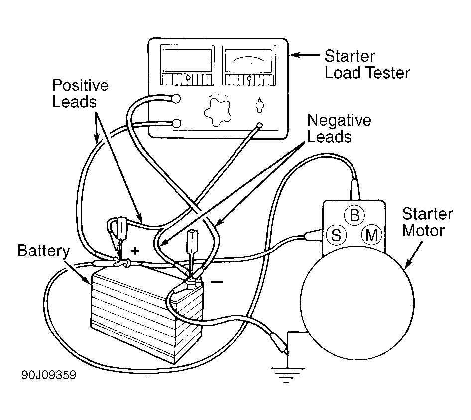

check starter
Ensure battery is fully charged and in good condition. Ensure battery cables and connections are in good condition. Measure voltage at starter solenoid battery cable terminal. If voltage is less than 12 volts, recheck battery cables and connections.
Service as necessary.
Connect one lead of remote starter switch to starter solenoid battery cable terminal. Connect other lead to "S" terminal on starter solenoid
