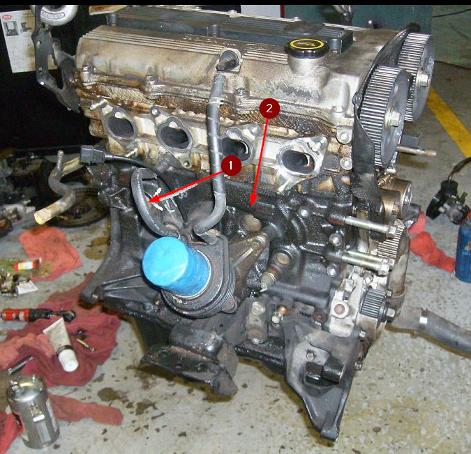

I need to get the locations of the freeze plugs I's there a diagram that can show me?
Jun 6, 2022 at 1:05 PM
There are a couple of these on each side of the block. It appears there is one behind where the oil filter mounts and then close to where the starter is.
I am attaching a picture below of the best view that I could find.
Most manuals do not have this info as a freeze plug is not a typical thing to replace anymore. These are normally done during engine rebuilds and that is not typical anymore.
However, if you need to replace them that is normally due to a leak. So, we just need to confirm where the leak is by pressure testing the system.
https://www.2carpros.com/articles/radiator-pressure-test
I assume you have already done this but just want to make sure.
Below is a picture. There are going to be ones on the other side of the block in about the same locations.

Thank you that did answer my question. I have a leak from around the bell housing and flywheel area. We have the transmission pulled it is just hard to see .. but I have one more question. It may be dumb ,but we found the leak when my starter was acting up. Would a leak by the starter have caused damage to the starter somehow?
Jun 7, 2022 at 5:27 PM
It is possible if coolant was getting on the starter that it could damage it or short it out.
However, the way to know for sure is to tell how the starter failed. Do you still have it?
