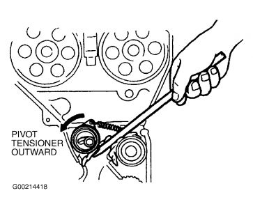

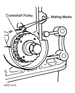

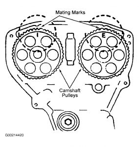

What is the setting for a timing belt settiing for this kia?

Is this what you need?
