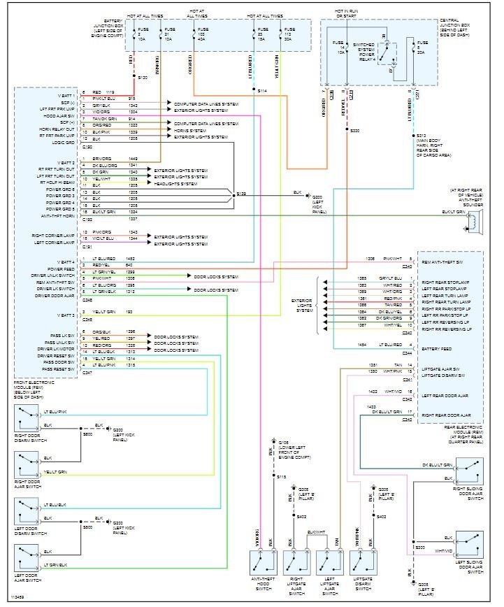

I recently replace the instrument cluster in my Ford Windstar 1999, but when I try to power on the engine nothing happen, the van is dead, I got power from the battery and I can see the instrument panel lights on, so any idea what could the problem is? Do I need to reset something in my van?
Yes, the Anti-theft red light is flashing, it flash three times continuously then short pause, three times again.
Could be the alarm? I deactivate that and no luck.

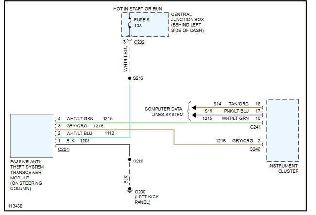

From what I can find out, there is information on the old cluster that needs to be downloaded and the upload that information to the new cluster. I think it has something to do with the odometer and the ignition key. There doesn't appear to be any simple button to push for this one
I have attached a diagram of the wiring for the systems below, check them out and get back to us
