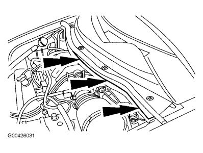

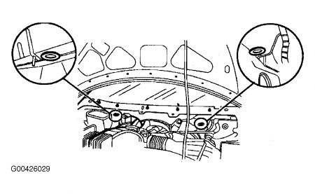

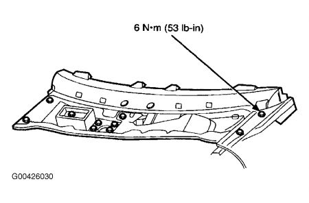

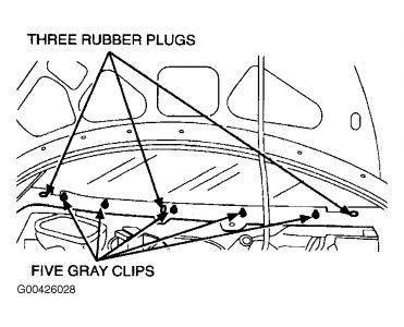

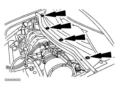

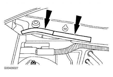

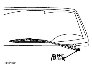

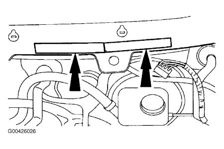

This is all it say's regarding damage to PCM, of course the longer the water is getting in the more damage would occur .. i'm pretty sure it must have fried a few along the way ??
The water leakage may be due to the PCM connector cover not seating completely and water leaking down from the cowl panel grille (cowl top vent panel) area.
ACTION
During normal diagnostic and repair procedures, inspect for evidence of water damage at the PCM, PCM connector, and/or transaxle. If present, inspect the sealing area of the PCM cover, seal the water leak path in the cowl panel grill area, and service the PCM as needed per the following Service Procedure.
7.[img]http://www.2carpros.com/forum/automotive_pictures/266999_7_1.jpg[/img
8.
http://www.2carpros.com/forum/automotive_pictures/266999_8_1.jpg
9.
http://www.2carpros.com/forum/automotive_pictures/266999_9_1.jpg
10.
http://www.2carpros.com/forum/automotive_pictures/266999_10_2.jpg
11.
http://www.2carpros.com/forum/automotive_pictures/266999_11_1.jpg
12.
http://www.2carpros.com/forum/automotive_pictures/266999_12_1.jpg
13.
http://www.2carpros.com/forum/automotive_pictures/266999_13_1.jpg
14.
http://www.2carpros.com/forum/automotive_pictures/266999_14_1.jpg
15.
http://www.2carpros.com/forum/automotive_pictures/266999_15_1.jpg
16.
http://www.2carpros.com/forum/automotive_pictures/266999_16_3.jpg

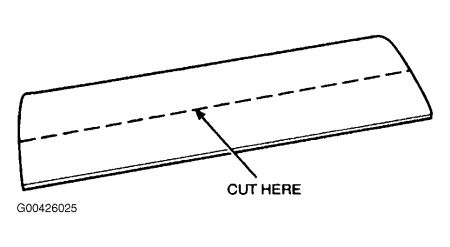

This is a strip of soft foam insulation Fig 7.
http://www.2carpros.com/forum/automotive_pictures/266999_7_2.jpg
