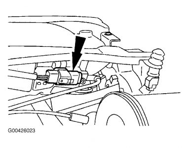

I have a 99 windstar. It will die while driving as if the ignition key was turned off. It did bring on the check engine light with a P0320 code. It will start up and run again after I wait 2-3 hrs for the whole engine to cool down, then it might die again after 5 miles of driving. I erased the code after I installed a new crankshaft sensor. It ran fine for a day then it all happened over again without bringing on the code this time. Next I changed the coil pack. It ran again, but now is still dying out while driving down the road and won't start unless it is allowed to cool down for 2-3 hours. The code has not came back after the first time.

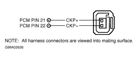

Continuous Memory DTC P0320
This DTC indicates that (2) successive erratic Profile Ignition Pulses (PIP) have occurred. Possible causes are:
Loose wires and/or connectors.
Short circuit to ground in ignition secondary system.
Incorrect 2-way radio installation.
If any of the specified causes were present, repair as necessary. If vehicle will not start, go to TEST A. If fault is intermittent, go to TEST Z. If vehicle will start and none of the specified causes were present, check for missing PIP signal. See TEST JD.
TEST JD: CRANKSHAFT POSITION (CKP) SENSOR
NOTE:After each service or repair procedure has been completed, reconnect all components. Clear DTCs and repeat QUICK TEST procedures to ensure all EEC-V systems are working properly and DTCs are no longer present.
Diagnostic Aids
Perform this test when instructed during QUICK TEST or if directed by other test procedures. This test is used to diagnose the following:
Crankshaft Position (CKP) sensor.
CKP wiring harness and connector(s).
Powertrain Control Module (PCM).
Fig. 145: Identifying CKP Sensor Circuits
http://www.2carpros.com/forum/automotive_pictures/266999_ckp3_1.jpg
1) Check CKP+ Circuit To PCM
Turn ignition off. Disconnect PCM 104-pin connector. Inspect connector for loose, damaged or corroded terminals. Repair as necessary. Turn ignition on. Measure voltage between PCM connector pin No. 21 (CKP+) and CKP+ terminal at CKP sensor wiring harness connector. See Fig. 145-Fig. 148 . Also measure resistance between PCM connector pin No. 22 (CKP-) and CKP- terminal at CKP sensor wiring harness connector. If both resistance readings are 5 ohms or less, go to next step. If any resistance reading is more than 5 ohms, repair open circuit.
2) Check For CKP+ Voltage Fault
Reconnect PCM connector. Turn ignition on. Measure voltage between CKP+ terminal at CKP sensor wiring harness connector and negative battery terminal. If voltage is more than one volt, but less than 2 volts, go to next step. If voltage is not as specified, go to step 19).
3) Check For CKP- Voltage Fault
Ensure ignition is on. Measure voltage between CKP- terminal at CKP sensor wiring harness connector and negative battery terminal. If voltage is 1-2 volts, go to step 10). If voltage is not 1-2 volts, go to next step.
4) Determine Fault
If voltage reading in step 3) is less than one volt, go to next step. If voltage reading in step 3) is not less than one volt, go to step 6).
5) Check CKP- Circuit For Short To Ground
Turn ignition off. Disconnect PCM connector. Measure resistance between PCM connector pin No. 22 and negative battery terminal. If resistance is more than 10,000 ohms, replace PCM. If resistance is less than 10,000 ohms, repair CKP- circuit short to ground.
6) Check CKP- Sensor For Short To Power
Disconnect PCM connector. Turn ignition on. Measure voltage between PCM connector pin No. 22 and negative battery terminal. If voltage is .5 volt or more, repair CKP- circuit short to power. If resistance is less than .5 volt, replace PCM.
NOTE:A break in step numbering sequence occurs at this point. Procedure skips from step 6) to step 10). No test procedures have been omitted.
10) Check CKP Sensor Voltage At PCM
Turn ignition off. Reconnect CKP sensor connector. Disconnect PCM connector. While cranking engine, measure voltage between PCM connector pins No. 21 and 22. If A/C voltage stabilized at more than .4 volt, CKP circuit is okay. Go to step 17). If voltage is .4 volt or less, go to next step.
NOTE:A break in step numbering sequence occurs at this point. Procedure skips from step 10) to step 12). No test procedures have been omitted.
12) Check CKP Circuit Resistance
Turn ignition off. Measure resistance between PCM connector pins No. 21 and 22. If resistance is 300-800 ohms, go to step 16). If resistance is not 300-800 ohms, go to next step.
13) Determine Fault
If resistance is less than 300 ohms in step 12) , go to next step. If resistance is not less than 300 ohms in step 12) , replace CKP sensor.
14) Check For Open Circuit
Disconnect CKP sensor connector. Measure resistance between CKP sensor wiring harness connector terminals. If resistance is less than 5 ohms, repair CKP+ to CKP- short circuit. If resistance is 5 ohms or more, replace CKP sensor.
NOTE:A break in step numbering sequence occurs at this point. Procedure skips from step 14) to step 16). No test procedures have been omitted.
16) Check CKP Sensor & Trigger Wheel
Check CKP sensor and trigger wheel for damage. Repair as necessary. If CKP sensor and trigger wheel are okay, replace CKP sensor.
17) Check For PCM Fault
Turn ignition off. Disconnect CKP sensor connector. Reconnect PCM connector. Measure resistance between CKP sensor wiring harness connector terminals. If resistance is 16,000-24,000 ohms, go to next step. If resistance is not 16,000-24,000 ohms, replace PCM.
18) Check For Short Circuit
Ensure CKP sensor is disconnected. Disconnect PCM connector. Measure resistance between PCM connector pins No. 21 and 22. If resistance is more than 1000 ohms, replace CKP sensor. If resistance is 1000 ohms or less, repair short circuit.
19) Determine Fault
If voltage reading in step 2) is less than one volt, go to next step. If voltage reading in step 2) is not less than one volt, go to step 21).
20) Check CKP+ Circuit For Short To Ground
Turn ignition off. Disconnect PCM connector. Measure resistance between PCM connector pin 21 and negative battery terminal. If resistance is more than 10,000 ohms, replace PCM. If resistance is less than 10,000 ohms, repair CKP+ circuit short to ground.
21) Check CKP+ Sensor For Short To Power
Turn ignition off. Disconnect PCM connector. Turn ignition on. Measure voltage between PCM connector pin No. 21 and negative battery terminal. If voltage is .5 volt or more, repair CKP+ circuit short to power. If voltage is less than .5 volt, replace PCM.

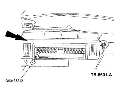

SZALKUSKT
  • 274 POSTS

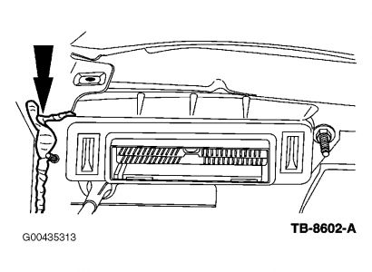

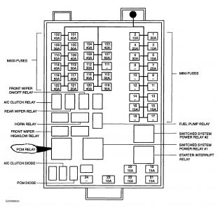

Where is the PCM located? If I changed the crankshaft sensor and the coil already what do you think it might be?
+1

SZALKUSKT
  • 274 POSTS
Dave H, I will try going through the steps of this troubleshooting. Please help with some more ideas. Can you shoot me explanation of Test A and Test Z?

I have marked the PCM relay ? it is in underhood fuse/relay box
http://www.2carpros.com/forum/automotive_pictures/266999_relay_4.jpg

Well, I called the dealer and they cannot read out the PCM off the car. They want me to bring in the car of course. After I checked the CKP sensor for voltage and ran some of the checks and put it all together, the van was all completely cold and it would only crank and not start. It leads me to think this problem is intermit and not related to heat at all just a coincidence. What else besides the CKP wiring and PCM could bring on this code after I already changed the coilpack too.
Friday, December 19th, 2008 AT 1:58 PM
SZALKUSKT
  • 274 POSTS
I wonder what the PCM relay does? I saw the picture of it. I saw someone recommend a website that sells relays for cheap. Any recommendations on where to get the relay? First we have to research what it does.

Some 1999-2003 Windstar and 2004-2007 Freestar / Monterey vehicles built prior to 6/22/2006 may exhibit engine / transmission driveability issues due to water entering the powertrain control module (PCM) or transaxle vent. Symptoms may include various diagnostic trouble codes (DTCs), harsh or delayed transmission shifts / engagements, no reverse engagement, engine overheat, engine lean condition causing a misfire (possibly leading to melted electrodes on the spark plugs), and rough idle. The water leakage may be due to the PCM connector cover not seating completely and water leaking down from the cowl panel grille (cowl top vent panel) area.
ACTION

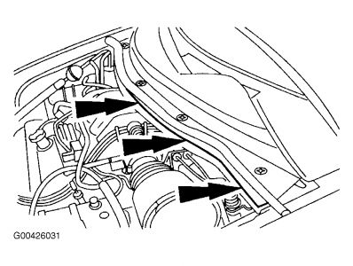

During normal diagnostic and repair procedures, inspect for evidence of water damage at the PCM, PCM connector, and/or transaxle. If present, inspect the sealing area of the PCM cover, seal the water leak path in the cowl panel grill area, and service the PCM as needed per the following Service Procedure.
SERVICE PROCEDURE
Disconnect the PCM connector. Remove the PCM cover from the studs in the bulkhead. (Fig. 1 )

Fig. 1: PCM Connector
Inspect the body sealant on the bulkhead to ensure it is not protruding out causing the cover not to seal properly in that area. (Fig. 2 ) If sealant is interfering with the PCM cover, remove excess with a sharp tool. Reinstall the PCM cover ensuring the cover seals and is flush with the bulkhead.
Fig. 2: Body Sealant On Bulkhead

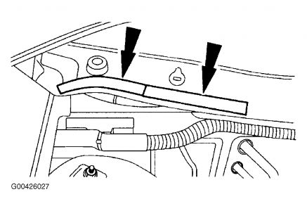

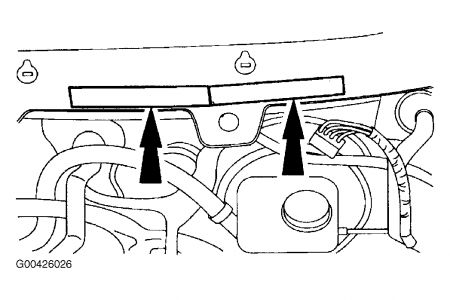

Obtain two (2) PVC soft foam adhesive strips (164-R4901) from the Rotunda Squeak And Rattle Kit (164-R4900).
Cut both of the PVC soft foam adhesive strips in half, lengthwise, so you have four (4) pieces 7/8" x 6" (22 mm x 152 mm). (Fig. 7 )
Fig. 7: Cutting PVC Soft Foam Adhesive Strip
Clean the metal body surface under the lower cowl panel, in the area above the transaxle and the area above the PCM.
Place two (2) of the cut pieces of the PVC soft foam adhesive strips on the metal body surface over the transaxle area. The two ends need to touch, do not allow any gap between the two ends. (Fig. 8 )
Fig. 8: Adhesive Strips On Body Surface Over Transaxle Area
Place the other two cut pieces of the PVC soft foam adhesive strips on the metal body surface over the PCM area. The two ends need to touch, do not allow any gap between the two ends. (Fig. 9 )
Fig. 9: Adhesive Strips On Body Surface Over PCM Area

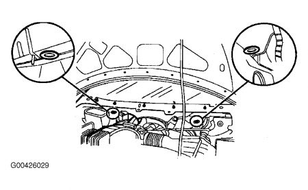

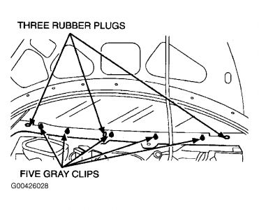

Check that the three (3) rubber plugs and five (5) gray plastic clips are fully seated. Add Clear Silicone Rubber around the three (3) rubber plugs and the five (5) gray plastic clips. (Fig. 10 )
Fig. 10: Rubber Plugs And Plastic Clip Locations
Remove and discard the two rubber plugs on the bottom of the cowl sheet metal. (Fig. 11 )
Fig. 11: Rubber Plugs On Bottom Of Cowl Sheet Metal

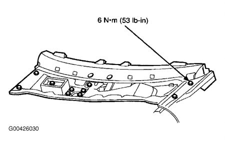

Install the upper cowl panel grille.
Install the windshield wiper hose.

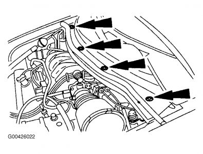

Install four (4) new pushpin screw/rivets to secure the upper cowl to the lower cowl. Add Clear Silicone Rubber to the four (4) pushpin screw/rivets to make a watertight seal around them. (Fig. 14 )
Fig. 14: Removing Upper Cowl Panel Screws

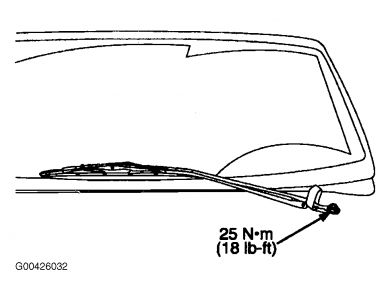

Install wiper pivot arms. (Fig. 16 )
NOTE:APPLY THREADLOCK TO THE PIVOT ARM NUT.
Fig. 16: Installing Wiper Pivot Arms
Check the wiper pivot arm adjustment.
