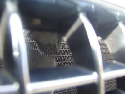

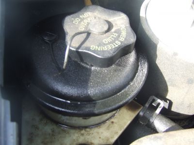

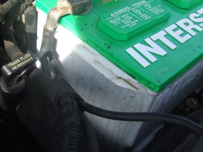

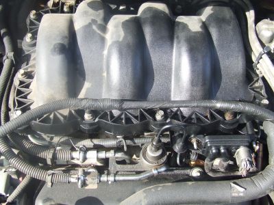

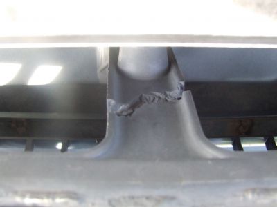

Last night coming from work my car stopped accelerating the steering wheel locked up so i pulled over opened the hood and smoke just came flowing out. There's oil spattered on the battery intake manifold and hoses. i assumed it's oil due to the shine. I really need help on this one

You have a picture of the grill. Did something break through it when this happened? If so, check the trans cooler to see if it is leaking. Let me know.
