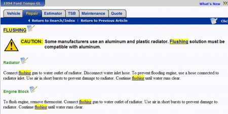

Sorry I miss read the post...I thought you asked about the radiator? >How do you flush the Radiator If the engine needs it, Follow these instructions...
https://images.2carpros.com/forum/automotive_pictures/62217_Flushing_1.jpg
