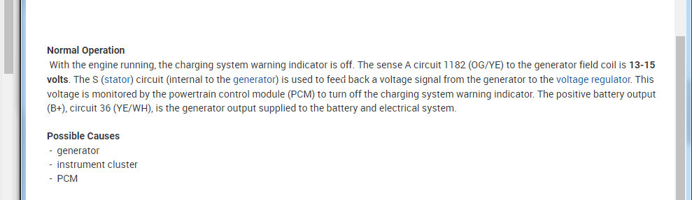

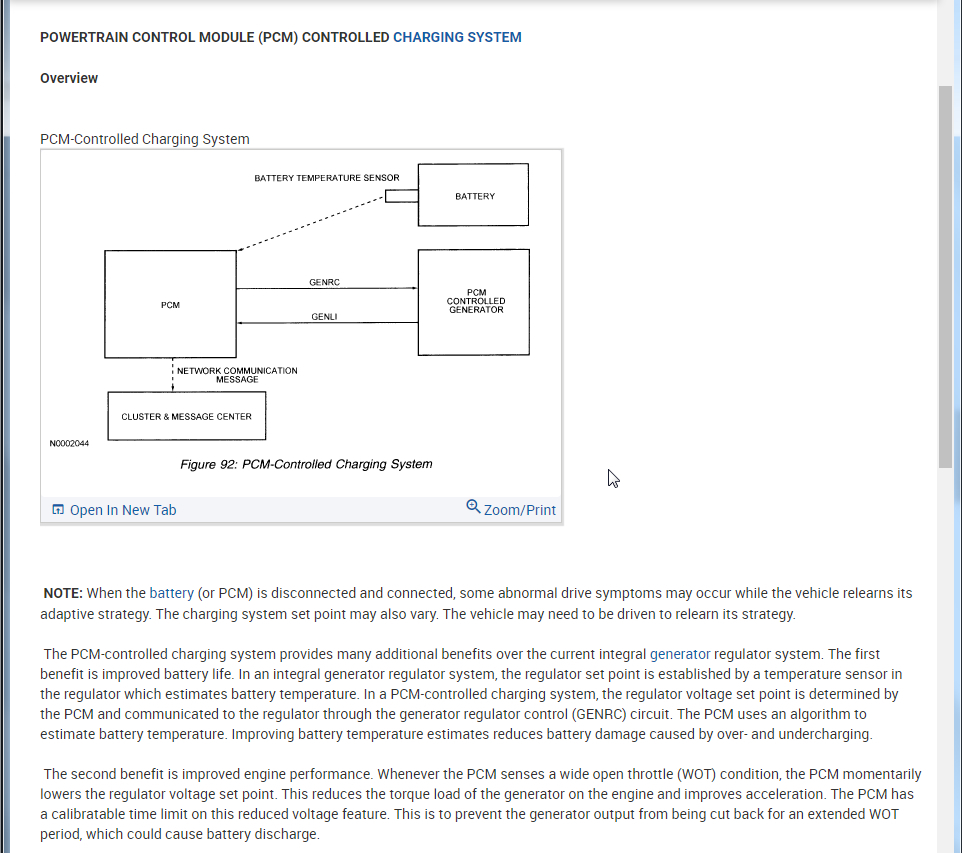

My car won't charge the battery, I changed the alternator, it still is not sending power to the battery.
Oct 7, 2010 at 3:25 AM

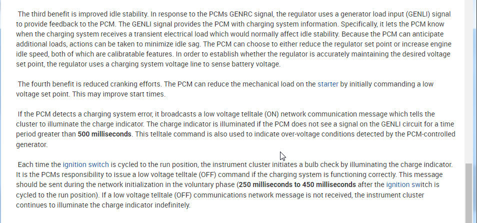

We need to just rule out a faulty replacement alternator by testing it using this guide:
If it is a faulty replacement then we will not fix it if we assume that it is ok because you replaced it.

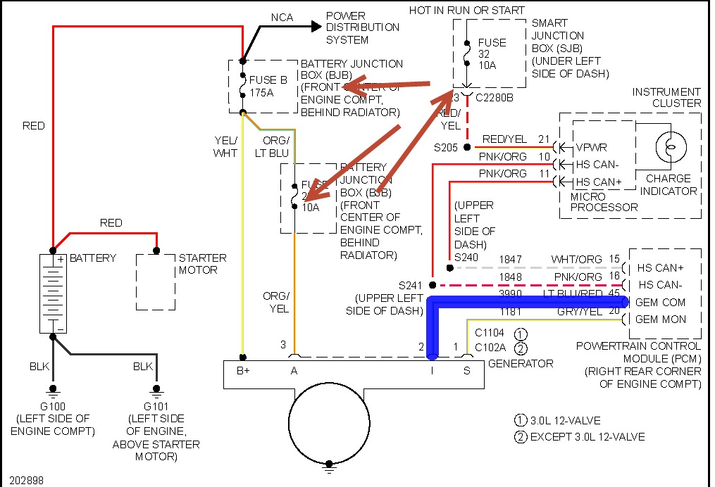

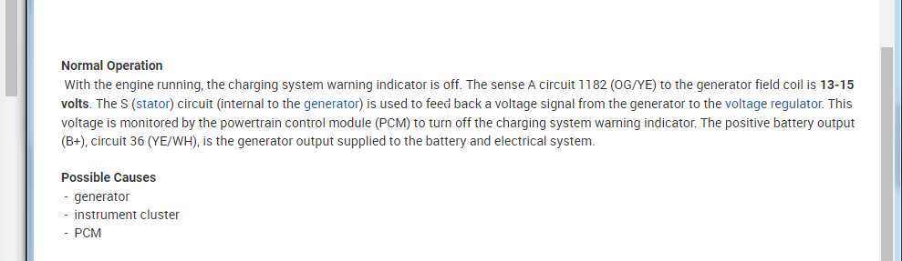

Next we need to check the voltage coming from the alternator to the PCM just to be sure it is in fact not charging or do we have an issue with the PCM just turning on the indicator.

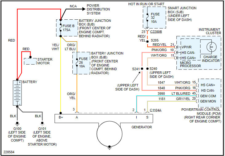

Below is the wiring diagram that will give the detail on what circuits to test. Depending on the results of this, we may just have a PCM issue as this is what controls the charging.

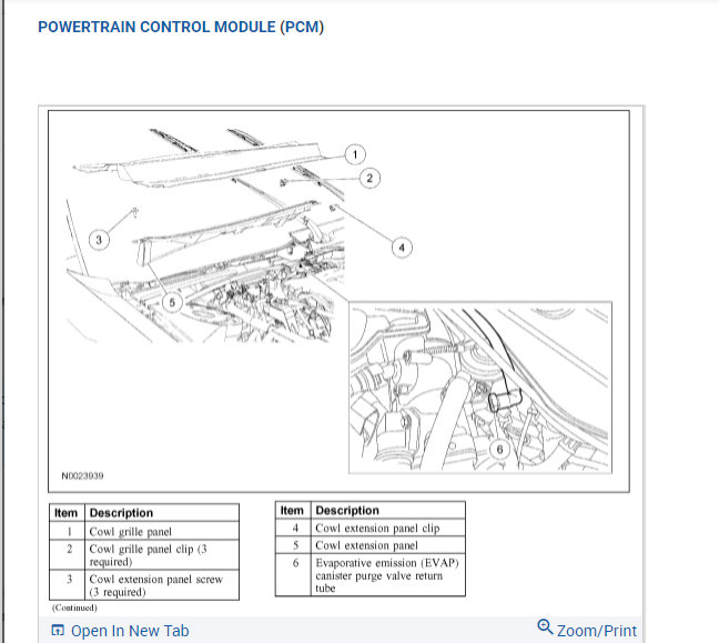

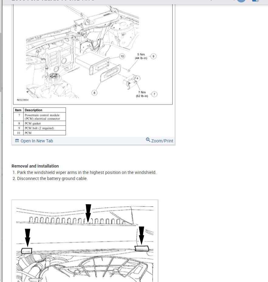

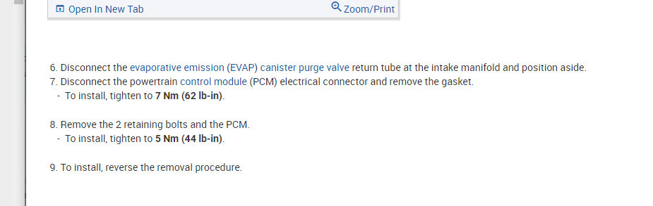

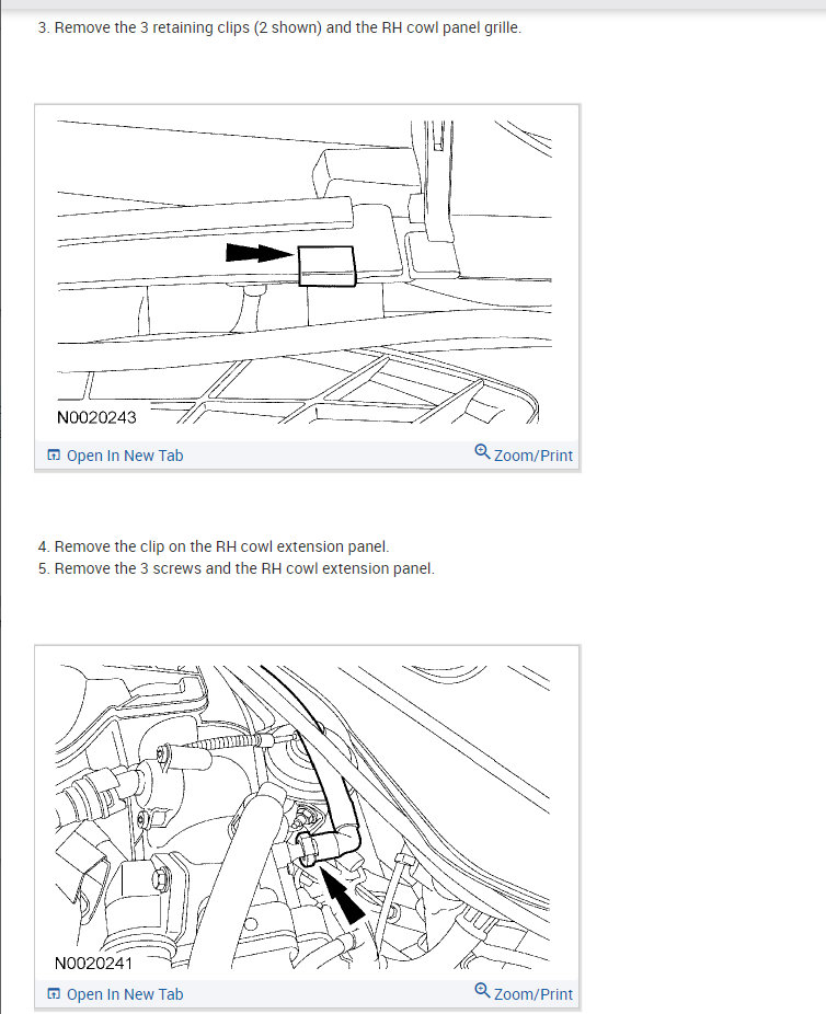

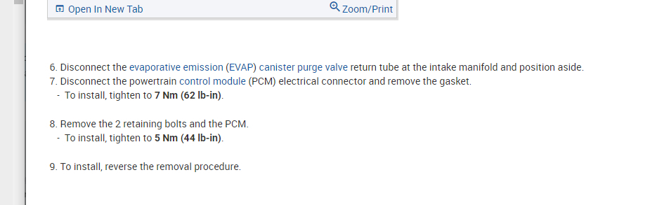

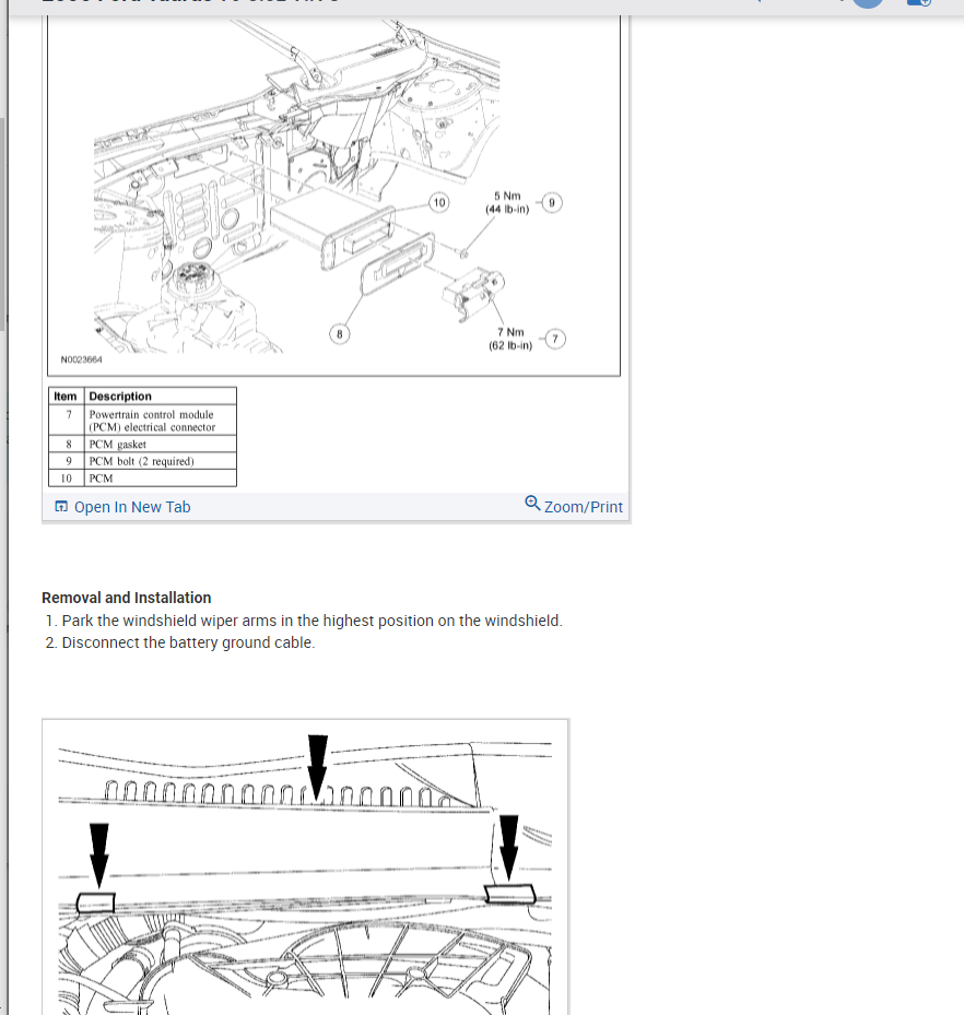

Below is the process from the manual on how to replace the PCM as I suspect this is the issue.
Please let us know if you have other questions. Thanks

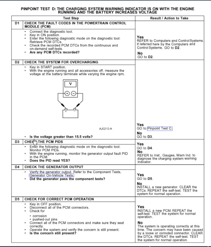

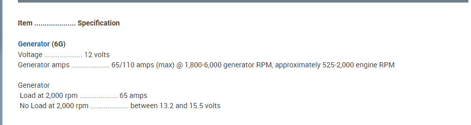

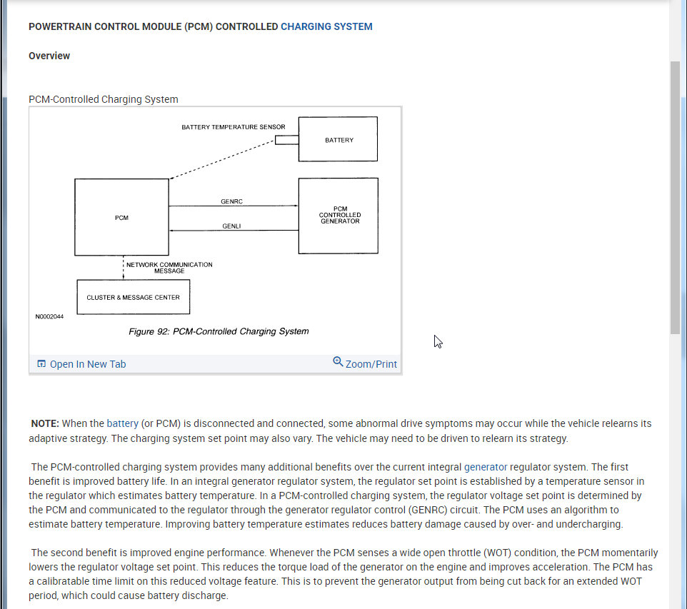

This could be a number of different things. First and foremost it could be a faulty alternator. This is unlikely due to it being replaced but what we don't know is if this message was coming on previously due to the voltage being low. Now it appears it is high so that is normally always due to a faulty regulator which is internal to the alternator.
I would suggest with having it tested with the info below.
https://www.2carpros.com/articles/how-to-replace-an-alternator
I attached the info from the manual on how this works so it will give more detail. However, it is turned on and off by the PCM so we could also have an issue with the PCM. So starting with testing the alternator is where to start. I attached the testing that we need to do in order to find out if this is the PCM.
I also attached the voltage spec to further this point. Please run through this info and let us know what you find.

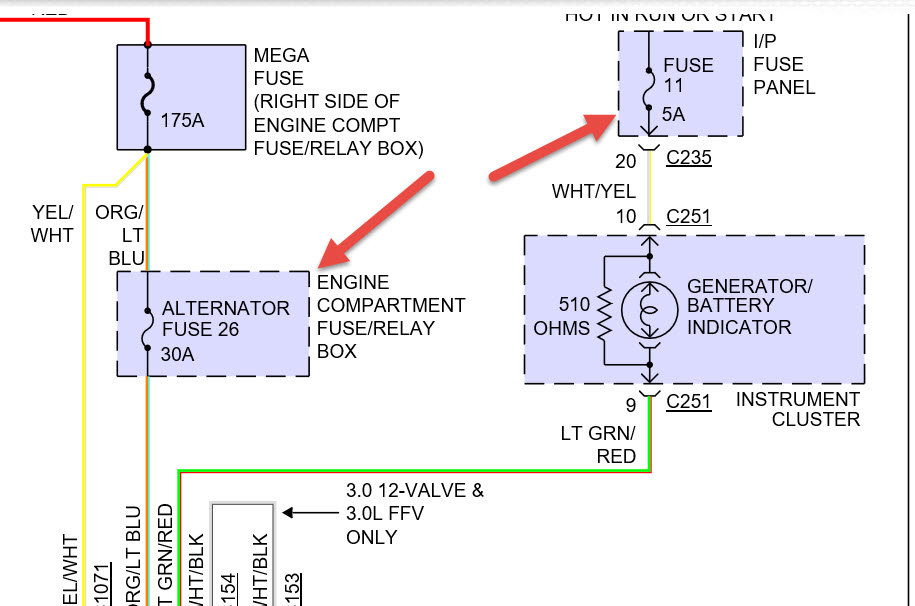

TAURUS8
"Check charging system" light came on, found dead battery, bad alternator and a broke serpentine belt. Replaced alternator with a brand new one not rebuilt, replaced belt and battery and a found blown fuse, still receiving "check charging system" message and there is a kind of grinding sound when the A/C isn't on. Any idea what this could be or how to fix it?
Jul 28, 2021 at 7:05 AM (Merged)
HMAC300
  • 48,601 POSTS
the grinding sound may be the clutch bearing in a/c clutch. hope you changed the tensioner as well as the belt they both should be changed. may be that too.
TAURUS8
Possibly but I'm not too worried about that problem at the moment and I already changed the tension pulley and idler wheel. My main concern is that the car keeps saying that the battery isn't charging even after all that. Why?
HMAC300
  • 48,601 POSTS
check the silly little fuses that's pointed out in pic.....that may be your problem.
TAURUS8
Ha, silly little fuses. Anyways turns out that it was the whole a/c unit that went bad (even though it would still produce cold air) and it snowballed from there. Thanks for your time and help.

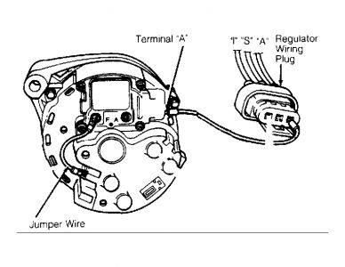

(93 ford taurus sho 3.2 dohc automatic) i need help my car died about a month ago now. and wouldnt start so we figured out the battery was junk we got a brand new battery and it started right up but wouldnt stay charged and i got a life time warranty altinator from auto zone all ready so we checked that and it was bad so we replaced it and still it will not hold a charge. i have went threw most of the wireing harness everything checks out as far as we can see we have checked all the grounds all wires really but still wont charge. at an idel it reads 12.2 to 12.4 on a volt meter but as soon as u turn on the heater our lights open the door etc. it reads 11.3 to 11.8 and when u step on the gas it wont charge either. has anybody even seen anything like it? please help!
Jul 28, 2021 at 7:06 AM (Merged)
BMRFIXIT
  • 19,053 POSTS
Unplug regulator harness connector. Connect jumper wire from harness terminal "A" to regulator terminal "A". Connect another jumper wire from regulator terminal "F" screw to alternator rear housing. With engine idling, connect voltmeter negative lead to battery ground terminal. Connect voltmeter positive lead first to regulator harness connector terminal "S" and then to terminal "I". Voltage at "S" terminal should be about 1/2 that at terminal "I". If voltage is okay, remove jumper wire. Connect regulator wiring plug. Repeat LOAD TEST. If no voltage is present, remove jumper wire and repair faulty wiring circuit or alternator. Connect voltmeter positive lead to positive battery terminal. Connect regulator wiring plug. Repeat LOAD TEST
https://images.2carpros.com/forum/automotive_pictures/99387_Graphic1_668.jpg
