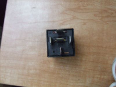

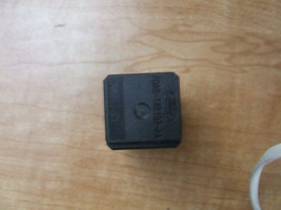

No there are two types normal relays are black square shaped and micro relays are black rectangle and smaller than the relays. There are relays in the PDC and als the ccrm(constant control relay module), this is up near the radiator on the driver's side.
