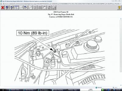

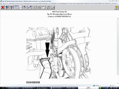

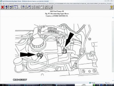

How do I replace the Coolant Reservoir on a 2002 Ford Taurus?
Thank you!
Oct 21, 2007 at 1:26 AM
MERLIN2021
  • 17,250 POSTS
Drain the system below the Degas bottle, Use a pliers to remove the 2 upper hoses, then the lower hoses. Unbolt the 10mm screw and nut then lift out!

Drain the cooling system below the degas bottle. Use pliers to remove the two upper hoses, then the lower hoses. Unbolt the 10mm screw and nut and lift the reservoir out.
Conversation Summary
The owner asked how to replace the coolant reservoir on a 2002 Ford Taurus. The expert advised draining the system below the degas bottle, removing the upper and lower hoses with pliers, unbolting the 10mm screw and nut, and lifting the bottle out.
