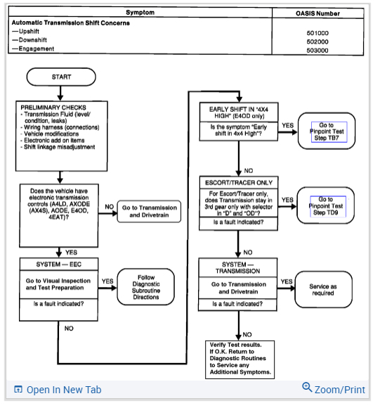

My transmission will not shift into second gear. I checked the fluid and it was fine I also changed the filter. What could cause the transmission not to shift? It will still go, but not over 35 mph.
Saturday, August 22nd, 2020 AT 10:37 AM (Merged)
BMRFIXIT
  • 19,053 POSTS
Suspect internal tranny failure
check for codes
Not only do we need to check for codes but I would suggest we check the fluid pressure. It sounds like there is either a leak internally not allowing the vehicle to shift or the fluid pump is failing.
Here is a flow chart that will help with this. Let us know what you find. Thanks
Saturday, August 22nd, 2020 AT 2:02 PM
