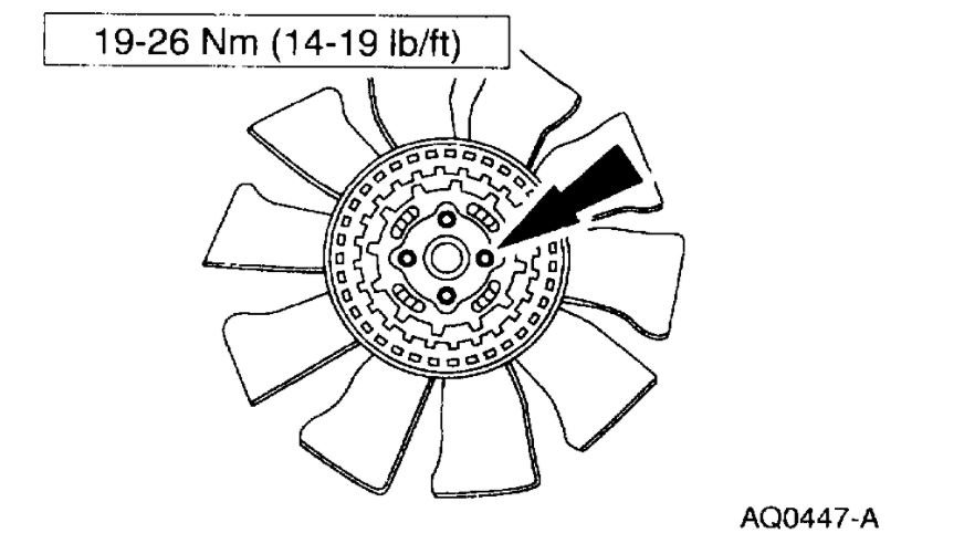

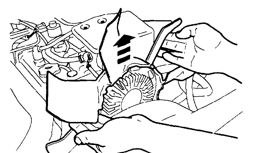

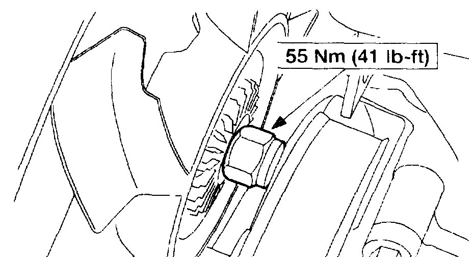

Here are replacement directions specific to your vehicle. The attached pics correlate with the directions.
Fan - Blade and Clutch, 2.3L
Vehicle Engine, Cooling and Exhaust Cooling System Radiator Cooling Fan Fan Clutch Service and Repair Procedures Fan - Blade and Clutch, 2.3L
FAN - BLADE AND CLUTCH, 2.3L
picture 1
1. Loosen the mechanical fan nut.
picture 2
2. Remove the fan and clutch assembly.
3. To install, reverse the removal procedure.

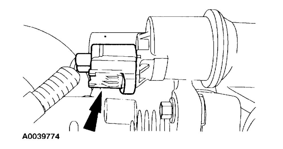

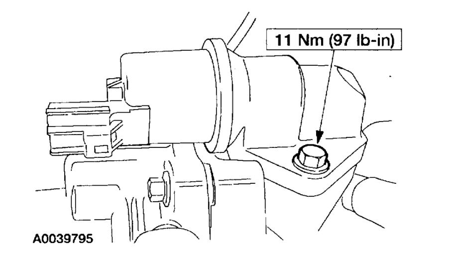

As far as the high idle, that is the idle air control. I attached the procedure for that as well.
https://www.2carpros.com/articles/how-to-replace-an-idle-speed-control-motor-iac
https://www.2carpros.com/articles/engine-idles-too-high

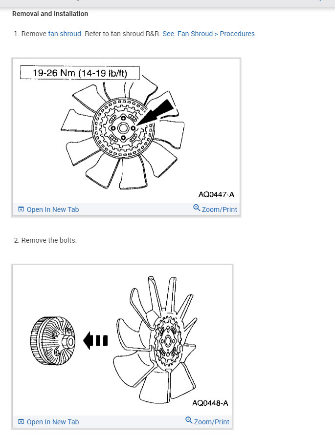

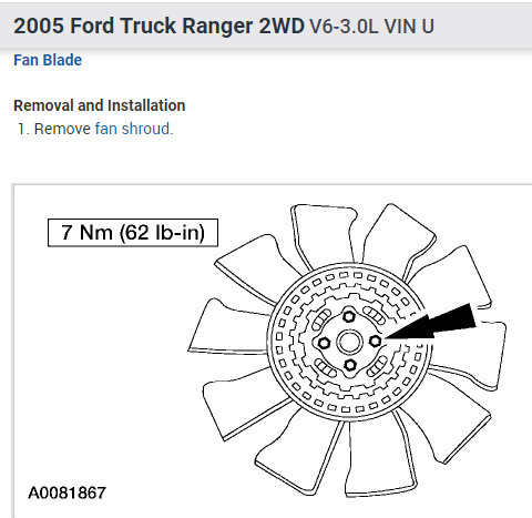

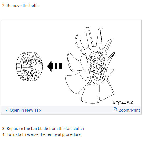

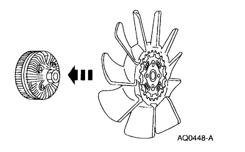

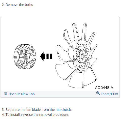

Fan - Blade
Removal and Installation
1. Remove fan shroud.
2. Remove the bolts.
3. Separate the fan blade from the fan clutch.
4. To install, reverse the removal procedure.
REMOVAL
1. Disconnect the battery ground cable.
2. Disconnect the Idle Air Control (IAC) valve electrical connector.
3. Remove the IAC valve and discard the gasket.
INSTALLATION
1. To install, reverse the removal procedure.
NOTE: Install a new IAC valve gasket.

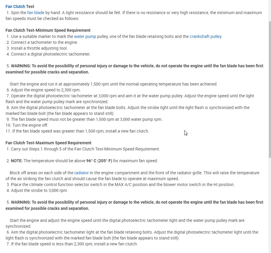

I noticed the fan clutch was loud and I let it be for a few months. I decided to change it and now it is way louder and it does it constantly. It never stops no matter what speed I’m at or even after the truck is warmed loud all the time. I heard you had to let it break in, but I been driving it for 3 days a lot and still the same.
Feb 21, 2021 at 9:46 AM (Merged)
It sounds like the fan clutch is locked up. I attached a test for the clutch but if it doesn't vary in speed and is loud just make sure you installed it the correct way (not sure you can install it incorrectly). I attached the procedure just to be sure.
Let me know what you find with this test and we can go from there. Thanks
