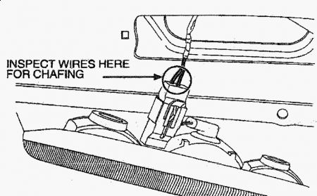

There is times when I turn the headlights on that the horn will come on and stay on till I turn the lights off. If its not the horn coming on it is the wipers and the fluid pump. This could last for a couple of days, then go away and not happen for a couple of weeks.

Have a look at the highmount light, the wires chafe and get grounded, try repairing that short, it may clear up the other issues since the wires go thru the multifunction switch.
http://www.2carpros.com/forum/automotive_pictures/62217_Higha_1.jpg
http://www.2carpros.com/forum/automotive_pictures/62217_Highb_1.jpg
Repair the rub spot and buy some conduit to cover it with.

Some 2003-2005 Ranger Super Cab vehicles may exhibit brake lamp concerns, fuse 2.13 open on
2003 Rangers, and fuse 2.19 open on 2004-2005 Rangers. This may be caused by a wire chafe at
the rear high mount stop lamp.
ACTION
Repair the wire harness at the rear high mount stop lamp. Add protective convolute to the wire
harness to prevent reoccurrence. It is not necessary to disassemble the interior to access the
harness. The harness can be accessed by removing the rear high mount stop lamp only. Refer to the
following Service Procedure.
SERVICE PROCEDURE
NOTE: THE SHORT WILL OCCUR AT C927 ON 2003 RANGERS AND AT
C904 ON 2004-2005 RANGERS.
Remove the rear high 1. mount stop lamp.
Carefully pull the lamp away from the body, and all of the loose wire harness from inside
the roof panel.
2.
Inspect the wire harness near the connector (Fig. 1 ) to determine if there is a short to the
roof panel inner support.
3.
Fig. 1: Location On Wire Harness Chafing
If no chafing is found, follow the diagnostic procedures found in Section 417-01 of the
Ranger Workshop Manual.
a.
If chafing is found, repair the damage and install a 2" (51 mm) piece of 114-318"
diameter convolute (obtained locally). Push the convolute all the way up the harness
to the connector (Fig. 2 ).
b.
Fig. 2: Convolute Installation
4. Secure the convolute to the harness connector with electrical tape (Fig. 3 ).
