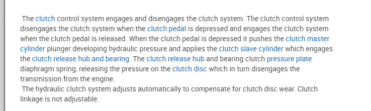

does this model have a self adjusting clutch. i was told you could back up letting out on pedal repeatedly to adjust.
Jun 3, 2010 at 2:35 AM

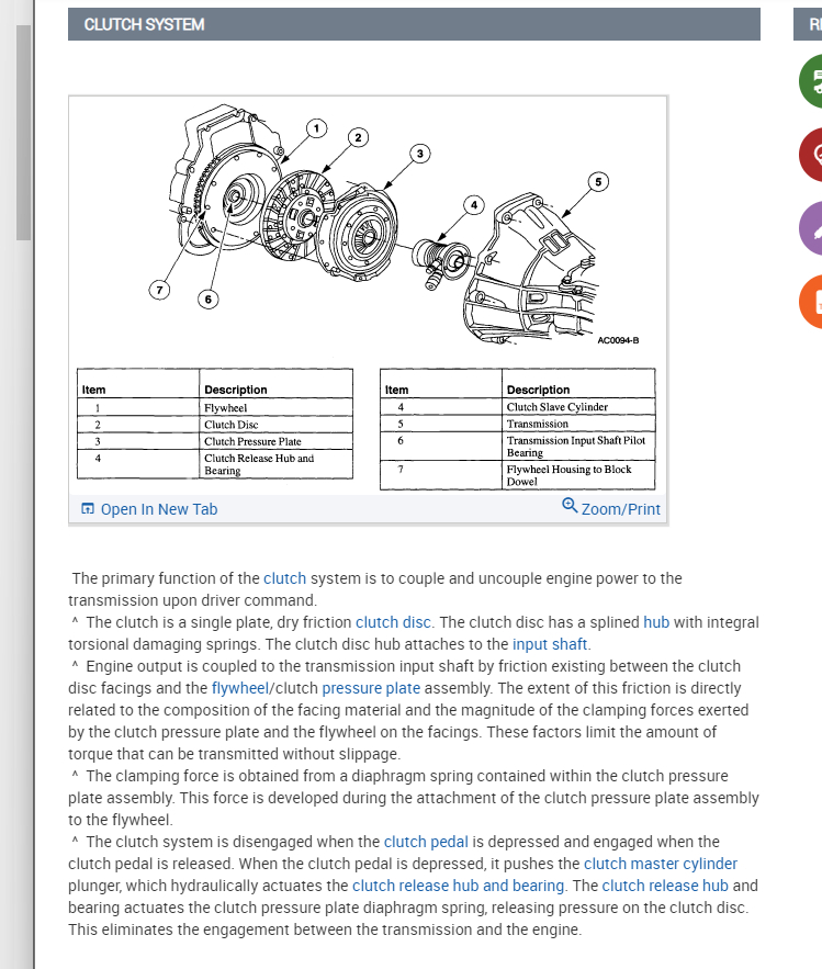

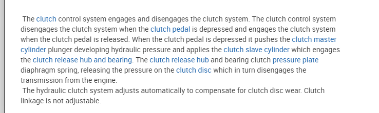

This is a self-adjusting clutch system because it is a hydraulic clutch. So, it will automatically adjust to compensate for wear on the clutch disc.

Also, I am attaching the info below on this system which will give the detail about how it is not adjustable.
