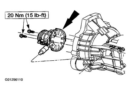

The clutch went out. When I depressed the clutch there was a kind of a pop noise then the compression decreased to about half of what it normally is but I was still able to change gears although the clutch engaged much sooner then usual. 8 hours later there was no compression at all and the only way to get it in gear was the turn off the engine and start the engine in gear. What is the fix for this?

Have you checked the slave cylinder on the tranny for leaks? or the line...

Inbox :: Message From: keefer50 To: merlin2021 Posted: Sat Nov 03, 2007 10:52 pm Subject: slave cylinder your replied to my original question about my clutch that went out - you said to check the slave cylinder - which I did and it looks like it is where the clutch fluid is leaking to. What is involved in replacing the slave cylinder? Does the transmission need to be taken off? Is it an easy fix? Thanks very much for responding!! Yes the tranny needs to be out to replace the slave...
https://images.2carpros.com/forum/automotive_pictures/62217_Slave_copy_1.jpg

Replace the leaking clutch slave cylinder. The transmission must be removed to access and replace it; also inspect the hydraulic line for leaks.
