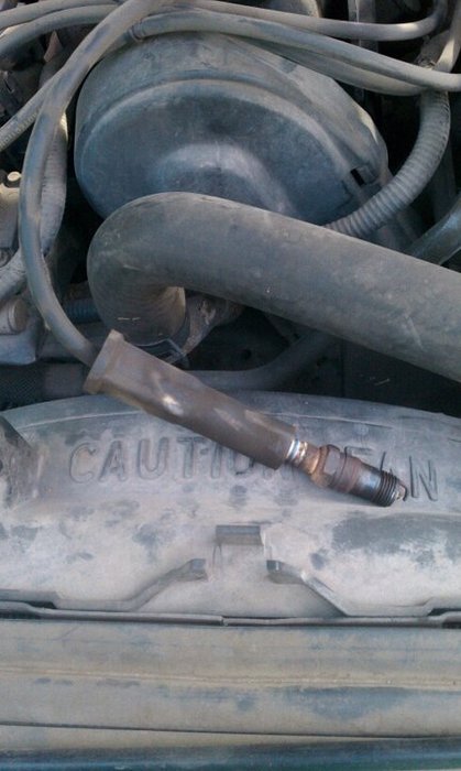

I have a 1994 Ford Ranger with a manual transmission. For a few weeks the car was making a little clanking noise. One morning a loud noise came from under the hood and the car lost power. The engine became terribly loud, sounding like a lawn mower. When driving it home, the top speed was about 5 mph. When inspecting under the hood, everything looked normal, but I can smell gasoline. Any idea of what the problem could be? It's an old car and I don't want to waste a tow to a shop if it's a huge repair. Thanks so much in advance.

FREEMBA
  • 1,152 POSTS
Check the spark plugs one of them may have blown out of its hole. This would kill you power and make a horrible racket.
Let me know if that's it. If not we can check further.
+3
Thursday, January 3rd, 2019 AT 10:03 AM (Merged)
STAYLOST
YES! You were right. I grabbed around the engine and it was just lying there. Am I able to screw it back in myself, or should I purchase a new one?
+2
