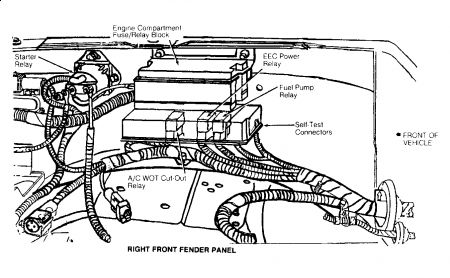

1989 Ford Ranger 4 cyl Two Wheel Drive Manual 84.000 miles
i been told to look on the right inside fender to find the pump relay,but in some manuals it shows the map sensor and the fuel pump mounted on the wall,but on my truck there is power bus mounted on the wall there is no relays there,where else possible could this pump relay be?..thank you for your time...Help

Your fuel pump relay is located on the right front fender panel on the relay block, pictured below..
https://images.2carpros.com/forum/automotive_pictures/261618_Graphic_2.jpg
