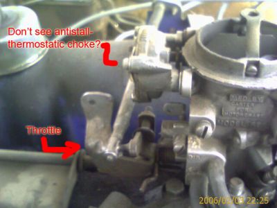

REVOLUTION0
  • 28 POSTS
so I got to looking... there is no antistall dashpot on my vehicle. theres also no indication one was previously there/removed. ill take that as less troubleshooting to do and try to find a dwell meter. also I noticed there is some fluid (looks like oil maybe) that is or has leaked from the fuel pump. I don't think its gas since gas dries quickly... this stuff still looks a little wet. ill consult someone to help me with the dwelling though since I'm not familiar with it.

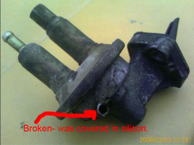

You might want to pull the fuel pump line and test the volume, should be a pint in 30 seconds I think, afterall we are going way back on this one! Do you have a manual or at least the impotant specs for the car? Investigate the leak at the pump! Yes I know it's a Ford!

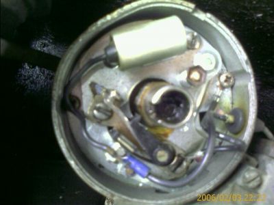

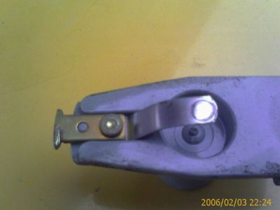

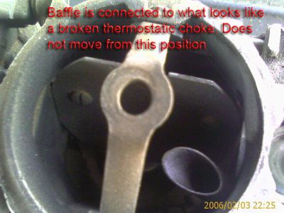

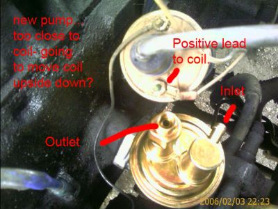

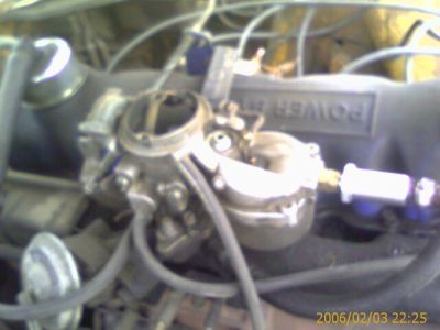

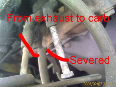

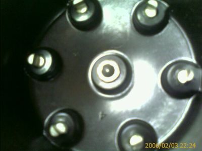

I don't have any way of testing vaccuum personally. I do however have some pictures I took today after replacing the fuel pump. I wasn't able to see if the fuel pump made things better (my upper radiator hose I bought doesn't fit...) I'm going to photoshop them and I'll post the links.

Choke thermostat is important, remove the 3 screws holding the bakelite cover on, an install the new spring. They used to make a replacemet tube for the exhaust, if you can't find one try plumbing supply, for a copper icemake line. I could not read the part about the plastic piece..

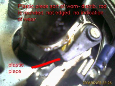

It said that the distributor rod is rounded where it meets the plastic piece (not edged) but does not appear to be worn. The plastic piece however does show signs of wear (little plastic fragments coming off). I'm just not sure what that "plastic piece" is called: Never worked with distributors- especially points systems. I've been thinking about just getting a conversion kit for electronic but I can't seem to locate one. They're all for Chevy V-8s it seems like... I'll fix that exhaust tube with some copper plumbing and maybe put some high-temp cold weld on it or something. By the way- that choke-looking-thing on the left of the carb in picture 4 looks like it has silicon all over the backside of it. There also is no spring there to move it: can the whole module be replaced? I don't know what the heck the previous owners were doing to this thing, but I don't much care for jimmy-rigging anything.
EDIT: I'm gonna go make a run to the performance parts store and try to order an electronic kit. If anyone in town can they can. I'll also see if they have the choke module.
EDIT2: Bought a new hose so I can test the car now. Bought a vacuum advance- it's on order. Figured it'd be better to spend the $20 dollars to replace it than the $70 dollars to buy a vacuum to test it. We should know how things are working by ~3:00PM PST (my timezone). The ASE cert. parts tech said if I could get it in driving order to stop back by to get the vaccuum lines checked and replaced. So I'll probably do that too.
Apr 21, 2008 at 4:08 AM
MERLIN2021
  • 17,250 POSTS
That plastic piece is part of the points! if it's crumbling, replace them, it's all one piece...Points is one of the most important parts of your ignition system...You better know how to adjust them. Or at least have the gap spec! The carb part you need so the choke will close is the choke thermostat, it's a round cioil that fits under a black cover on the side of the carb. Also if the points are that bad get the conderser as well....

So I got the new radiator hose on, repositioned the coil so it didn't arc against the fuel line and test drove it. It seems maybe a tad better? It's so freakin' weird! It drove PERFECT up until the final gear at about 60MPH then started jerking again. Pulled off to turn around and between shifting I let it idle: it idled PERFECT with no sign of wanting to die. Get back on the road and go up the hill at 50MPH- Didn't even act like it had a problem so I passed my house thinking I would max it out as much as the road let me. Once again at 60MPH it nearly died (I have custom exhaust so it's normally loud) and nearly went silent. It didn't die though, so I pulled off to turn around again. SAME THING- Idled PERFECT. Drive back doing about 45-50MPH with NO hesitation or issues.

Points arent a bad system, just not AS reliable as electronic...Youll need a set of feeler gauges to set the points, put distributor lobe, thats the worn spot you thougfht! so it is opening the points as far as it can, then set the gap. Tighten the back screw on the points, then use a flat screwdriver on the front end of the points, where the notch is to spread or close the point to match the required gap, then tighten the front screw! The dwell meter is used when it's runnung to check dwell, or how long the points are closed....if it's off, and you want to set dwell at the lower end of the spread to allow for wear, re-adjust the gap...

EDIT: Changed out the old points system- WOW was it pitted! Wasn't gapping at all! Installed the new points system and gapped at .018. Replaced the PCV valve (figured might as well call it a full service tuneup) and the advance vacuum hose/line. Put the distrib. cap back on and tested- EVEN BETTER RESPONSE THAN PERFECT! I didn't know it could run that good! Haven't tested at freeway speeds, but man this thing runs STRONG!!!
