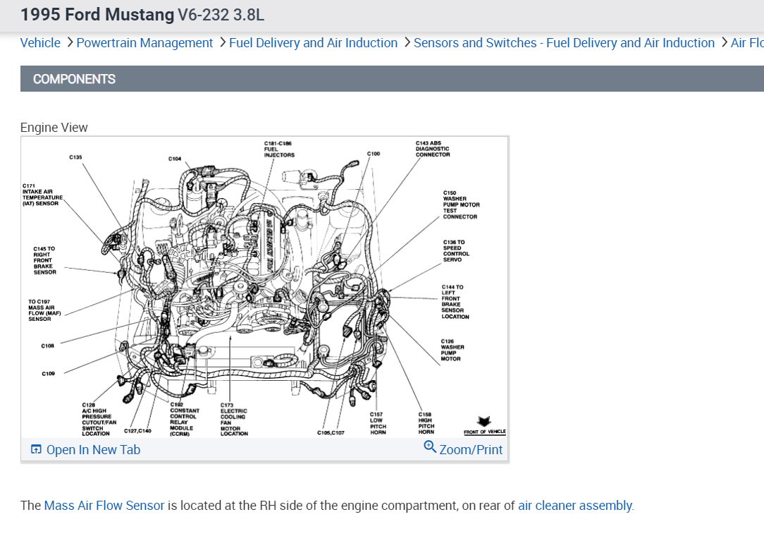

on my 95 Mustang Convertible 3.8L these are the codes im geting bank 1 and 2 to lean what shoud I try would it be the fuel mixture and if thats It how do I adjust it on this car

This problem is usually the mass air flow sensor or a vacuum leak, here is a guide to help with the leak and the MAF sensor location in the images below. Be sure to test for the leak when the engine is cold.
and
https://www.2carpros.com/articles/repair-lean-mixture-codes-p0171-or-p0174-on-some-manufacturers
Check out the images (Below). Please let us know if you need anything else to get the problem fixed.

Do not try to adjust the fuel mixture. For P0171 and P0174 on this Mustang, check for a vacuum leak with the engine cold and inspect or test the mass air flow sensor.
Conversation Summary
The owner of a 1995 Ford Mustang Convertible 3.8L reported P0171 and P0174, indicating both banks are running lean, and asked whether the fuel mixture could be adjusted. The expert said the usual causes are a faulty mass air flow sensor or a vacuum leak, advised testing for leaks when the engine is cold, and provided repair guides. After the owner reported a broken link, the expert said the links were fixed.
