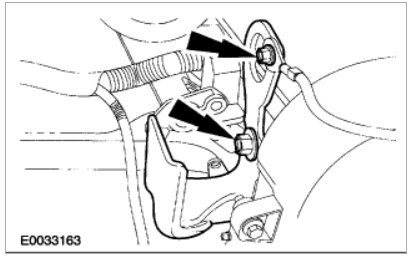

HAMMERTOE
Electrical problem
2003 Ford Focus 4 cyl Front Wheel Drive Manual 97,000 miles
Need to replace the alternator; 2003 Focus with ztec engine. It is wedged in there between the engine and firewall. This looks to be a pain; am I right? Is there a trick/shortcut to it? I'm half afraid to go buy a manual....disassemble the right wheelwell assembly, pull the transmission, etc. I'm doing this tomorrow and need the car the next day. Thanks
HT
Dec 2, 2017 at 8:11 AM (Merged)
DANABR2002
[quote:a8f4be1b92="2CarPro Ken"]Hi, Ford had a recall on the battery cables for that car, check your cables for burned marks near the battery terminals and get back to me.[/quote:a8f4be1b92]
Ken, I really apologize for my ignorance. My DMV papers incorrectly list this car as 2001; in fact, it's 2002 Ford Focus SE (4 Door).
Does this change anything?
Thanks.
HAMMERTOE
Got it done with no help from this forum. The trick is to take out the 3 big bolts that hold the engine mount to the right wheelwell, jack up the engine a little and push it forward enough to get the alternator out. I learned a trick all by myself !

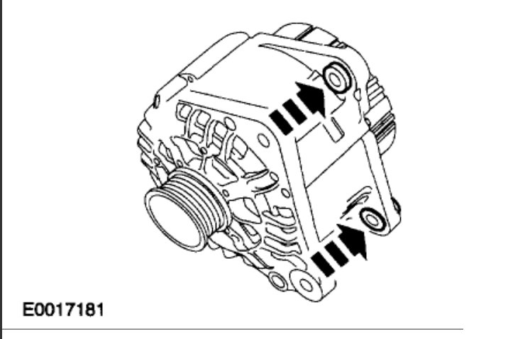

BMRFIXIT
  • 19,053 POSTS
GENERATORS & REGULATORS -2003 Ford Focus ZX5
Page 1 of 1
Removal and Installation (2.0L Zetec-E)
1.Disconnect negative battery cable. Protect generator with lint-free material to prevent contamination. Remove the fuel pressure sensor. Remove accessory drive belt. 2.Remove bolt securing coolant overflow bottle. Remove coolant overflow bottle, and position aside. Remove power steering reservoir, and engine wiring harness bracket, and position aside. Disconnect ground strap near right front shock tower. See Fig. 3 . 3.Remove evaporative emission canister purge valve, and position aside. See Fig. 4 . Disconnect the cylinder head temperature sensor electrical connector. See Fig. 5 . Disconnect the ground cable on engine lifting eye and remove the engine lifting eye. 4.Remove ground cable on frame rail at right side of engine. See Fig. 6 . Mark the position of the engine mounting. Remove front engine mounting retaining bolts. See Fig. 7 . Slide engine towards front of vehicle and reinstall one of the retaining bolts into rear bolt hole to prevent engine moving backwards. See Fig. 8 . 5.Disconnect electrical connectors from generator. Lower retaining bolt must be fully disengaged from the bracket although it is not possible to remove the bolt at this stage. Unscrew 2 generator mounting bolts and remove generator from vehicle. 6.To aid in installation, slide back the generator locking sleeves. See Fig. 9 . To install, reverse removal procedure. Tighten fasteners to specification.

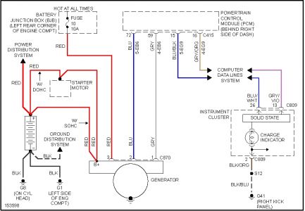

HOTROD1976
Electrical problem
2002 Ford Focus Two Wheel Drive Automatic 120000 miles
im working on a 2002 ford focus and im wondering does the pcm control the regulater in the alt ive changed out the batt and alt twice but it still is charging way too high 15v what do i need to check next
BLUELIGHTNIN6
  • 16,542 POSTS
i've posted charging system's wiring schematic below, let me know if you need further assistance..

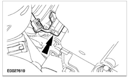

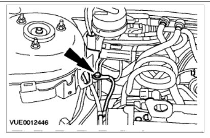

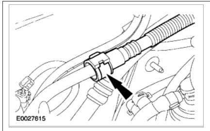

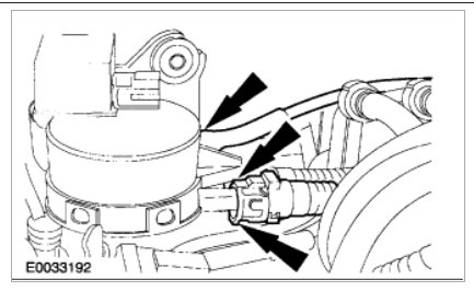

BMRFIXIT
  • 19,053 POSTS
1.Disconnect the battery. For additional information, refer to BATTERY, MOUNTING AND CABLES .
2.Remove the upper generator nut.
3.Remove the generator heat shield top nut.
4.Raise and support the vehicle. For additional information, refer to JACKING AND LIFTING .
5.Remove the screws and the accessory drive splash shield.
6.Release the accessory drive belt tension and remove the belt from the generator pulley.
7.Remove the generator heat shield lower nut and the heat shield.
8.Release the two air intake tube retainers and remove the air intake tube assembly.

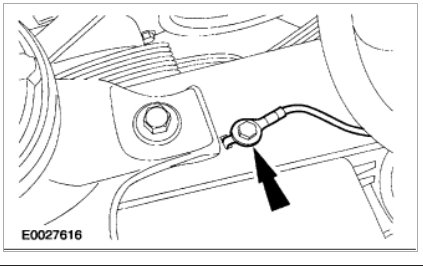

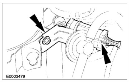

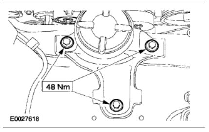

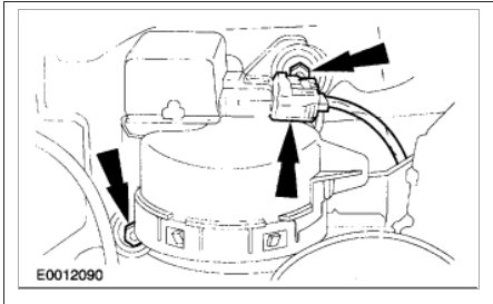

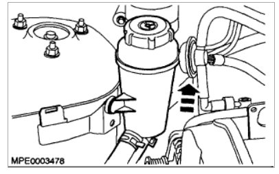

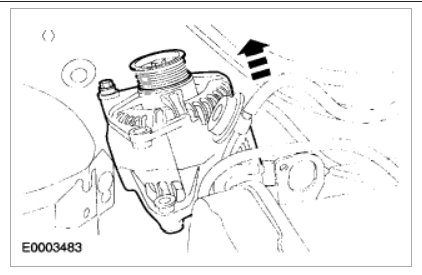

FULLEROPAL
Engine Mechanical problem
2001 Ford Focus 4 cyl Front Wheel Drive Automatic 100000 miles

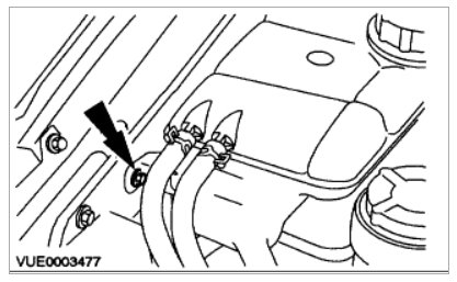

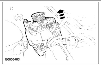

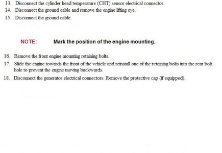

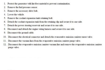

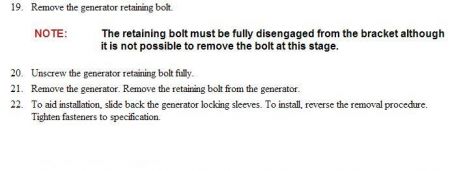

I can't get the old alternator out. Do I have to take the motor out to be able to replace the alternator?
Dec 2, 2017 at 8:12 AM (Merged)

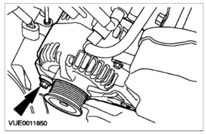

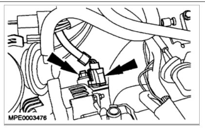

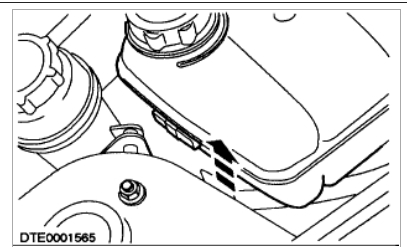

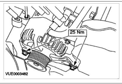

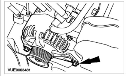

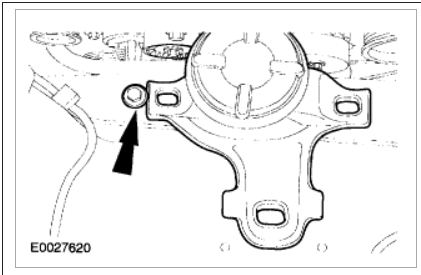

BLUELIGHTNIN6
  • 16,542 POSTS
Try these procedures below, also disconnect the right motor mount at the right strut tower to allow extra motor movement, then pull the engine forward enough to allow room to remove the alternator from the top.
https://images.2carpros.com/forum/automotive_pictures/261618_Noname_671.jpg
https://images.2carpros.com/forum/automotive_pictures/261618_Noname2_170.jpg
https://images.2carpros.com/forum/automotive_pictures/261618_Noname3_64.jpg
