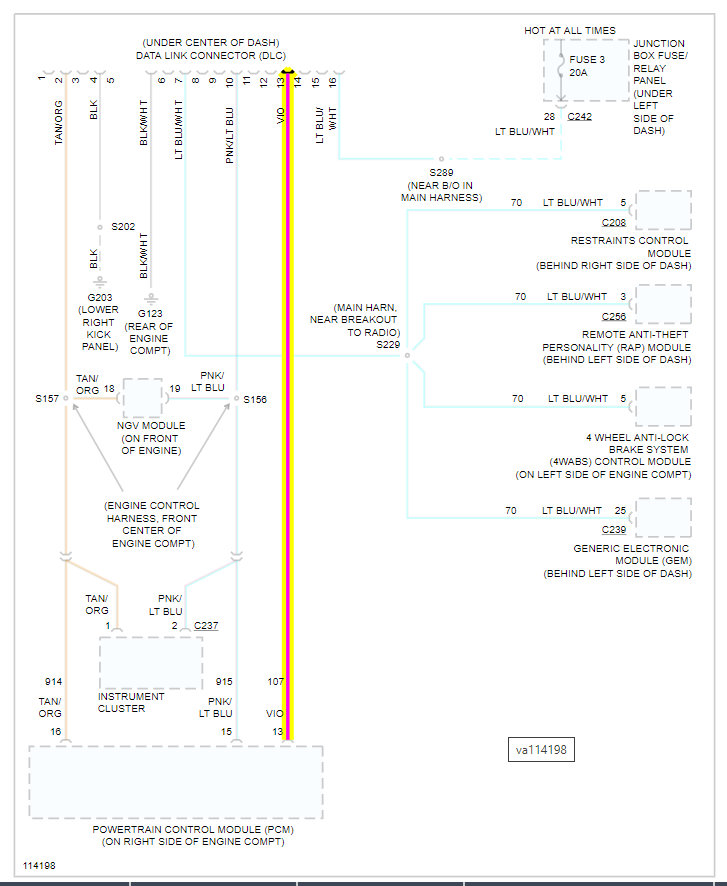

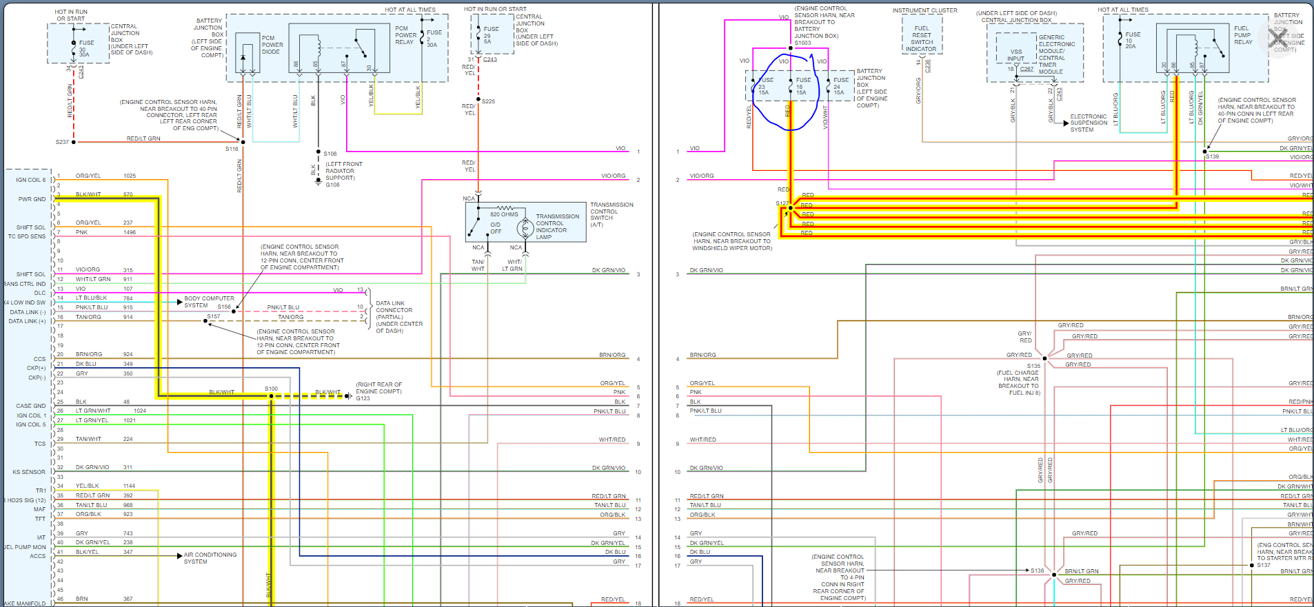

put a rebuilt motor and transmission in, it has less than 5 miles on it. now it will not start or turn over ob2 reads no-link. replaced PCM still reads no-link. replaced it again still reads no link. took it to auto repair place they can't figure it out and they are very good mechanics.
Oct 1, 2021 at 10:43 AM
Good afternoon,

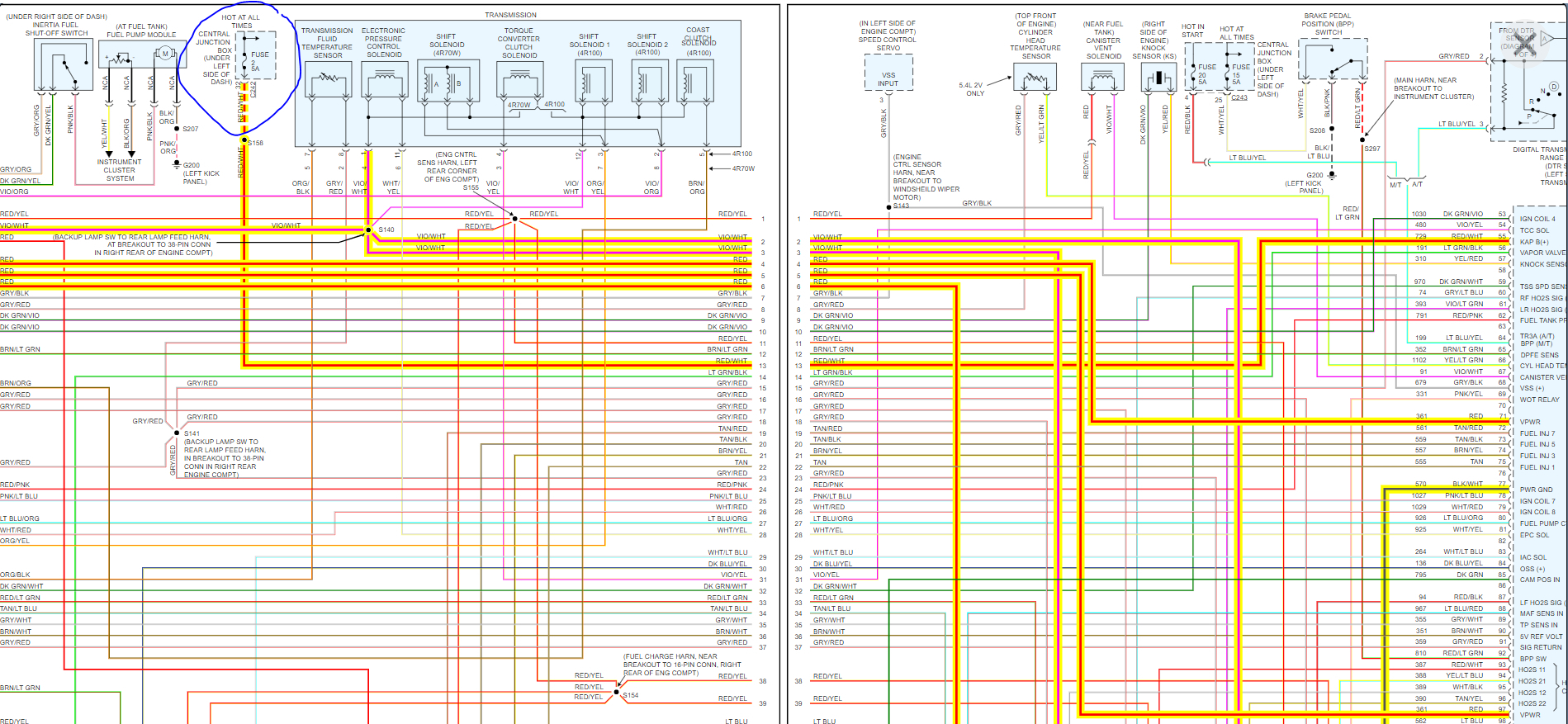

I attached the wiring diagram for you of the system with the powers to the PCM. Verify there are powers to the pins for power and the grounds need to be verified as well.
When you turn the key to the on position, does the check engine light come on?
Oct 1, 2021 at 11:02 AM

oh, one more thing on the ob2 i have power on pin 16 and ground on 4 and 5 that seems to be what everyone asks me. but i always thought if the ob2 tool reads no-link it has to have power and ground. or maybe i am wrong.

You need the power to pin 16 and pin 4. That will power up the scan tool.
This is a different issue.

yes, the engine light comes on and i can hear the gas pump running.
Oct 1, 2021 at 3:32 PM
Then there is nothing wrong with the PCM.
You need to start unplugging components to see if it starts to communicate.
Sensors are a good start.
Oct 1, 2021 at 4:04 PM

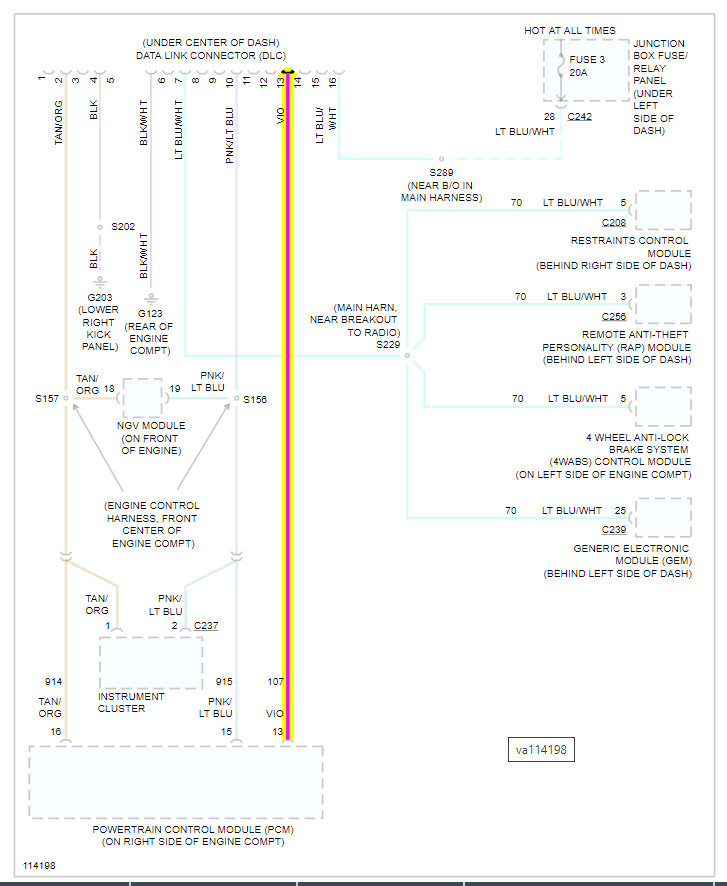

Just to jump in on this one as I have seen this a couple times. First, we need to know if this specific scan tool has ever communicated with this truck before? Also, the shop that you took it too, they had the same issue of not being able to communicate with the PCM?
Next, we need to check the voltage on pin 13 at the DLC. If you are not getting any voltage, then go to the PCM and check on the same wire to see if anything is coming out of the PCM.
Next check voltage on pin 2 and ground. Then 10 and ground.
If you look at the wiring diagram, it is possible you have an issue with the cluster that is corrupting communication as Roy mentioned so you can try unplugging that and see if you can communicate with the PCM.
The NGV module that is shown as well is natural gas module, so you most likely don't have that module. If you do, unplug that as well. It may be there even if this is not a NGV truck.
If you have replaced the PCM multiple times and it is not communicating, then that leaves a scan tool issue or wiring issue.
So, let's check each of these pins for voltage and go from there. Thanks
