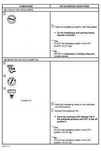

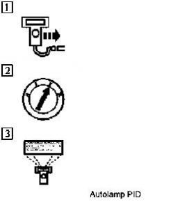

I believe we are talking about two different things here, hehe. The day time running light unit is probably faulty, which is causing the lights to stay on. Your switch that you are talking about is the one that enables the lights to stay on for a brief amount of time after leaving vehicle, correct? In any event, here are four tests to do to check for faulty unit. Post your results and I will have more tests to do if the problem is not fixed. Before doing these, check all of your fuses and relays, inside the cab and also under the hood. Make sure all of the wiring is good and not loose or melted looking. Make sure fuses are not blown and power is getting to them. Fuse 19 (5 amp) and DRL Full Relay No.1 are the main two that need checked.
https://images.2carpros.com/forum/automotive_pictures/261618_Graphic_15.jpg
https://images.2carpros.com/forum/automotive_pictures/261618_Graphic2_1.jpg
You may need to save graphics to your PC then resize them to better read the small print.

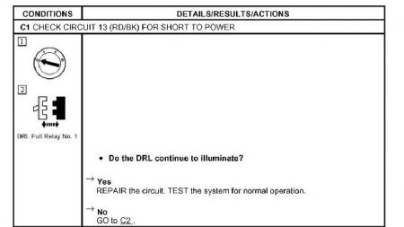

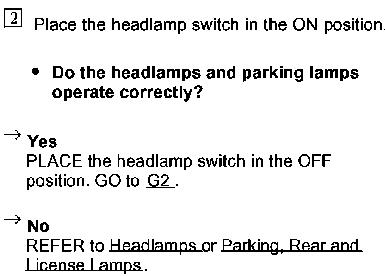

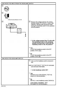

Okay. Lets try this. I have posted the first four steps along with the figures that go along to help you out. I had to separate them to enlarge them so let me know if this helps. If one of the steps lead you into another test or step 5 or beyond let me know, as I only have first 4 steps posted. FIRST STEP FIGURE
https://images.2carpros.com/forum/automotive_pictures/261618_6_1.jpg
SECOND STEP FIGURES
https://images.2carpros.com/forum/automotive_pictures/261618_5_1.jpg
THIRD/FOURTH STEP FIGURES
https://images.2carpros.com/forum/automotive_pictures/261618_7_1.jpg
STEP 1
https://images.2carpros.com/forum/automotive_pictures/261618_Noname_17.jpg
STEP 2
https://images.2carpros.com/forum/automotive_pictures/261618_Noname2_4.jpg
STEP 3
https://images.2carpros.com/forum/automotive_pictures/261618_Noname3_2.jpg
STEP 4
https://images.2carpros.com/forum/automotive_pictures/261618_Noname4_1.jpg

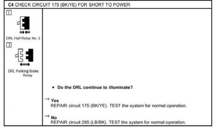

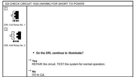

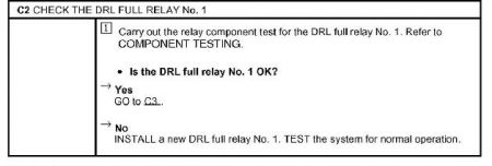

Okay, it sounds like there is a short somewhere in the wiring for the daytime running lights. Sooo, here is what we check now.
https://images.2carpros.com/forum/automotive_pictures/261618_3243_1.jpg
https://images.2carpros.com/forum/automotive_pictures/261618_Noname_18.jpg
https://images.2carpros.com/forum/automotive_pictures/261618_Noname2_5.jpg
TEST RELAY BY SIMPLY SUBSTITING ANOTHER RELAY INTO IT'S SPOT. YOU CAN ALSO HAVE AN AUTOPART STORE TEST IT FOR YOU. LOCATION OF DRL RELAYS:
https://images.2carpros.com/forum/automotive_pictures/261618_Noname_19.jpg
https://images.2carpros.com/forum/automotive_pictures/261618_re_1.jpg
https://images.2carpros.com/forum/automotive_pictures/261618_Noname3_3.jpg
https://images.2carpros.com/forum/automotive_pictures/261618_Noname4_2.jpg

I did do step 1, removing DRL relay 1. Lights stayed on.
By the way, I know in the past I have set the parking brake and the DRL stayed on then too.
Since in check 1 it says I now need to repair the circuit. Is that true. Is that something I can do?
Dec 7, 2008 at 9:49 AM
BLUELIGHTNIN6
  • 16,542 POSTS
Step 1 is to Check Circuit 13 (red/black wire) for short power.
You removed the relay and the lights STILL stay on? ?
Remove BOTH of the DRL relays. Lights shouldn't be able to stay on without the relays..
There is a DRL Parking brake relay that may need to be checked..hmm.
I tell you what, if removing these 3 relays still allows the lights to remain on, I am going to say that you have stumped me. But I will go ahead and invite one of the techs with more experience with electrical issues into this posting so we can get this fixed. If you don't care go ahead and remove BOTH of the DRL relays and the Park Brake relay which is also located in the auxiliary relay box No. 2

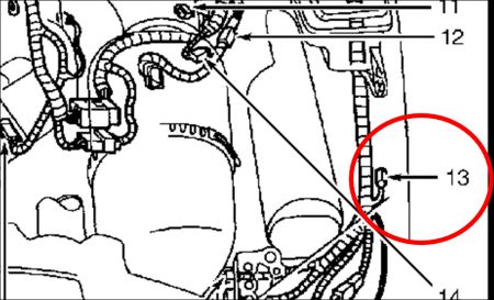

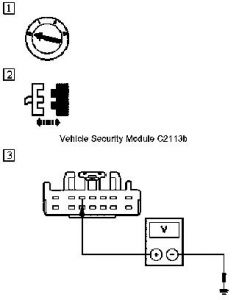

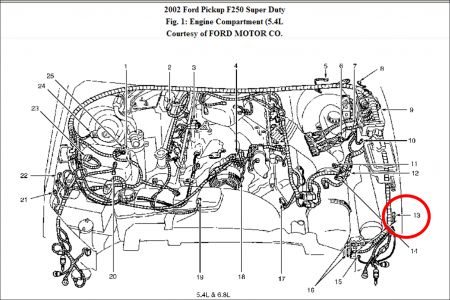

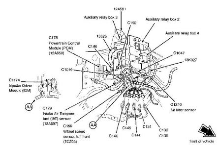

Hello - bluelightnin6 and I have been discussing this and we have decided to see if you would check connector C196.....it is the daytime running lamps resistor located in the engine compartment, front, LH side. Item 13 on the two pics I have attached. I gave you one with a far out shot showing the approximate location and then a blown up one for more detail If you would, disconnect that and see if the lamp goes out. Meanwhile we will do some more looking and discussing.....please let us know what happens.
https://images.2carpros.com/forum/automotive_pictures/248015_1_105.jpg
https://images.2carpros.com/forum/automotive_pictures/248015_2_69.jpg
Dec 7, 2008 at 11:45 AM
  • 75,992 POSTS
Remove fuse no. 30 15amp and tell me if the L/lamp still lit- I viewed your headlamps electrical circuitry and its a mess to deal with w/o electrical background do you have experience ? If not bring it in to the pros-this one here can be a nightmare to remember w/o experience.
BTW I was asked to assist in this matter by Mr. Blue
Dec 7, 2008 at 11:47 AM
IMPALASS
  • 3,112 POSTS
One last thing……….if disconnecting the resistor plug did nothing and if removing fuse 30 as rasmataz suggested did, I would also look at removing fuse 7 to see if that made it go out. Then we can track from either fuse 7 or 30.
Dec 7, 2008 at 12:47 PM
