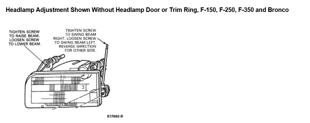

I have tried looking for the headlight adjuster, but i have had no luck finding it.

it is either under the headlamp door or trim ring. see picture, one is on top other on front.
