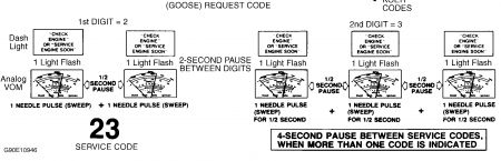

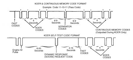

The gray/w/red is the signal return from PCM this will give us the codes? The red w/green are power to DLC and power to MIL so i'm guessin the MIL bulb has blown because the wire has power going through it? I'm showing a white/purple wire for the signal in to PCM from DLC/scan tool . So theoretically the PCM is working and the DLC has power to it so your tech should have got a link. It could be that he didn't have the correct scanner Diesel cars are different untill 2004 when they became intergrated into the generic system. Do you think you could read the codes in the step's I posted earlier using a voltmeter?

Yes, I belive I could read the codes. I will need to go and get a cheap analog voltmeter. The only one I have is digital. I can not see the diagram very well to make out the smaller writing on this thread. Can you send a blown-up version of it to my e-mail?

I never recieved any PM, sorry i had to go out last night ? let me know if you can see this any better ?
https://www.2carpros.com/forum/automotive_pictures/266999_dtc2_2.jpg
https://www.2carpros.com/forum/automotive_pictures/266999_dtc3_1.jpg
Friday, December 19th, 2008 AT 3:30 AM
OLEFOGY
  • 19 POSTS
Hey thanks. I can read see those alot better. I will work on the truck later today and let you know what I find out.

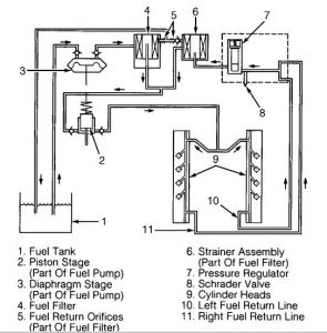

I suspect the fuel pump is the fault if you are not getting fuel to the filter assembly !! The pump is a mechanical pump using a camshaft lobe and a diaphragm to pump fuel ..the PCM controls fuel injection and glow plug control !!
The fuel system used on 7.3L Direct Injection (DI) turbo diesel engine is:
Controlled by Powertrain Control Module (PCM).
Comprised of a two-phase fuel pump.
Uses a one-piece fuel filter, water separator and fuel heater assembly.
Fuel is drawn from fuel tank by fuel pump, then under low pressure is circulated through fuel filter and back to fuel pump to be circulated under high pressure to cylinder head fuel galleries. From there, fuel is delivered to combustion chambers through electronically controlled/hydraulically actuated fuel injectors. A vacuum switch mounted on fuel filter housing monitors vacuum in fuel filter. When vacuum exceeds 7 psi, vacuum switch closes, causing PLUGGED FUEL FILTER indicator on instrument cluster to illuminate. The cylinder heads are specially designed to incorporate electronically controlled/hydraulically activated fuel injectors located near center of combustion chamber.
https://www.2carpros.com/forum/automotive_pictures/266999_2502_2.jpg
Fuel Pump
The 2-phase type fuel pump is comprised of the following:
Fuel inlet (from fuel tank).
Inlet check valve.
Diaphragm, diaphragm rod and diaphragm spring.
Piston and piston spring.
Low-pressure inlet (from fuel filter).
Low-pressure inlet check valve.
"O" ring, oil seal and fuel seal.
Camshaft actuated tappet.
High-pressure outlet check valve.
High-pressure outlet (to cylinder head).
Low-pressure outlet check valve.
Low-pressure outlet (to fuel filter).
Fuel is drawn from fuel tank by diaphragm section of fuel pump. The fuel pump circulates fuel at about 3-10 psi (21-69 kPa), first through fuel filter and then back to second stage of fuel pump. During second stage, piston-actuated section of fuel pump supplies fuel at a pressure of about 40 psi (275 kPa) into cylinder head fuel galleries.
hope this helps ... let me know
