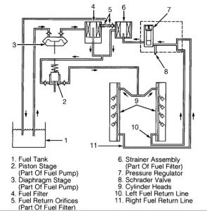

My step dad has looked at the truck and he says he believes it is getting fuel but he was unsure as he has only had experience in diesel tractors and has never messed with a powerstroke. There is a shrader valve on the side of the fuel filter housing and fuel seems to come out with pressure when you push in on the valve ( I am guessing that this where you would attach somthing to measure the actual pressure).
What is the approriate way to test for fuel?

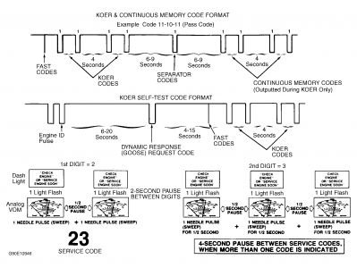

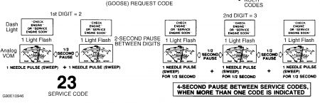

Check if there is fuel in fuel filter .. ? is the CEL/MIL on (check engine light) if yes we can try to retrieve codes using MIL or Voltmeter ??

KOEO & KOER SELF-TEST DTCs
All DTCs are 3-digit numbers. PCM outputs DTCs one digit at a time. These DTCs indicate current faults in system and should be serviced in order of appearance. Go to DIAGNOSTIC TROUBLE CODE IDENTIFICATION to find correct PINPOINT TESTS.

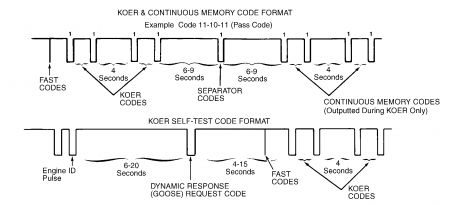

DTCs are shown as voltage pulses. If using MIL/CHECK ENGINE light, DTCs are displayed as light pulses. If using Volt-Ohmmeter (VOM), DTCs are displayed as needle sweeps. See Fig. 1 .
Pay careful attention to length of pauses in order to read DTCs correctly. A 1/2-second pause occurs between number of sweeps in a digit and a 2-second pause occurs between digits in a DTC. A 4-second pause occurs between each DTC. KOEO DTCs are separated from Continuous Memory Codes by a 6-second delay, a single 1/2-second sweep (Separator) and another 6-second delay. Record DTCs in order received.
Scan tool, if used, will count pulses and display them as a digital code. Star Series Tester will add a zero (0) to single-digit Separator Code (10) and Dynamic Response Code (10). Dynamic Response Code is displayed in KOER SELF-TEST. See Fig. 1 .
Separator Code
Single 1/2-second separator pulse is issued 6-9 seconds after last KOEO DTC. Continuous Memory Codes (soft faults) are then displayed 6-9 seconds after 1/2-second separator code. Some digital test equipment may display separator code as "10" instead of "1".

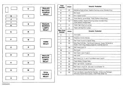

We don't seem to have power going to the PCM check fuse "I" in underhood fuse/relay box ..check all the fuses while you are there ? it must be getting fuel if the drain is letting fuel out ?? you can also try cranking it over ???

Ok, I both visually inspected and used a test lite. I do have power at fuse "I", but no power at fuses E, F, G, or U. I have not tried to crank it yet.

Also, after the truck had stalled and then not started again I had checked this fuse panel and saw that fuse "T" was burned out so I replaced it but it had no noticable effect on making the truck start.

Could you check fuse # 13 in interior fuse panel. Fuse T E F G are all related to the trailer plug. E is also for back up lamps? Fuse U is for PCM power relay coil. Check fuse # 13 inside fuse panel

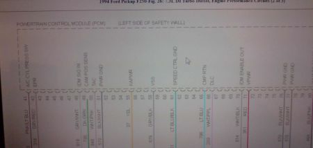

Have you got power to fuse "U" with ignition on? We also need to check we are getting power to pin 71 and pin 97 both red wires on PCM wiring connector (red wire) on multiconector to PCM on left side of firewall in engine compartment?
Wednesday, December 17th, 2008 AT 6:35 PM
DAVE H
  • 13,384 POSTS
Also check pin # 14 dark green/light blue wire this should ahve 12 volt's also at key on?

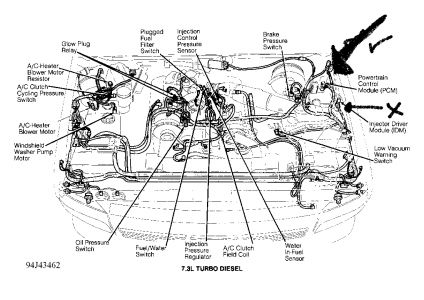

Is the PCM located inside the drivers front fender? If so I cannot locate a red wire. It seems as though there are two pinks. Do you have a diagram of the wires as they come into the PCM?
Wednesday, December 17th, 2008 AT 7:06 PM
DAVE H
  • 13,384 POSTS
You could also check pin #55 yelllow wire ..
https://www.2carpros.com/forum/automotive_pictures/266999_ppcm_1.jpg
https://www.2carpros.com/forum/automotive_pictures/266999_pcmwire_1.jpg

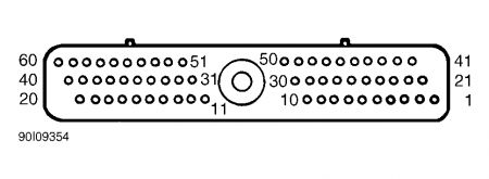

The connector terminal unplugged looks like this ??
https://www.2carpros.com/forum/automotive_pictures/266999_con1_1.jpg

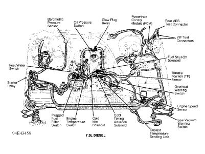

Does the the PCM have somthing to do with the injectors because the thing I am looking at says red striped wires carry 115v. If this is the case, the only color that matched the ones you gave me was yellow.
-1
Wednesday, December 17th, 2008 AT 9:09 PM
DAVE H
  • 13,384 POSTS
You are looking at the Injector Driver Module (IDM) 7.3L Turbo Diesel...In left side of engine bay. the one with the X in this picture ... you want the one above it with the "tick" large arrow it has a large wiring loom with 60 wires going to it ?? and a big plug as described in my last picture ?
https://www.2carpros.com/forum/automotive_pictures/266999_pcm_1.jpg
-1
Wednesday, December 17th, 2008 AT 9:44 PM
OLEFOGY
  • 19 POSTS
Oops, my bad for not saying turbo diesel in my initial disciption. Sorry for the confusion.
Yeah that second picture is was more helpful. Well, it is getting to be about the same time as it was last night when I quit so I am going to stop messing with it for tonight. I will test those wires in the morning and get back with you then. One more question, does the harness need to be bolted to the connector( firewall) in order for me to test the wires or can I take it loose and test light the pins where they come out of the end of the harness?
