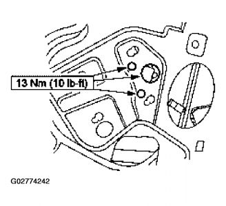

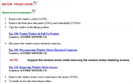

How do I replace the window motor in my 2004
F-150. Drivers Door? :Oops:

Remove interior panel, tape window in the up position remove 3 screws thru the door
