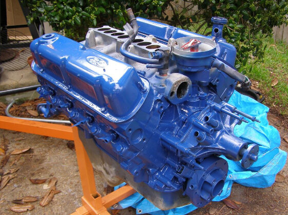

have a 1992 F150 scab 4x4 with 5.8L.
Originally had a 302, previous owner switched out to a long block 351. my question is. How can i tell what version it is, 351 W,C, or M? i want to buy a gasket set for it but not sure which version, didn't know if there was a tell tale way to tell.

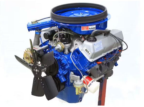

I think Modified and Windsor take the same set, Cleveland all plugs point the same way....
Nov 30, 2007 at 4:48 AM
  • 55,224 POSTS
they both do, here is the valve covers of each so you can see which one is which. The first one is a windsor and the other a Cleveland. Check out the images (below). Let us know if you need anything else.
