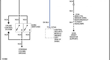

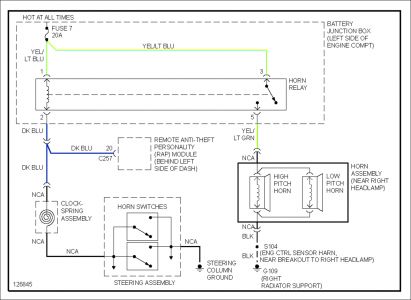

MERLIN2021
  • 17,250 POSTS

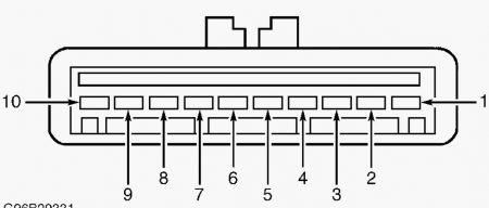

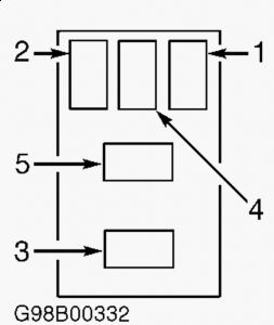

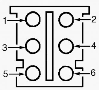

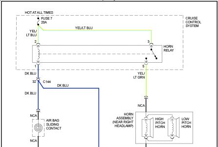

If you are brave enough, here's how to check it yourself... TEST G: HORN INOPERATIVE 1. Disconnect horn relay from battery junction box. Measure voltage between ground and horn relay socket terminals No. 1 and 3 (both Yellow/Light Blue wires). See Fig. 8 . If battery voltage exists, go to next step. If battery voltage does not exist, repair open in Yellow/Light Blue wire between horn relay and battery junction box. See WIRING DIAGRAMS . 2. Check horn relay. See HORN RELAY under COMPONENT TEST. If horn relay is okay, go to next step. If horn relay is defective, replace horn relay. 3. Measure resistance between ground and horn relay socket terminal No. 2 (Dark/Blue wire) while pressing horn switch on steering wheel. Resistance should be 5 ohms or less when horn switch is pressed and greater than 10 k/ohms when released. If resistances are as specified, go to next step. If either resistance is not as specified, go to step 6 . 4. Disconnect horn 2-pin harness connector No. C131. Horns are located on right side, behind front bumper. Measure resistance in Yellow/Light Green wire between horn relay socket terminal No. 5 and horn harness connector C131 terminal No. 1. If resistance is 5 ohms or less, go to next step. If resistance is more than 5 ohms, repair open in Yellow/Light Green wire between horn relay and horn. See WIRING DIAGRAMS . 5. Measure resistance between ground and horn harness connector C131 terminal No. 2 (Black wire). If resistance is 5 ohms or less, replace horn. If resistance is more than 5 ohms, repair open in Black wire between horn and ground, Ground is located on right side of radiator support. See WIRING DIAGRAMS . 6. Deactivate air bag system. See DISABLING & ACTIVATING AIR BAG SYSTEM in AIR BAG RESTRAINT SYSTEMS article in RESTRAINTS. Disconnect horn switch 2-pin harness connector. Measure resistance between horn switch harness connector terminals. resistance should be more than 10 k/ohms when horn switch is released and 5 ohms or less when horn switch is pressed. If resistances are as specified, go to next step. If resistances are not as specified, replace driver's side air bag module. See AIR BAG RESTRAINT SYSTEMS article in RESTRAINTS. 7. Disconnect clockspring 6-pin harness connector C218b. Measure resistance in Dark Blue wire between horn relay socket terminal No. 2 and clock spring harness connector C218b terminal No. 5. See Fig. 6 . If resistance is 5 ohms or less, go to next step. If resistance is more than 5 ohms, repair open in Dark Blue wire between horn relay and clockspring. See WIRING DIAGRAMS . 8. Remove driver's side air bag and disconnect upper clockspring 5-pin harness connector. Measure resistance in Dark Blue wire between clockspring harness connector terminal No. 5 and upper clockspring harness connector terminal No. 3. Measure resistance in Dark Green/Orange wire between clockspring harness connector terminal No. 3 and upper clockspring harness connector terminal No. 4. See Fig. 6 . If resistances are 5 ohms or less, go to next step. If either resistance is more than 5 ohms, replace clockspring. See CLOCKSPRING under REMOVAL & INSTALLATION. WARNING: Vehicles are equipped with air bag supplemental restraint system. Before attempting ANY repairs involving steering column, instrument panel or related components, see AIR BAG SAFETY PRECAUTIONS and DISABLING & ACTIVATING AIR BAG SYSTEM in AIR BAG RESTRAINT SYSTEMS article in RESTRAINTS.9. Disconnect speed control servo/actuator 10-pin harness connector C122. Speed control servo is located on left side of engine compartment. Measure resistance in Dark Green/Orange wire between clockspring harness connector terminal No. 3 and speed control servo/actuator harness connector terminal No. 6. See Fig. 6 Fig. 7 . If resistance is 5 ohms or less, go to next step. If resistance is more than 5 ohms, repair open in Dark Green/Orange wire between clockspring and speed control servo/actuator. See WIRING DIAGRAMS . 10. Measure resistance between ground and speed control servo/actuator harness connector C122 terminal No. 10 (Black wire). If resistance is 5 ohms or less, replace speed control servo/actuator. See SPEED CONTROL SERVO/ACTUATOR under REMOVAL & INSTALLATION. If resistance is more than 5 ohms, repair open in Black wire between speed control servo/actuator and ground. Ground is located on rear of right front fender. See WIRING DIAGRAMS . 11/24/2009 ...

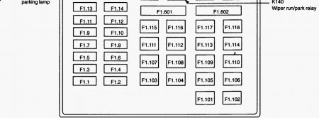

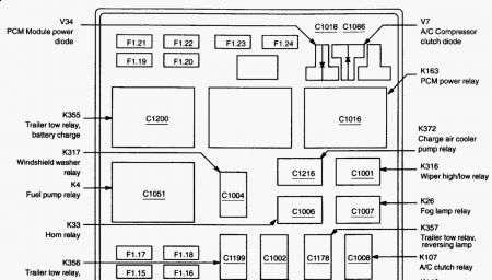

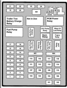

The horn relay is in the battery junction box under the hood, heres the legend:
https://images.2carpros.com/forum/automotive_pictures/62217_bjb1_1.jpg
https://images.2carpros.com/forum/automotive_pictures/62217_bjb2_2.jpg

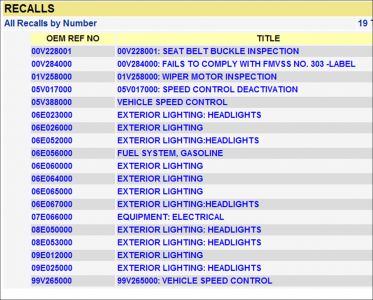

IMPALASS
  • 3,112 POSTS
Hello Also, it looks like you may have some recalls on your vehicle. The dealer may fix these for free. Please contact the dealer service department, give them the VIN number of your car and have them check on these to see if they apply to you.
https://images.2carpros.com/forum/automotive_pictures/248015_150_Recalls_1.jpg

Where exactly is the horn relay located in the fuze pannel? I have changer the clockspring, checked the horn themselves and still nothing. The cruise control does not work either.Don't know what else to check.
Jun 26, 2020 at 5:31 AM (Merged)
JDL
  • 16,098 POSTS
Hello, the horn relay should be located in the battery junction box, under the hood.
https://images.2carpros.com/forum/automotive_pictures/170934_horn_relay_1.jpg
One of the databases I looked at showed that picture. If you have an owners manual, it may list the location of fuses and relays? I just wanted to add, two of those terminals at the horn relay, should be hot all the time, just unplug the relay, use a testlite on the terminals. If you use a jumper with inline fuse on the two terminals for the load side of the relay, the horn should honk like crazy.
