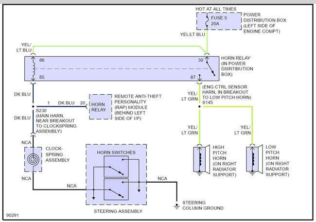

Where on the vehicle is the fuse for the horn Ford F-150
Nov 20, 2007 at 5:24 AM
  • 55,224 POSTS

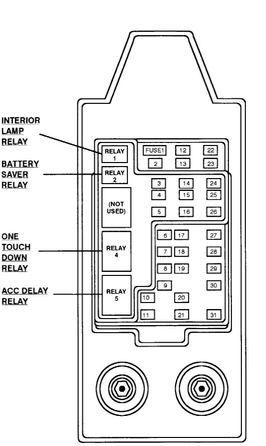

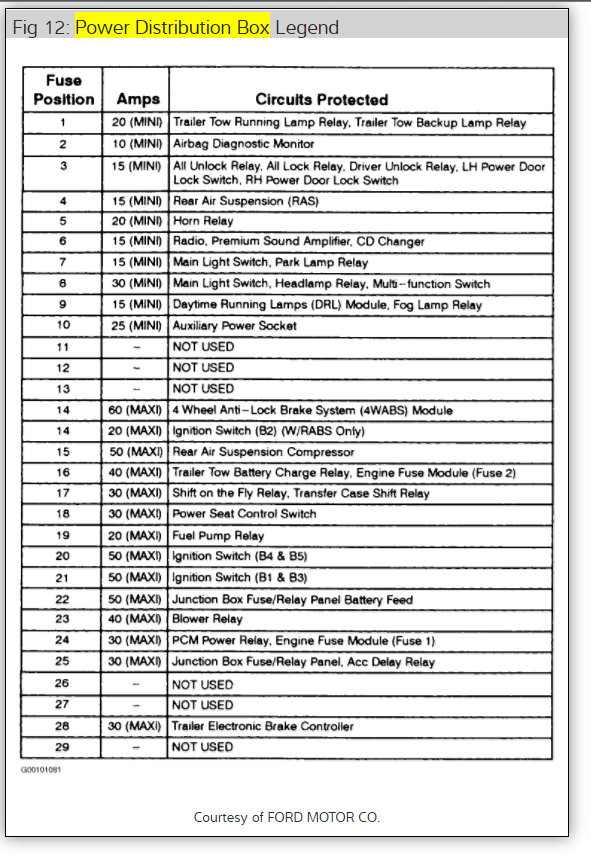

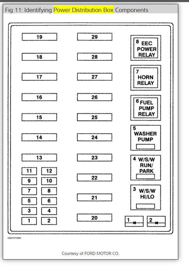

Hello, the horn fuse is in the power distribution center in slot number #5
Here is a diagram and a guide to help you see how to test for power.
Check out the horn wiring and fuse panel diagrams (Below). Please let us know if you need anything else to get the problem fixed.
