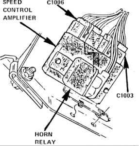

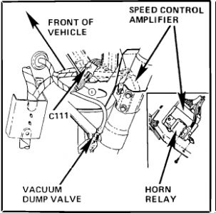

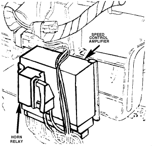

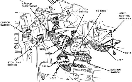

my truck decided to wake up my neighborhood about 2am with the horn blaring. cannot locate the horn relay to fix it as i really need my horn working in new orleans traffic. did i mention i am female repairing my own. thanks.
Nov 17, 2008 at 11:31 AM
IMPALASS
  • CAR REPAIR CONTRIBUTOR
  • 3,112 POSTS
Hello - Mardi Gras early.......like early in the morning - okay, maybe not. Well, you are getting 5 pics of where this thing is. I have never seen so many angles for a relay. Horn Relay With Speed Control Bronco F-150 thru F-350, E-150 thru E-350 and Super F Series The horn relay is use on vehicles equipped with speed control and is located under the left side of the instrument panel, left of the steering column and is mounted on the outboard attaching screw of the speed control amplifier module.
