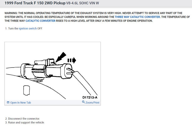

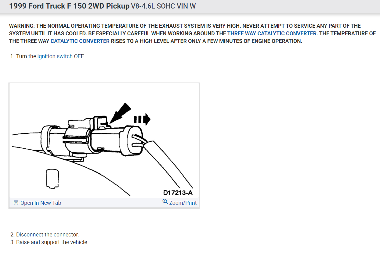

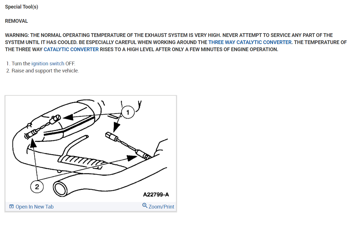

Yes faulty oxygen sensors will definitely hurt your MPG. faulty oxygen sensors can also lead to destroying the catalytic converter here is a guide to help change them with instructions below to show you how on your car.
https://www.2carpros.com/articles/how-to-replace-an-oxygen-sensor

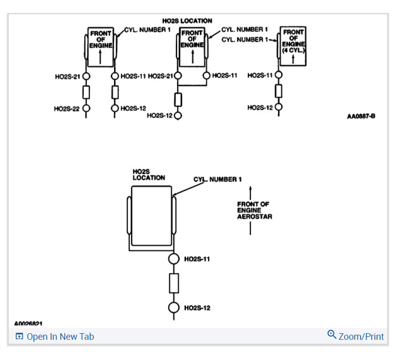

I have a 1996 f-150 4.9 I6 with 113000 miles. It has two o2 sensors up stream. 1 on the headers of the first 3 cyclinders and 1 on the header of the last 3 cyclinders. I got the first sensor replaced and tried to replace the second but in doing so stripped the bolt. I am not planning on keeping the truck very much longer. Can I hard wire the second sensor into the first and make the light go off? Ie pass emmisons test? This is all assuming that it is second sensor in there now is shot and engine is fine.
