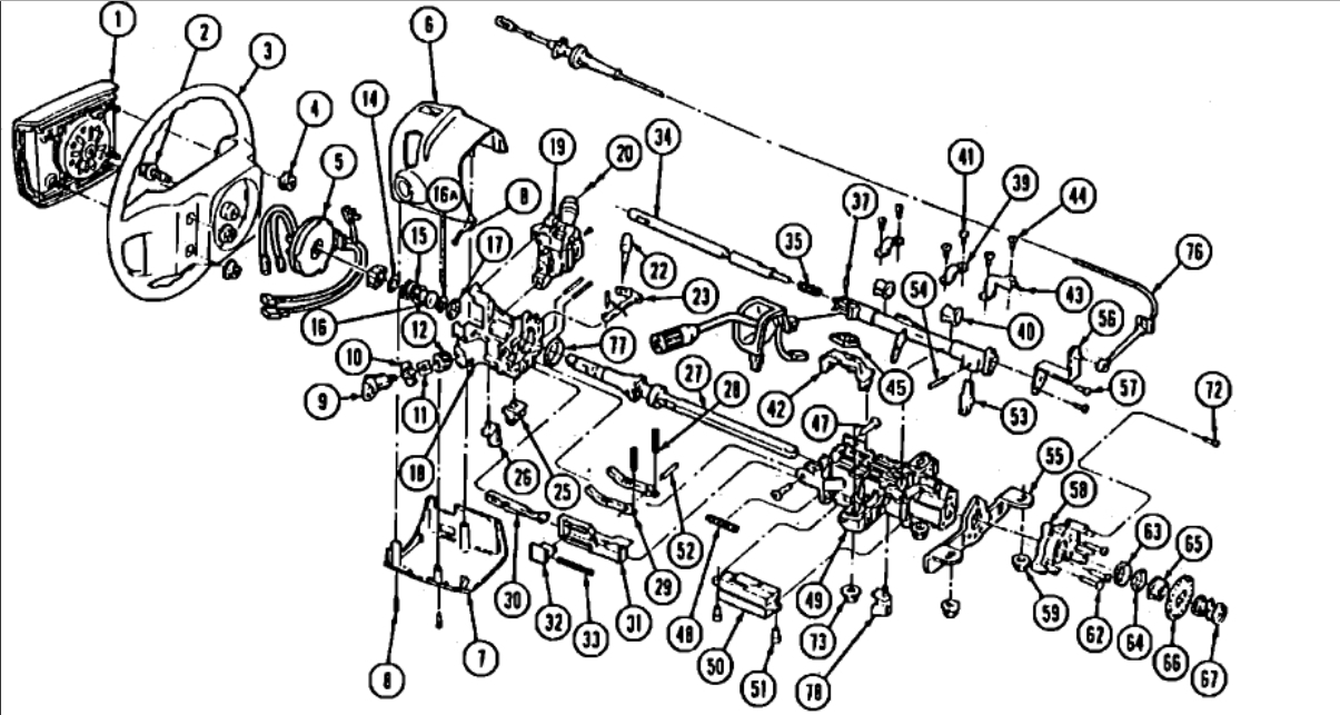

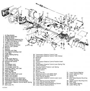

https://www.2carpros.com/forum/automotive_pictures/266999_col_2.jpg
LARGER IMAGE BELOW
