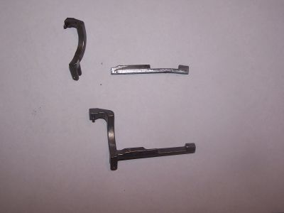

I went through this a couple of years ago. I ended up pulling the column out of the truck. If you are going to work on the tilt mechanism, I think it's a must.
Here's a picture of the broken piece and the new piece. The Parts Guy at the Ford dealer knew just what it was when I put the broken piece on the counter. Didn't ask "What year? What Model?" just went back and got it. Must be common.

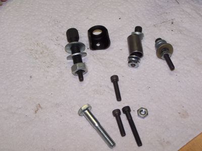

Here's a photo of the gizmo I bought at NAPA if I remember right. They knew just what I needed. All extra screws and the spacer are additional items you will need. I must have blocked out this ordeal because I can't remember what I used them for. I DO remember you will need some C Clamps or something of the sort to compress and hold the spring .
