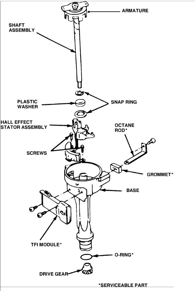

Crank up runs fine for twenty minutes or so. Then will start until quits. Both check engine light and engine light will come on. Will do while driving or just at idle. Then wait an hour or so. Can get in drive back home.
Thursday, September 10th, 2020 AT 10:42 AM (Merged)
KEN L
  • MASTER CERTIFIED MECHANIC
  • 48,363 POSTS
When it stalls do you have spark? Check this guide toward the bottom to see what I am talking about.
TIM HAROLD
Will still start and idle. Just cannot give any gas. Or stall then can crank couple more times before will not any more. If get underneath and pull fuel line off put back on it will start again. But will not go to far and do it again. I suppose spark would be issue?
KEN L
  • 48,363 POSTS
Yes is sounds ignition related. These trucks had a problem with the ignition module on the side of the distributor I would also do the pick up coil as well.
TIM HAROLD
Put coil and module did same.
KEN L
  • 48,363 POSTS
With the ignition key on does the coil have power on the positive side?
When the engine cranks over the negative side of the coil should flash.
