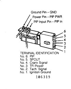

THICK FILM IGNITION IV (TFI) IGNITION SYSTEM CHECKSSPARK CHECK Using a high output spark tester, check for spark at coil wire while cranking engine. If spark is present, go to step 2). If spark is not present, remove distributor cap and crank engine to check for distributor rotation. If okay, check coil secondary wire resistance. Resistance should be no greater than 7000 ohms per foot. Place transmission in Neutral. Disconnect TFI wiring harness connector. Attach TFI Ignition Tester (105-000003). Connect Red lead of tester to 12 volts. Attach remote starter to "S" terminal of starter relay. Crank engine with remote starter while observing 2 LED lights on tester. If the PIP light blinks, go to step 4). If not, remove distributor. Remove TFI module from distributor. Using an ohmmeter, ensure all circuit resistance values are correct. See Fig. 4.
http://www.2carpros.com/forum/automotive_pictures/307270_1990_ford_F150_1.jpg
. See TFI MODULE CIRCUIT RESISTANCE SPECIFICATIONS . If readings are incorrect, replace TFI module. If readings are correct, check stator for open winding or short to ground. See SYSTEM/COMPONENT TESTS article in this section. TFI MODULE CIRCUIT RESISTANCE SPECIFICATIONSTFI Terminals (1) Ohms Ground Pin - PIP More than 500Power Pin - PIP Input Pin Less than 2000Power Pin TFI Power Less than 200Ground Pin - Ignition Ground Less than 2PIP Input Pin - PIP Less than 200(1)See Fig. 4 for terminal identification. If TACH light did not blink in step 2), replace TFI module and repeat step 1). If spark is still not present, replace ignition coil and module connector. If the TACH light did blink in step 2), substitute ignition coil with a known working unit and repeat step 1). If spark is now present, verify coil secondary wire resistance is no greater than 7000 ohms per foot and replace ignition coil. If spark was not present in step 4), connect original vehicle coil and spark tester. Remove pin-in-line connector located near distributor. Crank engine while checking for spark. If spark is present, inspect PIP and ignition ground circuits to verify continuity. See Fig. 2 and Fig. 3 . Repair as necessary.

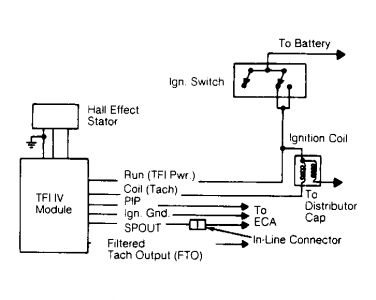

Fig. 2: TFI System Schematic (W/O Computer Controlled Dwell)
http://www.2carpros.com/forum/automotive_pictures/307270_Graphic_4.jpg

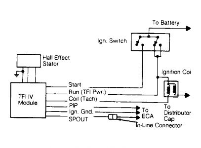

Fig. 3: TFI System Schematic (W/ Computer Controlled Dwell)
http://www.2carpros.com/forum/automotive_pictures/307270_Graphic_2_1.jpg

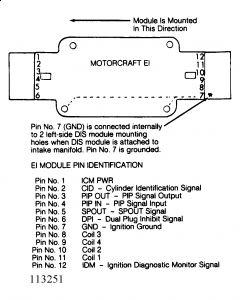

DIS IGNITION SYSTEM CHECK - NO START (2.3L)DISTRIBUTORLESS IGNITION SYSTEM (DIS) - NO START CHECK (2.3L)NOTE: The following diagnostic tests are in sequence. Begin with the first test and complete each successive test. DO NOT skip tests unless directed. TEST 1, CHECK ECA FOR FAULT CODES Repair as necessary. See TESTS W/CODES article. If no fault codes are retrieved, proceed to TEST 2.TEST 2, CHECK FOR SPARK DURING CRANK Using Neon Bulb Spark Tester (D89P6666 A), check for spark at each right side spark plug wire while cranking. If spark is present on all right side spark plug wires and consistent, (one spark per crank revolution), go to test 3). If spark is not present or consistent, go to TEST 5.TEST 3, CHECK DIS MODULE PIP OUT Install diagnostic cable. Connect diagnostic cable to breakout box. Use 2.3L overlay. Connect LED test lamp between (+) J31 (PIP EEC) and (-) J60 (BAT-). Crank engine. Does LED test lamp blink continuously during cranking? If yes, go to TEST 4. If no, replace DIS module and check for fault codes. See TESTS W/CODES article.
TEST 4, CHECK PIP OUT CONTINUITY With key off, disconnect ECA. With an ohmmeter, measure resistance between Pin No. 56 of the ECA vehicle harness connector and J31 (PIP EEC). See Fig. 5 . If resistance is less than 5 ohms, refer to the TESTS W/CODES article, PINPOINT TEST A in this section. If resistance is more than 5 ohms, service open circuit, reconnect ECA and check for fault codes. See TESTS W/CODES article.
http://www.2carpros.com/forum/automotive_pictures/307270_Graphic5_1.jpg
TEST 5, DETERMINE MISSING SPARK COMBINATIONDuring cranking, is spark missing from both cylinders No. 1 and 4, or is spark missing from both cylinders No. 3 and 2 plug wires? If spark is missing, go to TEST 7. If spark is present, go to TEST 6.TEST 6, CHECK PLUGS & WIRESCheck spark plug wires for insulation damage, looseness, shorting or other damage. Remove and check spark plugs for damage, wear, carbon deposits and proper plug gap. If spark plug wires and spark plugs are good, reinstall and go to TEST 7. If components are faulty, service or replace as required. Check for fault codes. See the appropriate TESTS W/CODES article.TEST 7, CHECK DIS MODULE VBATInstall diagnostic cable. Connect diagnostic cable to breakout box. Use the 2.3L overlay. connect LED test lamp between (-) J2 (IGN D) and (+) J5 (VBAT D). Turn key on. Is LED test light on? If yes, go to TEST 8. If not, check connectors, service or replace harness and check for fault codes. See TESTS W/CODES article.TEST 8, CHECK DIS MODULE IGNITION GROUNDWith key off, check resistance between J2 (IGND-D) and J60 (BAT-). If resistance is less than 5 ohms, go to TEST 10. If resistance is more than 5 ohms, go to TEST 9.
TEST 9, CHECK DIS MODULE MOUNTING SCREWSCheck DIS module mounting screws for corrosion or looseness. If mounting screws are clean and tight, replace DIS module and check for fault codes. See TESTS W/CODES article. If screws are not clean and tight, clean or replace screws. Clean mounting area on DIS module. Check for fault codes. See TESTS W/CODES article.TEST 10, CHECK RIGHT COIL PACK CIRCUITSWith key on, connect LED test light between (+) J18 (RC1D) and (-) 60 (BAT-). Does LED test light illuminate? Connect test lamp between (+) J10 (RC2D) and (-) J60 (BAT-). Does LED test light illuminate. If test light illuminates in both tests, go to TEST 14. If test light does not illuminate in both tests, go to TEST 11.TEST 11, RIGHT COIL PACK FAULT, ISOLATE DIS MODULE With key off, disconnect diagnostic cable connector from DIS module (Pins No. 7-12). See Fig. 6 . Repeat test procedures in TEST 10. If test light illuminates during both tests, replace the DIS module and check for fault codes. See TESTS W/CODES article. If test light does not illuminate during both tests, go to TEST 12.
